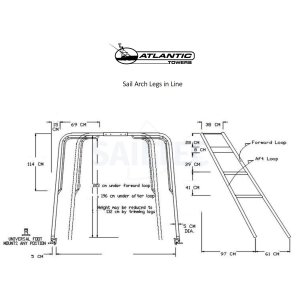

Found these plans for solar arches from some american company. Maybe just try to find a welder who wants to copy them? Just need to measure the width I need. They seem popular overseas.

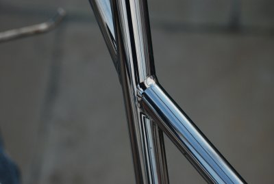

Not so if you're a decent welder, this is my stick welded (but not by me) pulpit .
I found measuring difficult. In the end, mocked it up in 3/4 x 3/4 timber held together with gaffer tape until it looked right, which made measuring, particularly bending angles, easy.
I made a mock up of both the solar arch with 50mm dia PVC water pipe heating up the pipe with a heat gun to get the bends right
Once got it looking right just measured it and fabricated the rest to the mockup.
Took tube and mockup to the tube benders and they bent the tube to the mockup
That's not arc welding. The guy would have to be magician to weld like that with a stick welder. That is TIG welding. Stainless steel is hard to weld. Arc welding works best on thick gauge milld steel. To weld stainless steel, you need a shield gas. Tig welding is normal practice for a proffesional welder where aesthetic are important. You simply cannot achieve that kind of weld on thin wall stainless steel with an arc welder.
I weld stainless steel with an stick welder its all about the correct rods , current and skill,
The wels shown looks like it has been dressed and polished. I agree you would not get that kind of finish direct from stick or even TIG.
Tig would need pickling and dressing and polishing to get that quality of finish.
I have done stick from the mid 1960's when I was an apprentice in a fabrication shop doing both MS and stainless fabrication tor conveying food stuffs.
I am a little out of practice these days but I still do stick, MIG and TIG depending on what I am construction
Mock up is an idea, but I meant I only need to measure the width, the rest seems alright? Might check on my boat if the backstay is cleared that way.
Oh yes it is, I watched him do some of it. 1.5mm electrode @ 80 amps on 22mm x 1.5mm tube.
