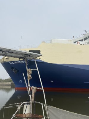

For anyone interested: I got a Camper Nicholson 30.
The idea is to make it look somewhat like this picture, that I found online:FB7240C0-03D2-4DF3-A789-B88BC07C49DE.jpg
I know this is an expensive job, as they welded and have integrated it into the pushpit, but the idea is about the same. Maybe with, maybe without the dinghy davit. Not sure. Depends on how sturdy it can be in the end.

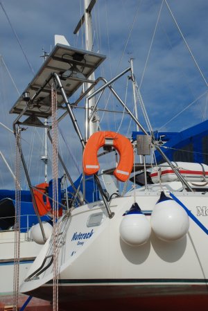

Combined Bimini and solar mount with rear targa bar as support with additional 180w panel on it that tilts fore/aft.
The Bimini forward tensioning straps have been replaced with stainless support tubes and 3x180w panels over the Bimini are attached by Ferris thumb screwed clamps.
The whole lot can be tilted to allow the mast to sit on top for trailering and with some effort the whole lot detaches and lays down into the cockpit to allow the ultimate lowest limboing under obstacles.
Usually just lowering the mast with bagged main on boom still attached gets under almost all bridges and powerlines.
Not the most elegant but very effective and my high windage modern powersailer trailerable yacht doesn’t have classic lines anyway!:)
