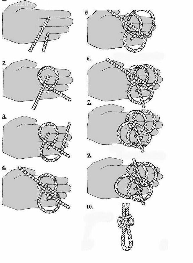

From the awfully useful wayback machine, unfortunately this webpage is no more..
https://web.archive.org/web/20160715154948/http://www.bethandevans.com/load.htm
Fig of 8 might well slip over time, that's one of the things with dyneema, it will slowly slip through most knots very slowly under load.
I still need to go back to this image tying the diamond knot, though can be done in no time after a bit of practice, then use mole grips to get the knot bedded in as much as poss.

Thanks all. That was helpful and encouraging. I'll have another go with the bits of paracord I practice with
