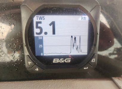

Four or five days ago. Big thunderstorm in an exposed anchorage. 15 kg Rocna, 8 mm chain, 35 ft boat, 7 tons displacement. 50 knot gusts, soon passed over.
On recovery the windlass was unable to lift the anchor, requiring me to motor over it to break it out. Possibly the deepest it has ever set. Mixed mud and sand seabed.

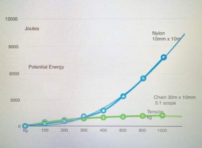

The 650kg was achieved with no snubber and the means to reduce the tension would have been to add a snubber. Very, very simple. This is the same as NormanS heavy chain - he uses heavy chain (and lots of it). We use 2 snubbers, a bridle. The heavy chain and its catenary offer NormanS a buffer to snatch loads, in the same way our nylon snubber offers a buffer. Our catamaran would sail like a dog with NormanS heavy and long chain - we can average 10 knots over 100nm - because we don't weigh our bow down.
There are many ways to skin rabbits and there are different ways to anchor.
But I will guarantee a few 10s of meters of nylon will be factorially cheaper than many 10s of metres of heavy chain - and achieve the self same end, allow better sailing performance and leave a lot of space in the bow locker. Furthermore the snatch load dampening by nylon will be achieved with shorter scope than needed with chain allowing the yacht to close the beach and shelter.
10m of 10mm nylon is vastly superior at snatch load dampening than even 30m of 10mm chain. 30m of 10mm chain has effectively no snatch load dampening at a 600kg tension at a 5:1 scope - you would need to deploy much more chain, maybe all you have to dampen 600kg of tension and move to deep water (commonly less sheltered) to have effective catenary
Now if you have sea room to allow you to deploy 100m of chain (very possible in the outer islands of western Scotland) and if your yacht is big enough to accept that same rode - great. But many here on YBW sail yachts that would also be dogs with 100m of 10mm chain and would find seeking shelter allowing a 100m rode - difficult in the south of the UK or the Med

Of course NormanS is comfortable - he has all that chain deployed, many 100s of pounds Sterling, it removes the snatch loads from his anchor - he is as safe as houses. We can do the same with factorially less chain a decent brindle and an 8kg alloy anchor.
Most people own plastic fantastics, aka AWB's 35'/45'- all the weight has been squeezed out of them by accountants - do they really want 80kg of 100m of 6mm chain or 145kg of 100m of 8mm chain? They don't need the 8mm chain - 6mm will suffice with 30m of nylon (and the nylon will offer dampening well beyond 600kg of tension.
Though it is a personal choice and maybe some like sailing like a dog and spending money on redundant chain.
It takes all sorts.
