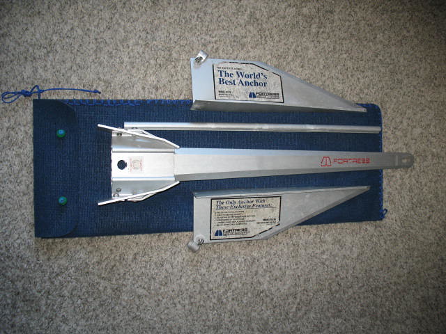

The alloy Fortress is likewise considered 'very good'; it is quite easy to deploy and recover from aft which, in a 23' boat, is helpful. I keep mine demounted and stored neatly in a bag; I can reassemble it, without tools, ready for use in <2 minutes. I purchased mine 'here' for about 1/3 retail as it was pre-owned. It still had sticky labels attached.
