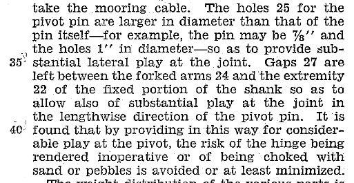

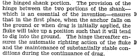

The hinge on the CQR wears and becomes loose, The looseness of the connection alters the geometry of the shank to fluke and the fluke will be unreliable in terms of setting ability. It is possible to sleeve the hinge - but its usually sensible if this amount of wear has occurred to retire the CQR and opt for something else.
Jonathan
Even when new the amount of play is considerable.
This is an extract from the US patent application for the CQR

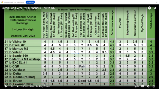

I will go further, even though it might upset your ideas about how chat sites work. It would be good to have a smaller anchor on the Fox Terrier, personally I don't like CQRs. However to expect a new design to perform better, because it is newer, is crackers.
An extract from one of the few anchor testers worth consideration.
Nobody said it was because it was newer. It's because the newer generations benefit from decades more development and actual science being used to design something that sets, resets, and holds a boat rather than something that folds neatly for on deck storage that wasn't designed with setting or holding in mind. When CQR was designed the belief was that heavier was better for both anchor and chain, and both have been proven incorrect.

Post 37 is my post, I'm guessing you mean 36
The OP has said 3 times that he is interested in other people's opinions. I have posted mine.
It implies that I don't think any extra performance is merited on that boat - unless perhaps he is particularly well heeled. I am pleased he has responded to the suggestion that he looks for a used replacement.
And your point? It clearly shows that all the anchors that are "better" than the CQR, are lighter and 3 out of the 7 considerably lighter. The only NG anchor that underperforms according to this site is the Rocna and this is the only "test" that comes to this conclusion.
The advice to the OP has been consistent about the benefits of downsizing and that in general newer designs (various brands) will be more effective for any given size.
