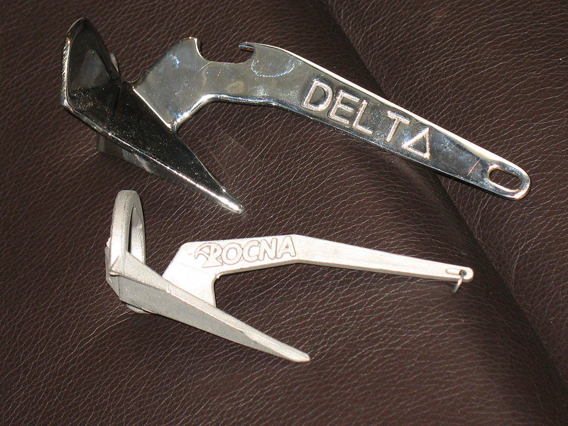

'Should I swap to a smaller/3rd gen anchor...?'
Is this what you have in mind?
There would be little problem stowing enough chain. Most bathroom suppliers could provide shiny stainless short-link stuff....
