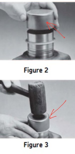

The speedi-sleeve does come with an 'installation tool' in the box. Trouble is, it is only open on one end and is not deep enough to push the sleeves on far enough.
To push them on, you will need something like a short (maybe 6inch) length of aluminium tube.

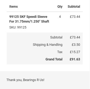

I don't have the measurements.. another forumite previously posted the shaft diameter.
Perhaps the following helps. This was my order to Bearings R Us back in 2021 for the shaft in my 120S-D leg..
I ordered enough to have two complete spares!!

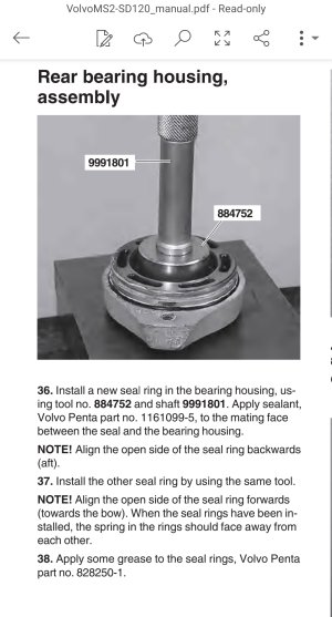

I think if you take another look at the installation tool that comes with the seal (arrowed in the instructions below) you will realise why it can't install a seal much further along the shaft..

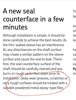

I did read about someone who had issues with the sleeve cracking/failing when installed over a very deep groove.
Hard to imagine because the sleeves feel very strong and well made.
Perhaps worth filling a deep groove with an epoxy filler before installing a sleeve over the top to be sure...
