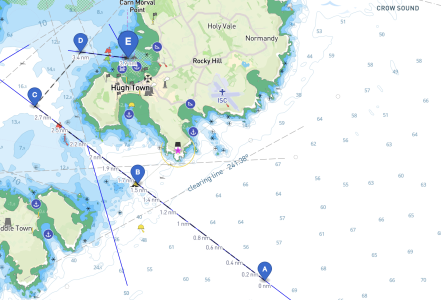

Hello sailors,
I am a novice Day Skipper who obtained my license in the summer of 2022.
Currently, my crew and I are planning a sailing trip from Falmouth to the Scilly Isles and back.
I would greatly appreciate your thoughts and feedback on our draft plan.
Any blind spots?
Any poor decisions in the plan?
Any advice or warnings?
What wind force or sea state should we use as a STOP for our strip?

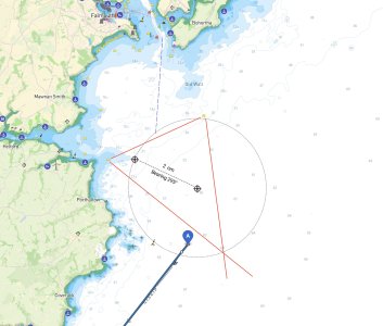

  3. Training:
    • We plan to spend approximately 1-hour practising tacking, jibing, MOB (man overboard) drills, and reefing in the vicinity of 50° 04.810' N 05° 01.246' W (hope the traffic won't be a problem, it's about 2nm NE to Manacles E cardinal)

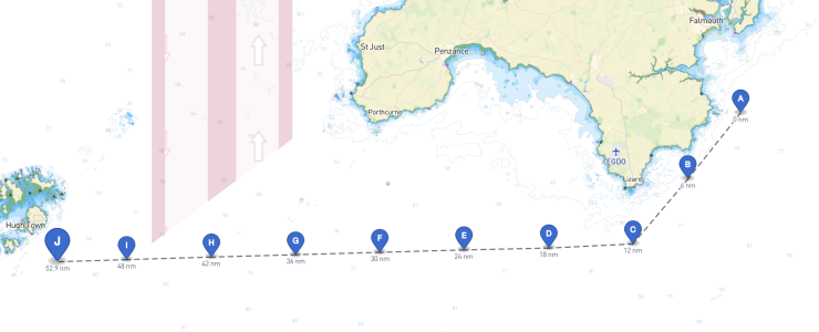

  4. Timing and Course:
    • By 8 a.m. (high water at Dover -0230), we aim to be east of Manacle BYB, taking advantage of 4 hours of favourable tides.
    • Our intended course is to stay 3 nautical miles south of Lizard Point and head in a direction of 270° towards the Scilly Isles (St. Mary's Sound entrance)
    • The journey from this point to St. Mary's Sound is approximately 66 nautical miles, which, at an average speed of 6 knots, should take around 12-13 hours.
    • Upon approaching St. Mary's Sound, we plan to enter the transit 307°, 3 nautical miles southeast of Spanish Ledge.
  5. Arrival at St. Mary's:
    • By 8 p.m., we expect to reach the entrance of St. Mary's Sound, using the recommended transits. It is approximately 4 nautical miles to St. Mary's Harbour from there.
    • We anticipate arriving at St. Mary's Harbour by 9 p.m., where we will either moor or anchor. If strong gales from the west or northwest are forecasted, we may consider using Porth Cressa instead.

  • I do have concerns that the direct passage of 66 nautical miles may be too exhausting for the crew.
    Should we consider splitting the passage and spending a night at Newlyn or Penzance? However, this would significantly reduce our time on the Scilly Isles.
    I wonder if it is overly optimistic to assume that our novice crew and the chosen boat will be able to maintain an average speed of 6 knots throughout the journey to the Scilly Isles.

Note 3: I have attached a couple of screenshots with the preliminary routes generated by Savvy Navvy.

Firstly, I commend the level of detail in your planning and the thought that has clearly gone into it. However, looking at the forecast from Meteo France, I would advise (actually strongly advise) against the trip. The forecast westerly F5 is not the sort of weather you want to spend ten or twelve hours beating to windward in the long open water trip to the Scilly Isles. You really need a forecast of a week of settled weather and no more than a F3. That's nothing to do with your experience; I've got quite of few years under my belt but I certainly wouldn't do it.
Instead, I would recommend spending a few days in one of the best cruising areas in the British Isles. You'll get some shelter from the wind out of Falmouth. Have a day exploring the Fal, and pop over to Helford for a night. If conditions allow, head off for Fowey for a night, then onto Plymouth or Newton Ferrers if you want peace and quiet. On the way back, make a big tack out to Eddystone for a look. You'll get plenty of experience on this sort of mini-cruise and not frighten the wits out of your crew!

To be fair, the tide is not too big, 17ft1 max at the end, so no big deal in open water. Boat is capable.........
but there is fun to be had east of the Lizard. Lots.

If you get there in the evening and the wind is favourable, consider anchoring in the bay off Porth Cressa.
Also put a coy of NP255 Lands End : Monty Mariner on your phone / tablet.
Why? The main bay is large, easy to navigate and has mooring buoys unless it's blowing a NW F10 I'd rather go there and pick up a mooring instead of anchoring in the dark in limited space between rocks.
