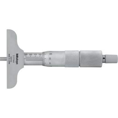

Interesting I would not use a dial indicator to do that measurement, I would use the proper tool, a depth micrometer
This one is from cromwell tools
Or if you don't know how to read a micrometer you could use a digital depth micrometer

So you agree with me that a micrometer would be better than a dial gauge in this case as I said in post #285
