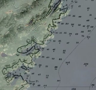

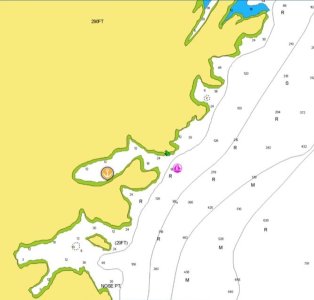

Ok, here goes... on the topic of why being able to plot positions separate from GNSS data might be beneficial.
A member of another forum has been looking for detailed charts of Newfoundland, something that would match the very detailed data that Navionics had and they couldn't find elsewhere. I have a good guess as to why, but I'll share this bit from some screenshots they shared, a satellite overlay on the raster chart layer and chart of the area from the aforementioned app. I should point out that some other 3rd party chart sources use this as well. There is not yet official large-scale chart coverage for this area, so some apps don't show this level of detail at all. (Bonus points for guessing the survey year.)
Needless to say, this is a case where if using those charts I'd much prefer to plot fixes manually, saving GNSS coordinates for a Mayday or other need. I've also run across other charts for remote areas with explicit warnings to not use GNSS data for position plotting.
Two things. Firstly that simply looks like the wrong datum is in use which is an easy fix. Secondly you don’t have to be able to draw lines to avoid hitting the land.
In this case, the chart appears to claim NAD83 (i.e. functionally equivalent to WGS84). But the survey is from an older Admiralty chart from 1897. The offsets don't appear to be a simple X,Y translation issue, but as you mentioned AI should be able to assist in correcting the charts. But, it can take years, and there's plenty of coastline on the planet with similar issues.
Yes, there are a few things you could do: grab satellite imagery, use radar, etc. But if we're talking chartwork and replacing paper, then it's reasonable to expect that your paper replacement is able to handle taking a running fix on a light ashore. And it's also reasonable that your paper replacement should have the equivalent of a source diagram so you know how much to (dis)trust it.
