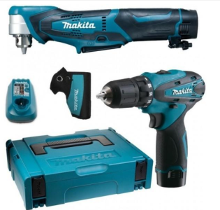

For the convenience of needing fewer battery types I decided on Makita some years ago. Now have a number of 18v tools and am happy.

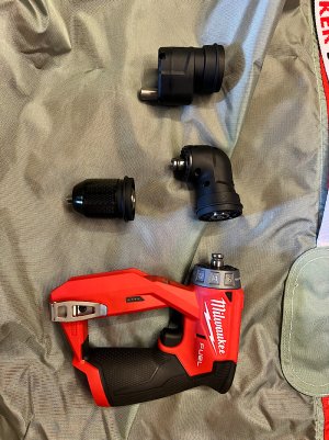

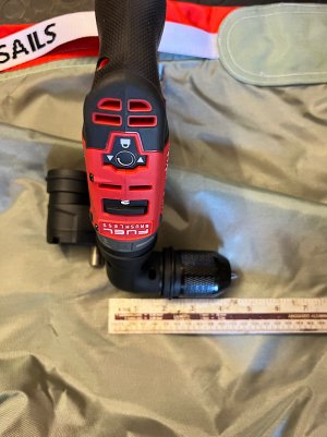

For a specific, important job on an engine that was a pig to get to, I added this 10.8v set to the collection. Light because of the smaller battery, and works well.
Also good on board, as lack of space is the norm rather than the exception.

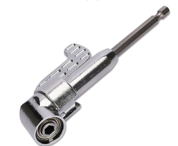

I had to drill a small hole in an awkward corner where there wasn't room for my Makita right-angle drill.
One of these drill attachments and a small chuck did the job, and didn't cost much:
I wondered about those, glad you got some use out of it.

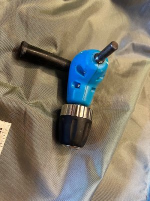

I bought a B&D right angle drive when I had to drill several holes in tight corners. Too tight to have a chuck, so adapted the drill to thread into the box. Did the trick, so worth it for that. Had come in handy a few times since then.
It had a threaded bit to mount to a B&D drill after you took off the chuck; and the same thread on the output to put the chuck on. M&F. Got a local machine shop to put a thread on the back of the drill bit. Saved a lot of hassle.
