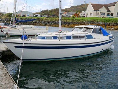

The surveyor has said both the standing & running rigging need replacing. The boat is a 28ft sloop with a split backstay & a block & tackle kicker. Has anyone got recent prices for a similar sized boat?1982-mascot-28-for-sale-0.jpg

Can't help on the rigging costs, but that's a cracking boat for real life weather up there - they've packed a lot in to 28 foot, and it manages to look handsome with a doghouse - a rare feat.

Thanks KevinV
It's very similar to the LM27, but has an aft cabin & conventional shaft drive.
