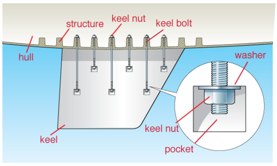

I wondered how the keel will be attached as there are no keel bolts
TS
Drill down from inside the boat then in from the side of the keel to make pockets.
john_morris_uk
3 Jul 2002
27,926
At sea somewhere.
A couple of 5 mm studs should do it?
On a more serious note, I guess he’ll be making more bronze studs assuming bronze will be strong enough? . Presumably the drawings will specify how many and where.
Traditionally another method is to flare the keel bolts at the end and insert them from beneath into holes drilled all the way through the floors, keelson and keel. This would be extremely difficult in the Tally Ho project as you’d have to raise the whole boat a long way (since presumably/obviously you can’t dig pits in the concrete floor of the shed. )
I haven't seen anything of the ballast keel since the debacle with the lead pouring straight through the thickness of it. Which emphasised that it was a long shallow billet of lead, nothing like a fin. No lateral resistance to speak of. So it could possibly be through-bolted, maybe in separate sections. Perhaps I'll get round to watching some of these recent episodes...
I couldn’t find a picture of a full keel but this was a common way of doing it in’t old days
