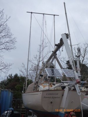

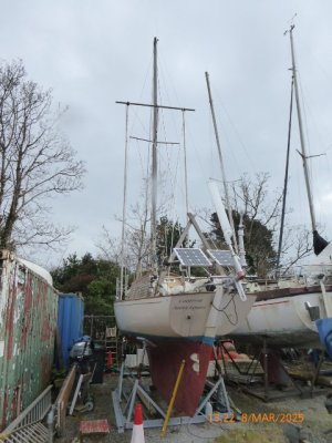

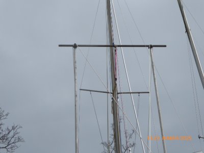

I made a crane from 2 x 22ft aluminium scaffold poles and a 10ft cross pole with scaffold clamps. The forward guys went to the deck cleats and the rear ones were crossed to provide lateral support. A small block and tackle made it easy to remove and replace my mast on my own saving £180 in commercial crane charges. The only difficulty was keeping the furler extrusion straight while gently lowering the mast.
If you were a bit nearer you could borrow the poles as I've only used them a couple of times and I'm not planning to take the mast down again for a few years.

Thanks. That looks ideal. I don't think I'd need them that long. My mast is approx 8m above deck so do you think a hoist point of 5m would work? I could get 5m poles on the car roof.
