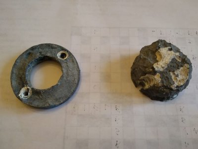

There have been a number of recent threads on this subject and I thought I might share what I have done for the coming year.
My Golden Hind had no anodes for the first 40 odd years of its life (except uselessly on the steel bilge plates!) and there was no sign of any galvanic action anywhere. Four Blakes seacocks and one DZR ball valve underwater and a fixed 3 blade propeller on a stainless shaft. I have fitted a new engine and stern gear with a Featherrstream propeller. The latter does need an anode because it is mixed bronze with stainless gears and blades. The boat is only hauled once a year and I was hoping that the anode would last a year. However after 10 months the anode was over half gone and crucially, as often happens with this style had eroded around one of the fixing screws. As that lift (end of July) was primarily to change the propeller pitch I just replaced the anode. Hauled 2 weeks ago and the first photo shows the state of the anode - unlikely to last another year.

I have a Bruntons Autoprop, which has an apparently similar anode. Mine is attached to the propeller boss by three nylon machine screws. There's not a lot of metal around the fixing holes, so to stop it getting eaten away, I put some paint on the parts of the anode closest to the holes. The anode has to be replaced annually, but at least I've never had one fall off.

Yes, I painted around the holes. Fortunately the one that stayed in place on the first one held the anode on. You can see this anode is only depleted around one hole, the other was perfect. No paint on that one.

Featherstream anode has lasted substantially longer when I started putting Velox on the prop - ie years. Well worth weighing the anode as it always looks more 'gone' than it is to me.
Although adhesion has not been perfect for the Velox coating, the Hammerite special metals primer has always been intact. 5 coats might be a bit thick, and the thickness I find counter productive. 2 modest coats enough and may well adhere better.

Five coats is for the spray, not Velox. Recommendation is for minimum 4. The problem with the anodes is the concentration of depletion around the fixing screw. The first one went completely around one screw even though it was still more than half the original weight. Decided on the shaft brushes because there is plenty of accessible shaft and it was easy to get a neat installation using the stern tube mounting bolt to anchor the bar. Also had experience in the past of a bridging strap failing.
