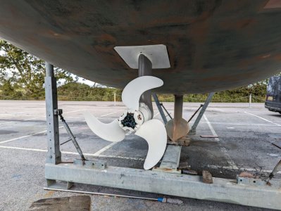

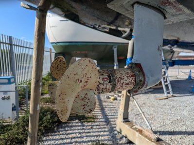

I use a paintbrush to paint the leg with Trilux, and here are some photos of our prop:

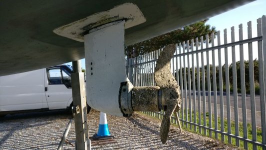

For coating the leg I have always used either Prop-o-Drev or Ecopower spray. Perhaps not as good as Trilux but usually lasted a year. The type of coating has no effect on anode wear. I had a Flexofold 2 blade which had no anode and sprayed the hub but Veloxed the blades. The hub used to get the odd barnacle.
Look like Velox is way to go for you. I also paint on Trilux on saildrive leg and prop and it works we. I do have some left I only have blue and green. Has anyone seen a decent non copper antifoul suitable for saildrive legs. I would rather not be buying 5 litres of trilux!
