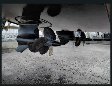

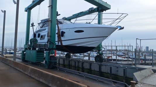

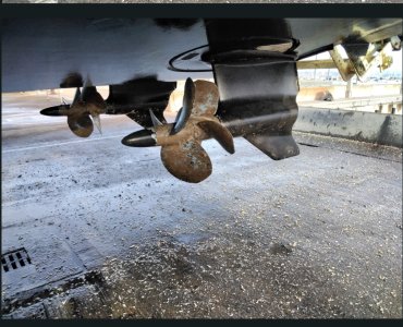

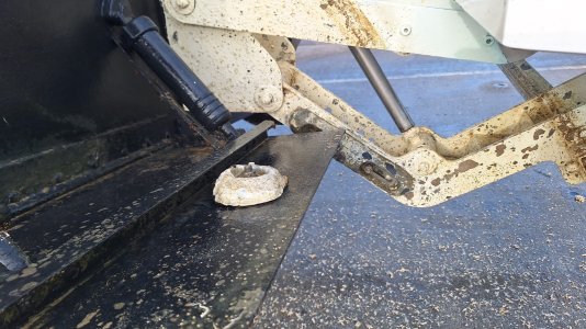

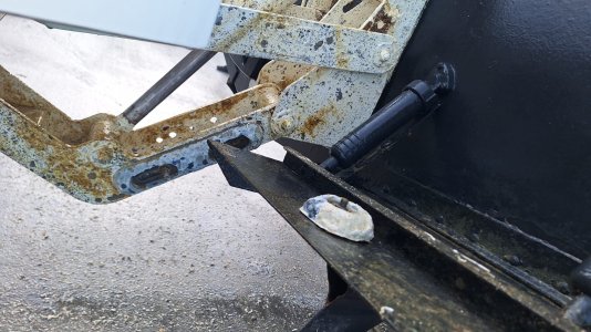

Traveled down to Heathrow, rented a car and made my way to Bournemouth to stay overnight. No dramas, stayed at the Hilton which was a nice hotel near a good selection of bars & restaurants etc. got up early and made the drive to Portland. Survey we t well with boat lifted at 1030, bang on time. Engineers found some rope wrapped round starboard drive, removed the props and some potential damage to seals, nothing can be seen but best practice would be to replace the seals, pressure test etc. hi/lo malfunction on the day so that will need to be looked at as well. Looks like the high power switch is not activating a solenoid. Teak deck need a little TLC, so we plan to get quotes for all and instruct in due course.
Everything else working great so looks like a good boat.

Also need to swap the salt water anodes to Magnesium for fresh water use. How does someone select these? Any recommendations on a good quality provider that can quote me based on the model of the boat?
