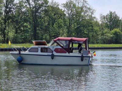

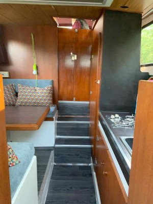

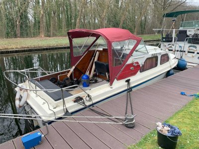

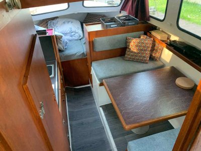

This is what we bought for €6k, a 45year old river boat, took a few months of work to get her to a point that she was usable, with a spend of around €2k including servicing the engine by the local marine engineer, she is inland waterways only with a size of 7.5m x 2.5m and 0.8m draught, with a air draught of around 2m, 1.9m internal headroom and comes in at around 2000kg, powered by a 13hp VP MD7A, she is fine for the canals with a top speed of about 11km/h and cruises at 8km/h and sucks down diesel at about 0.5l/h @8km/h, tank is 120litres so you can go for days on a tank full. We had our first cruise on her last month 80km 2 day trip to Maasmechlen overnight there with the club and a 2 day trip back to our home haven.
Not powerful enough for the open seas and a bit on the flat bottom side. Shortly she will be getting lifted and a scrape and repaint with new anodes which will cost about €2k.

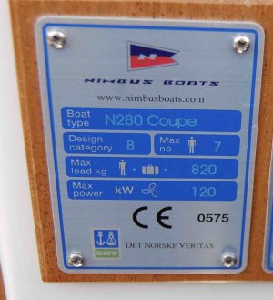

I would emphasise I have no actual experience with any of these boats crossing the channel, I am going on what brokers and people on here told me . The boat I am on now I have only driven in the river estuaries here and round from where I bought her to Dordrecht where I am having some equipment installed and stocking up.
This Aquador and the Nimbus's I looked at are all class B offshore vessels so should have no problem with the channel/Irish Sea in reasonable weather. I didn't consider the 27 as I'd set myself a limit of nothing older than 2000 but I'd imagine it is class B as well. Should have a plate like the pic attached. The older Volvo TAMD engine is supposed to be very good and I've read on here that that are a lot more "user maintainable" than the later common rail electronically controlled ones. I found this review online which seems very positive https://www.iims.org.uk/wp-content/uploads/2021/07/Nimbus-27-Familia-Coupe.pdf
There was an Aquador 28 for sale in Dublin which I nearly went to look at but was put off by the fact it has a sterndrive
