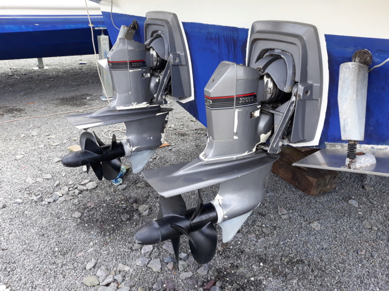

I did my own leg oil change this last time . To be honest it didn't save a fortune but I have become a bit more hands on and quite enjoyed it.. Also do my own engine service and saved money sourcing parts and oil at non marine prices .
Luckily the fishing line taken in by the props had not penetrated the seal.
The oil in one leg was slightly creamy so I flushed it out well with some gear oil.
A pressure test (with the leg empty of oil) showed no issue . With the correct equipment a pressure test is easy . Pump it up then go do something else and check after 20 minutes .
15year old outdrives - may need to be painted next time .
