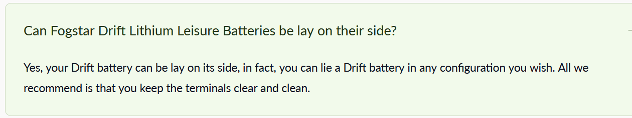

dumb question maybe...
I thought I read that, in general, LiFe batteries can be installed in any orientation one likes -but many of the battery websites don't actually say that.
Is it usually the case?
Seems to depend on the battery, but most cells should never be upside down. Trouble is that apparently some batteries are built with their cells already on their sides so unless you know which way round, there’s ab50% chance if you turn the battery box on its side you will be turning the cells upside down. So need to check with manufacturers direct.
My understanding is that best practise is to have the cells upright. It's to do with vent locations and strain on the terminals, I think.
I was looking at a sideways installation but decided against it.
I checked my manuals to confirm my understanding. Winston say to not store lying or upside down (Chinglish). CALB say to only install vertically. So if these two are representative of the rest then you can only have them in a vertical position.
The cells have vents, which I expect are designed to vent gas, perhaps in a situation of failure or severe overcharging and clearly they won't work if anything, liquid or solid drops onto it from being stored other than vertically. I'm guessing that's the reason.
That said, I have quite a number of LFP torch batteries, which are always kept on their side. Cylindrical vs prismatic cells and of course a different construction and without vents. Ask the cell manufacturer to be sure.

rogerthebodger
3 Nov 2001
12,603
My question would be can a Lithium battery be fitted on their side to keep the Hight a low as possible with the terminals on one side
Like up under the deck head on each side on a shelf next to the inner edge of the boat side
lustyd
27 Jul 2010
11,350
Yes as long as it's properly secured
