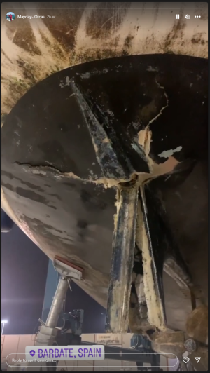

Just to further support this point ...
This is Mustique ... a "Moody 66 Performance "Blue Water" Cruising Yacht." according to the charter sites. ... details of a Moody 66 ...
PRINCIPAL DIMENSIONS
Length overall (Including pulpit) 20.043m (65’9”)
Length waterline 16.55m (54’3”)
Beam 5.33m (17’6”)
Shoal keel 1.98m (6’6”)
Displacement (light) 28.8 Tonnes (63,360lb)
Displacement (full tanks) 31.40 Tonnes (69,080lb)
BALLAST
Shoal 10.65 Tonnes (23,430 lbs)
(I don't know if Mustique was the shoal keel variant, but the dimensions and overall weights are not far off)
MUSTIQUE Yacht Charter Price - VT Shipbuilding Luxury Yacht Charter
... and this is the story on Instagram by April Boyes @april_ ...
“What started off as a seemingly unique encounter ended with orcas breaking our rudder off the boat, then proceeding to tear off bits of the boat for over an hour,” recounted April Boyes, one of the Mustique's crew members.
A huge hole in the hull meant we had water ingress to other parts of the boat and the engine room. I can honestly say it was a scary experience.
A rapid-response vessel and a helicopter, equipped with a bilge pump, were sent to assist the 20-metre vessel.
The video log of the attack is here, unfortunately, you need an Instagram login to watch.
Watch until the end to see what was done to the hull and skeg after the rudder was ripped off .... this is not an insubstantial boat but the crew were hanging onto the shrouds and losing their balance as the orcas removed the rudder and ripped the skeg apart. IMO ... a longer skeg would just give them more leverage on the hull.
Login • Instagram
This is the YouTube video shared by the Daily Telegraph but it doesn't include footage of the boat on the hard.
.. IMO this puts the belief that skegs make a difference to bed ... they don't, it's just pot luck at the end of the day as to how much effort the orcas are prepared to put into destroying a rudder.
