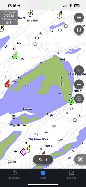

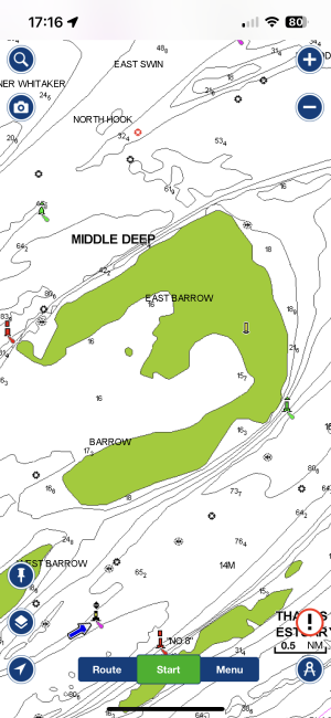

I kicked a bit of sand up a couple of weeks ago when cutting the south east corner of the barrow. It was dead calm and we were fishing in the shallow water so it wasn’t a surprise. Totally different shape on the two charts.

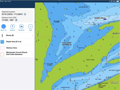

This is what my (up to date as of 27 Sep ‘23) Navionics shows for the contours around the Buxey Beacon. It does have the Ray Sand N and Ray Sand buoys way too far east [edit - oops, I mean west!!!).

Ha! Well I spoke too soon. Just downloaded another 1 Gb of updates and now the beacon is on that finger of sand as shown on TG’s screenshot.
You can choose whether or not to show Community Edits (user-added markers), when shown they are distinguished by a white cross on a green circle. Obviously one would be mad to treat any user-added markers as gospel in a safety related situation. The same goes for SonarChart contours for which data is collected from people’s boats, but I do find the latter correlates quite well in many of our favourite out-of-the-way anchorages. There’s no way Navionics could be expected to verify every piece of user added data, and it’s up to us whether we view it or take any notice of it.
