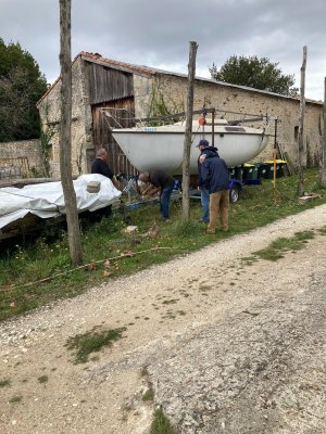

Here's one I did before.
Boat had been sitting for several years. I was asked to move it, as the land had been sold. Four akros, cross beams, ratchet straps (5 tonne) and four winches. Boat about a ton. Quite simple and most of the people were just looking. Same kit heaved it off back here, where it is nearly sorted.
Off tomorrow to with the same kit to lift a friend's new boat up, to fit the centre plate and put it on the trailer. It is not that tricky if you plan ahead.
Cost: Apart from the effort, several akros that I already had , same with cross beams. Had to buy an extra winch, the others been in use for years.
Rather interestingly, there is (was) a very nice boat in the shed. Bit like a Cornish Crabber, but 30 odd feet. GRP hull, but rest wood. It has been there for a while..not much progress when I was last there.
Oh, on the three or four blokes to lift an engine and get it in place. It doesn't work like that. Constraints with space and movement will always put the load on one or two, So you can't say a 150kg engine can be split four ways at 38kg.
