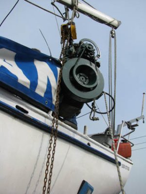

vyv_cox
16 May 2001
25,979
France, sailing Aegean Sea.
coxeng.co.uk
As John has done an engine lift 4 times he would be considered a trained and competent operator
If someone has no previous experience you may be correct in recommending employing someone else
The thing about experience is that you only acquire it by doing it. There is an interim step, which is to get a competent friend or relative to give you a hand,
When we did this job Owen had never done it before. I had lifted an engine into the saloon but never aboard a boat. But I have lifted dozens of car engines in and out using a chain block. Using common sense and similar experience we got this very heavy engine aboard and installed with no trouble at all. There are two halyards tied at the lifting point on the boom and the engine is adequately attached to the hoist by stout rope.
