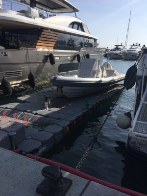

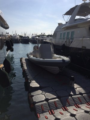

The pole is intended to tow toys, and it works well for that. When towing say 4 people on a big inflatable sofa, we have used the transom U bolts, but for "lightweight" toys we use the pole. It also carries antennae (but not the main VHF which is a taller whip areal on the hard top) and the ensign. It's also a great handle when you have come up the swim ladder and are stepping into the boat.
Fuel tank is aluminium welded. It's sitting on the floor at the back of the picture below. Nicely baffled, as you can see.
Yes that Azi is a ncie machine. It's renting my space for a while, till the Sanlorenzo arrives. It came round from the Venice boat show earlier in the year. Magellano 25m. Very nice machine, except Azimut went totally off the rails imho with the terrible design of the raised pilothouse in this boat and their new Grande 26m.
Two ribs capsized in Cornwall this summer towing inflatables from the ski pole and not the bolts on the transom. In essence the inflatables buried themselves in the water as the ribs slowed and then sped up while turning at same time. This turned the inflatables into a massive anchor. Both ribs flipped. Yours is probably too big but I only ever use the pole for skiers or wakeboarders.
