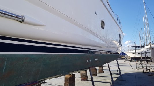

We had our waterline repainted this year - using Awlgrip but I don't know which one - used a local contractor who has lots of experience with Awlgrip so apart from choosing the colour, we left it to him.
There was loads of prep - stripped the old one right back to gelcoat.
I'm please with the end result
Better than new - In th factory, Princess used ordinary paint.
That's easier said than done. Did you see how they skinned this particular cat, exactly?
I'd be also curious to see a pic of how the gelcoat under the stripped paint looked like, if you've got any.
Outstanding final result, anyhow! (y)

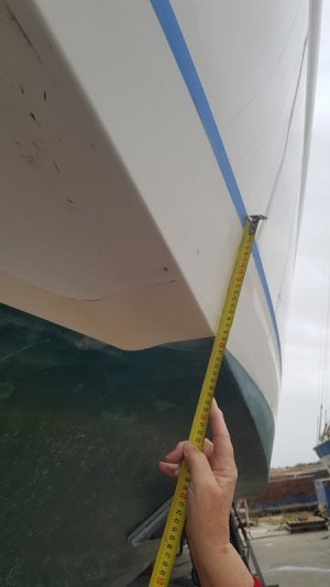

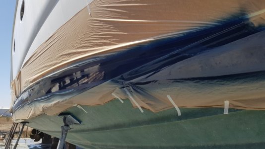

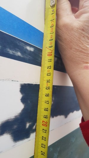

We actually started the job a year earlier but we didn't get the time/weather right to complete the job.
We stripped most of it a year earlier - I have some pics from then.
All done the hard way by hand using sandpaper (not too coarse)
This shows the process
The reason for the tape measure - I did think of using a tape but I decided in the end to paint it.
So last season we didn't have a line at all - looked a bit weird.
All good now though
