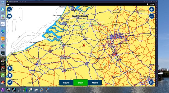

On the Garmin I use Navionics charts. Before I got the Garmin I used my Android tablet to run the Boating App which is Navionics.
On the PC I use Bluestacks which is an Android emulator, and it runs the Boating App allowing you to log into your Navionics account and then plan your routes uploading them to the cloud. I can then get those routes on either my Garmin which uses the same account as the Android tablet and also on to the tablet when syncing my account.
On the tablet when you update your charts it also downloads any waypoints, routes and tracks you have put onto the cloud either from the PC or when you sync with the Garmin Active Captain.
There is a Hummingbird sounder on the boat which works intermittently, the plotters are Simrad with C-Map and sounder, and a Garmin with Navionics.
For the inland waterways I use the Waterkarten App which is easier to use to find details about what is on the waterways, and the lock gate VHF/telephone numbers etc. the app also covers UK inland waters but it does not do coastal waters.
Boating App running on PC via BlueStacks

Bluestacks is just a program on the computer that pretends to be a phone. You download and install it, run it and then you have the same apps as on your phone.
