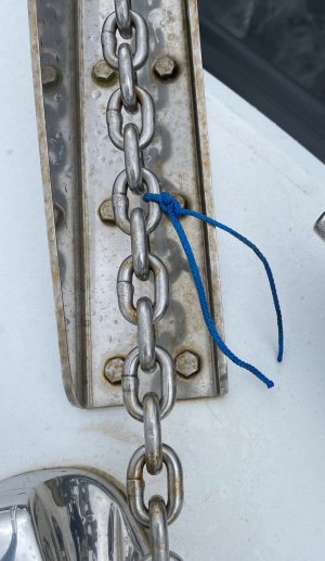

I use short lengths of blue polyester codline, knotted through a chain link. One long tail is 10 m, one short is 5m. So, for example 3 longs and a short is 35 m. Of course you can economise on the knots by using a longer piece and after knotting use both tails, cutting to length as appropriate..
The line is soft enough to go round the gypsy and short enough not to tangle.
