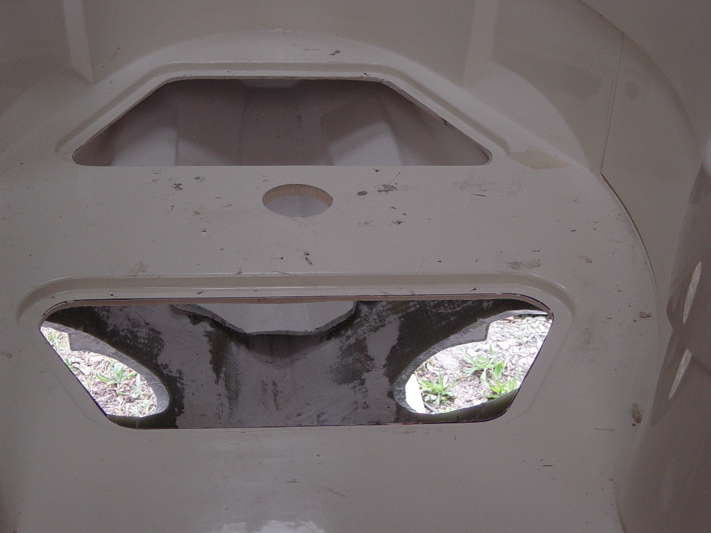

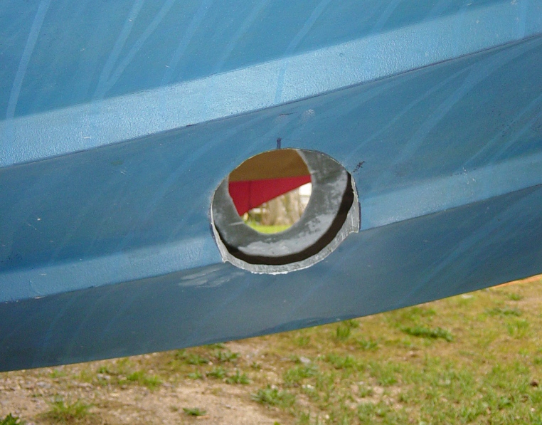

The yard has just started to install a bow thruster for me. Its a bit of a shock to go to the boat and find the holes cut ready for the tube.
from the inside you get a better idea of the elliptical shape that has to be cut to create the right shape for the circular tube.

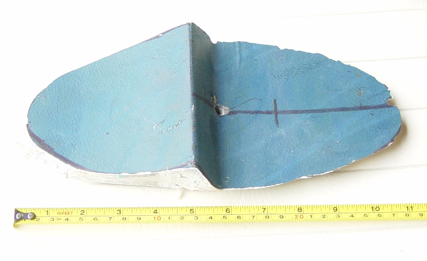

A close up of the cut out shows the shape that was cut and also the thickness of the lay-up which is reassuring. I was surprised how heavy the piece was.

[ QUOTE ]
[/ QUOTE ]I'd rather be worried about the parts they completely removed inside...
Was that evaluated in advance?
Good for you, if they know what they're doing.
Actually I didn't understand exactly what that "skin section" is, but its thickness wouldn't make sense unless it has some structural function - hence my point. SC29... is her really so difficult to maneuver with no thruster, or do you use her in particularly tricky conditions?

The local yard doing the work is the one featured in PBO last summer retro-fitting a thruster and they have been talking with Sealine about the details of the fit. If I can get some more photos during the fit as it progresses I'll put them up.
