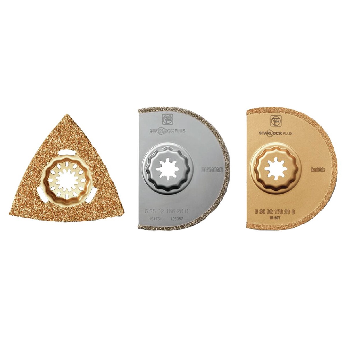

You can get abrasive, and diamond cutting based for multitools that look like they will ut stainless steel.
