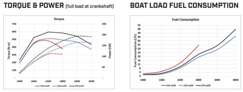

These graphs are from the Mercruiser brochure - sorry for the blurred image.
Fuel consumption is related directly to how many horses you call to work. If you demand them all to pull, you need to feed them all.
As you understand, the easiest (and free) way to increase speed is to remove (dead) weight.
If the GW allows and all 270 horses are alive and ready to work, hitting the top speed at 4200 rpm will happen when the combined gear ratio is right.

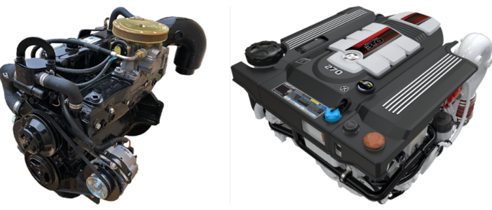

Different by appearance also:

If the OP had posted a picture of his engine, I don't think anyone would have been confused. I think the OP has just been looking at performance data for his boat with random engine combinations, rather than the actual engine itself - hence the confusion.
