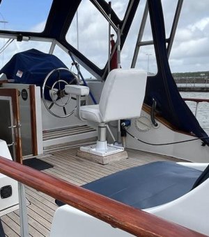

Primor 24 ... the cockpit is large like most MoBo's and of course I have significant external vertical coaming ..... the question being - Do I mount it external or do I mount inside cockpit where I see it ? The question is affected by the cockpit 'sole' .... fwd of the engine bay - the sole is actually the deckhead of the aft part of cabin ... so any cable run should be aft of that to prevent water ingress and easy connection to gear.
I have a twin charger unit (Mastervolt or Victron - yes I have choice) I will fit as well as mains cable + sockets for cabin / cockpit.
My thoughts are to mount the blue unit in the cockpit just behind helm seat ...
I'd rather have it ahead under the throttle - but its getting the cable fed through from there ... have to have another look ...

I think your logic is sound, but if you went external to avoid wires in the cockpit could you place it aft of the helm so that you still can't avoid seeing it as you climb into the seat? I suspect this isn't actually an improvement, but you know your boat and it might spark an alternative idea or two.
How about putting on a short flying lead so you can fetch the wire in where it is best and still have the unit where you want it? You could leave it lying on the seat so yo know, when you leave.
Maybe outboard on the upper quarter or inboard at the end of the brown (wood?) strip.

Problem with the console area - is that its a box screwed to the cockpit and very hard to get any cables / leads along inside the coaming back to engine bay etc.
Sorted .... it may not meet the 'concourse' specs but having already in the past departed a berth whilst still connected - I do not want to do it again !!
Sitting at helm ... I thought OK .. where so I don't miss it ... helm seat is a bit close to coaming - so that's not good ... I unmounted the throttle unit to see if I could get wire down through the limited hole .. no.
Then realised - there's a big gap behind the wheel and bottom of console has been cut away by previous owner for some access ... I already have a mouse line fed through from there to rear compartment ready for log / depth cables .. its going to be tight fit for all three ... but it suits me for now ...

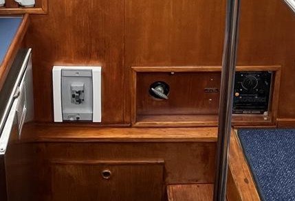

Our mains input is on the starboard side of the cockpit beside the helm seat, when not in use it has a 1/4 turn waterproof cap covering it
Mains switching is beside the house Engine batteries isolator just at the bottom of the companionway into the saloon (house battery isolator is on the other side of the saloon)

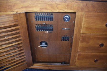

Breakers
I have no panel on this boat - the switches (pull toggles) are just plain wired. I have a fused switch gang panel I would like to fit instead but it means major surgery to the console.
Mains power is really only for battery charging (and a couple of sockets which in reality will rarely be used).
