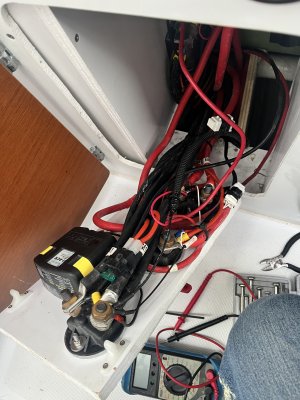

Here's a pic illustrating why it concerns me, there's no fuse before this lot and it would be catastrophic if they shorted out. (I guess this is quite common on boats though?)

Ah, I hadn’t considered the (not yet fitted but planned) emergency connect. So yes that makes sense to go bigger on the domestic as well.
And had forgotten the windlass runs from it (bow thruster had its own battery).
And I’m asking about the main battery fuses. I have a fuse box with blade fuses that most things are connected to with the odd wire straight off the isolators, which I’ve made sure are now all fused.
And can I use those normal cube fuses or should I go for MRBFs? That would require some new 8mm lugs and a hydraulic crimper.
Batteries in front of lazarette, fuel tank boxed in at the back of the laz.
And I’m asking about the main battery fuses. I have a fuse box with blade fuses that most things are connected to with the odd wore straight off the isolators, which I’ve made sure are now all fused.
Why do you have "Odd" wires coming off the isolators:unsure: Fused or not it is bad working practice, all the stuff like that should be in a fuse box/Panel and properly ID'd.
Some may say it doesn't matter but we all have differing standards:p

I’m just guessing but the boat was built without them and also without an engine. Dealer(?) fits the engine and for ease connects the ECU / Control wires to the back of the isolators with inline fuses.
Previous owner adds another toy and because the proper fuse box is awkward to get to decides to also add them to the back of the isolators.
I have a plan to really tidy it up but that’s not a job for this winter. I think I’ve added fuses to everything now (apart from batts & VSR) so apart from being untidy isn’t unsafe.

You need ignition protected fuses MRBF stands for Marine Rated Battery Fuse, of which there are more than one type, for instance : Battery Terminal (Cube) Fuses | 12 Volt Planet

Actually a lot of outboard engine installation guides will suggest/insist you connect the engine directly to the battery, bypassing even a battery isolator switch. So the dealer hasn’t done anything wrong and it was possibly even required for the warranty sign off.
The manufacturers certainly advise against fitting any sort of fuse in the wire.
The argument is that with modern electronically controlled engines losing power suddenly could cause bad things to happen.
In my opinion it’s complete bollocks and I added both isolators and fuses to my old Verado 250 engine. However, you will get lots of diehards waffling on about “clean power” for the ECU or similar. Here’s the first example I found on a Google search: https://www.thehulltruth.com/boating-forum/844279-verado-dts-harness-setup.html
