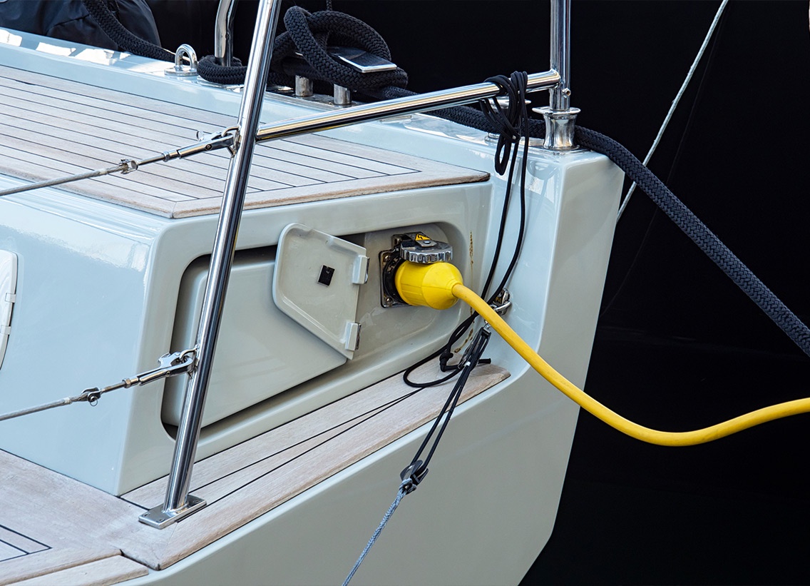

Most boats have a plug and socket shorepower like this:
I would regard it as rather unsafe to be without one.
That's a Marinco plug/socket, the very worst shore power connection there is.
Shore Power cord burnt first time I used heat
I apologise for grabbing the first picture of a plug and socket that I found, and for my failure to examine it closely. I am well aware of what you write here and assumed that everybody knew to use the international standard blue (IEC?) plugs and sockets.
They'd be better than the Marinco style ones, although there are even better ones available, i like the Ratio ones Energy Solutions | Ratio Stainless steel shore power inlet. 2P+E. 240v 16A
Very similar to the blue style ones, but IP56 rated.
