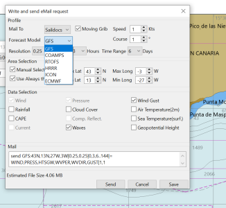

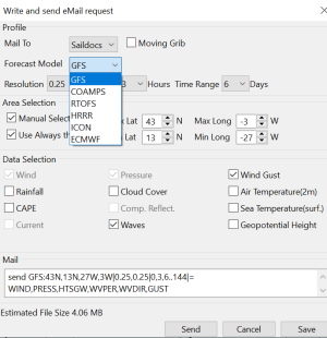

Re Opencpn, these are the options it gives, all it does is create email text. If there's an email program installed then it will create a new email with that text then you click to send it. There is an option for zygrib instead of saildocs but it says "zygribs has momentarily stopped that service. "
The moving grib can be useful offshore, give it a course & speed and it will change the lat & longs to keep the same size but slightly different position.

Thank you for the info on OpenCPN. Their message request seems a direct copy of a Saildocs request. XyGrib is no more 9r, at least, pickled. XyGrib is a fork of zjBrib and greatly expanded.

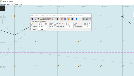

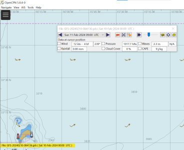

And this is interesting..
With a grib downloaded from xygrib or opencpn/saildocs, the data points are every 1/4 degree, sort of as you would expect?
But load a grib downloaded on pocketgrib on the mobile phone and looks like data points are every 0.5Deg & seem to be placed offset from the lat/long lines..
Would any of us actually notice if it's offset by a load of miles though. Most here would just look up and see that obviously "told you mine was best" 🤣

I do not know how you make that assumption about PG. One of my complaints about GRIB software is that they interpolate between grid points. XyGrib is the only one that I know which has the facility of displaying data ONLY at output grid points. Few people seem to appreciate that all models filter out or smooth small detail and effective resolution is 5 x the computational grid. That is the main reason that models invariably underpredict the strongest winds and do not show the holes that we fall into.
Not really an assumption, that's what both opencpn and xygrib display with a file created by PG. The opencpn grib plugin seems to just display the datapoints when set to "spacing - minimum". Matches the same grib in xygrib if it has numerical data interpolation turned off.
And very much agree with the rest, these days just look at the datapoints to drum it home that the actual resolution of the data is not the pretty colours some software has added. 👍
