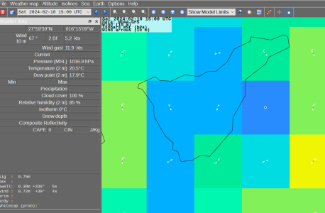

Pocketgrib on android to get a grib at some free wifi, then transfer across to xygrib/opencpn to view on laptop/RaspberryPi.
Path to file is /Android/data/com.nickobrennan/pocketgrib/files
& these days set xygrib to just show data points as that is all that is calculated. All the rest is just colouring in. But can be tempting to believe it...

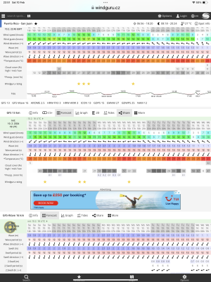

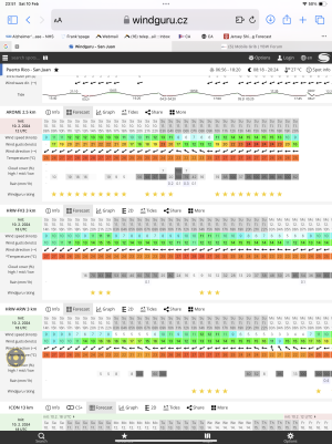

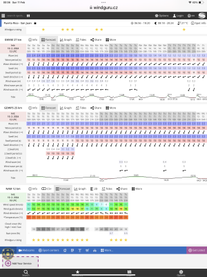

When someone says that they use Windy, Ventusky, Windguru, Predictwund, LuckjGrib and find them accurate, I have questions. First, which model? Each of these facilities has several models. Secondly, how do they define accuracy and how do they measure it?
Also remember that all forecast models have to smooth out their output during the forecast calculations. Smoothing is about 5 grid lengths. The ECMWF effective resolution is about 50 km. for most other global models it is about 65 km/ for ICON-EU, it is about 3 km. For detailed models such asAROME, it is about q0 I’m but detail of that size have very short lifetimes of a few hours. It is meaningless to interpolate GRIB output to a point. Equally, it is not very meaningful to verify a 50 or 60 km smoothed value against a value at a point.
I do not know why you say you are not using GRIB files. Windguru is simply extracting values from GRIB files. That is fine if you are staying put, not useful for a Channel crossing or sailing along the coast.
