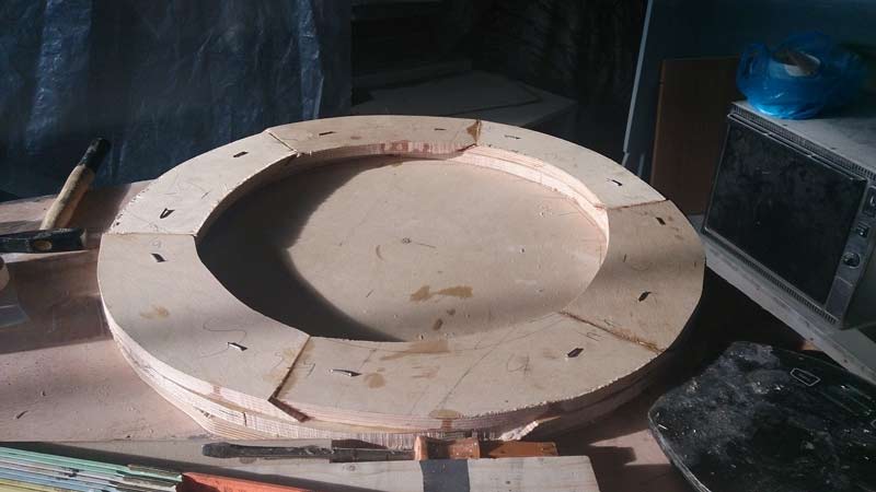

Used various offcuts and managed (with only one clean full piece of ply) to create a 3X15mm high "ring" for it.
Will be routed to shape tomorrow morning curved underneath to fit the deck curvature and fitted on Wed probably after the "heavy" jobs are complete up front.

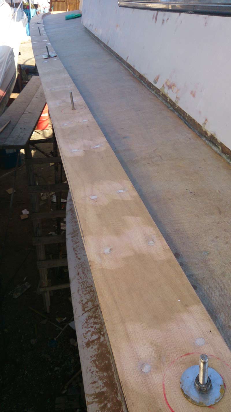

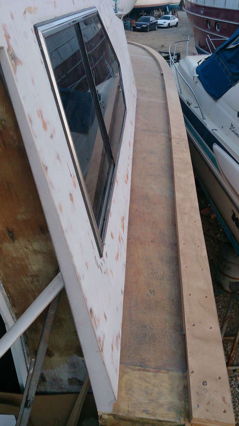

Progress in toe-rail:
stbrd side in place, all holes filled, sanded.
Both sides CPESed and ready for some mat and epoxy to protect the endgrain on the deck side. The outside will be fully covered with the iroko strip.
Decided on the capping. Due to the curvature and to reduce material loss, we are going for short(er) pieces so that there's a joint under each stanchion support cone. Means we can epoxy them in place without any screws (just do a few thick 300X200 pieces and drill a hole in the middle) and tighten them over the iroko using them as clamps ;)
Took us 2h today to select right (in terms of grain, size, curvature, colour) pieces of iroko for all the capping and side strips. Good fun going around the merchant's depot with our 3mm carton mocks trying to fit them on the slabs we've choosen... That was 350euro worth of fun :(
George is starting tomorrow the cutting (all pieces are 52-54mm thick) so will do two pieces of hopefully 189-19mm thick, clean, sanded and fitted. By next Wed he should have all of them ready test fitted and we can start gluing them. He'll have them prepared and sanding to 180grit ready for minor corrections and oiling once in place.

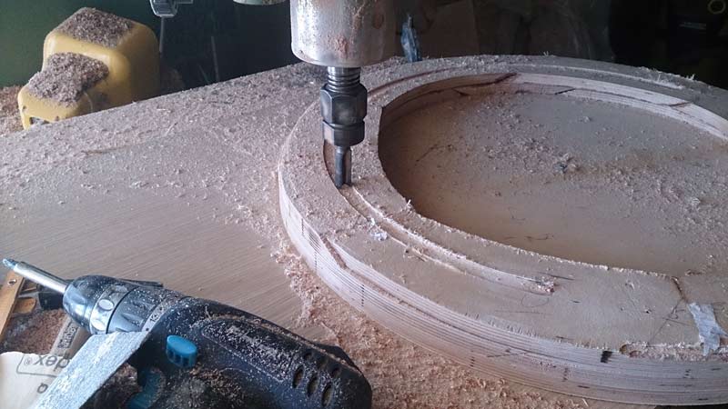

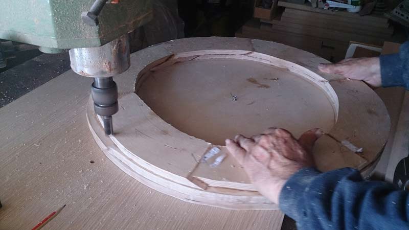

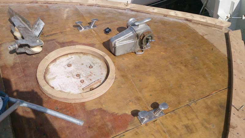

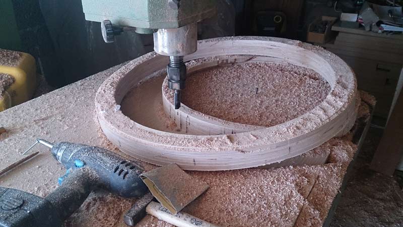

The round "ring" for the bow portlight was done. Were missing a 30deg routing bit to put a bit of a slope on the top, but wont bother with that and do a much shallower slope to match the actual ss frame one alone in situ.
and lifting it off the central part still clamped on the rooter bench:

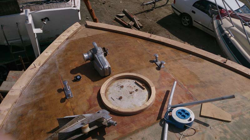

Also brought the rebuilt windlass back to the boat for testing fitting position and checking screwing in place. Did remove the motor though to make the whole procedure feasible (easier on the back as the motor itself is probably half the weight of the thing!). Once in place and bolted on, I'll bring the motor along and fit it (it's only three screws...). Mind if you're tempted to remove the motor be warned that all oil from the box will come out to your deck!
Following pics show how the bow area will look like. Looking at the pics today I realized that windlass is on the wrong place (on the bow stern axis) and should move towards the bow by approx. 200mm. Same with the cleats. Still enough space to have a 20kg anchor (current is 15kg on 8mm chain) May get another anchor but not willing to go up to 10mm chain as the gypsy alone is 300odd euro and 70m of that will add a serious amount of weight up there plus the anchor locker is not huge and I doubt it will fit properly. Will do tests with my 8mm chain (untangled and with windlass working properly) and see if I could fit 10mm chain of a decent length in there.
Fairleads missing from the pics as I need to buy them. Have some horrible ones that will be promptly scrapped.
Still enough space for a couple of director type chairs for relaxing in the afternoon on anchor ;)

Looking great VAS.
I am just wondering, looking at the photos of the bow layout, whether you should place the cleats parallel to the toe rails rather than the centre line of the boat? Perhaps this would be more in line with the pulling forces on the cleat this way?
RIN
2 Mar 2003
3,236
West Midlands
Looking great VAS.
I would imagine the best thing to do is to have the cleats pointing to wherever the fairleads are going to be as the warps will go through those. Vas are you fitting fairleads?

looking seriously good - your interior work is excellent. I think you might be better putting the cleats much closer to the toe rail (or possibly mount them on it) as where they are now you will end up tripping over them
MapisM
11 Mar 2002
20,432
+1 This will also result in less chafing.
While chafing is a good point, it's rather a matter of using a proper fairlead, rather than placing the cleats on the toe rail.
I suppose some of the previous comments were from folks who are not used to handle heavy bow lines in stern-to mooring, because imho the placement of those cleats in the previous pic is just perfect.
Placing the cleats much nearer to (or, heaven forbid, ON) the toe rail is MUCH less convenient, for bow lines handling.
The only suggestion I would give to Vas, if there's any flexibility in the fairleads location, is to put them exactly aligned in front of the cleats.
And if not feasible for any reason, I'd rather put them even more distant from the centreline, rather than the other way round.
Placing the bow fairleads near the boat centreline is in fact a very common mistake (but still a mistake!) made by many yards.
This way, on one hand they can interfere with the anchor (depending on the bow lines angle), and otoh there is less flexibility in placing the boat a bit more to port or to stbd, as appropriate, depending on the specific conditions of the berth.
All that aside, amazing job as usual Vas, congrats & respect! :)

I agree all that 100% MapisM, in the context of most Med mooring. However, remember that sometimes with a 13m boat (as opposed to your sized boat) get a berth with only one ground line not two. Also you might get offered big dirty heavy groundlines and you might choose, say for a daytime stop only, just to use one. In these cases you want the fairlead on the centreline, if possible. I have a c/line fairlead as well as thre 2 main side fairleads, and I find it useful occasionally
One way to do this is to have a "hook" fairlead welded on the side cheek of the anchor roller assembly, as Pershing do on their 60 foot ish boats. See here and click to zoom http://www.debutesq.com/images/Yachts/Pershing 62/Pershing 62 at speed.jpg
(By the way, I'm not praising the Pershing foredeck gear generally; I'm merely illustrating how you can make a centreline fairlead in this way)

intersting ideas and points risen re cleats/fairleads placement, thank you all!
Yes, there will be fairleads, for sure bolted on the toerail. HOWEVER, not being a grp hull, there are a few important things to keep in mind.
Main one is that as the bow becomes pointy and the hull meets the bow at approx 45deg, note the different profile of MiToS bow compared to typical grp hulls. Grp tops are typically sloping smoothly outwards, before meeting the bottom part of the construction (i.e. the hull itself) giving them space to do the mating and bonding. MiToS goes all the way up and meets the topsides. They both meet on a substantial peripheral piece of timber shaped to fit. That's an approx 60X80 (before trimming to shape).
So what I'm getting at is that there's no fkcing way I can get thru bolts from the cleats or the fairleads I'd like to use in order to use a metal plate underneath and M12-M14 bolts and nuts. I can only get woodscrews from the top, hence typical fairleads without rollers will do.
Cleats, even if I wanted to (that I dont want for the reasons MM and JFM pointed) will be a massive pain and a compromise in strength (imho)
Just to help size things a bit, windlass is 400mm long, cleats are 260mm and round hatch support outside dia is 610mm. Again looking from a structural point of view, bow deck comprises of three pieces of 15mm ply, scarfed joined at approx 1100mm intervals. These show as thin black lines where the cleats are. Reason is that there's a substantial reinforcement underneath in chokes of timber 50X150X200mm squeezed betweent the iroko frames and in a way giving a continuous beam from the foot of the sundeck to the anchorlocker bulkhead and through it to the bow roller through a massive solid piece of 400mm wide by 50mm thick (and that's were the windlass will bolt on with 100mm long M12 bolts.
So suggested (btw was also the original!) placement for cleats is approx 1.1m apart, and JUST to the aft of the anchor locker bulkhead. So I feel I have serious reasons to want to keep that placement, and to further strenghten it and make sure it's not compromised.
Proposed placement of the fairleads is in a straight line infront of the cleats, you can see that the forward most stanchion support is a good 400mm off the straight line so should be fine.
So fairlead options are either this:
(was the original fittings)
or ideally something like this:
(but to be converted to a woodscrew if possible...)
other fairlead ideas (that wont feature thru bolts with nuts underneath!) welcomed!

..... Following pics show how the bow area will look like. Looking at the pics today I realized that windlass is on the wrong place (on the bow stern axis) and should move towards the bow by approx. 200mm. Same with the cleats. Still enough space to have a 20kg anchor (current is 15kg on 8mm chain) May get another anchor but not willing to go up to 10mm chain as the gypsy alone is 300odd euro and 70m of that will add a serious amount of weight up there plus the anchor locker is not huge and I doubt it will fit properly. Will do tests with my 8mm chain (untangled and with windlass working properly) and see if I could fit 10mm chain of a decent length in there.
Vas ... first of all, looking really good!! ... but have a Q regarding windlass proximity to hatch....
Our hatch swing forwards (and has a arm to stop it after about 90deg +, and if it was that close to the windlass, there would still be a risk of glass being damaged.... which way do you plan to swing the hatch ... and are you planning to have a stop at 90 deg ?
MapisM
11 Mar 2002
20,432
I'd rather install the hatch hinged astern.
Much better to allow a bit of fresh air inside the cabin while anchored (and hence with the wind constantly on the nose).
You know, Vas is planning to go boating in some pretty warm climates, I reckon....! :cool:
