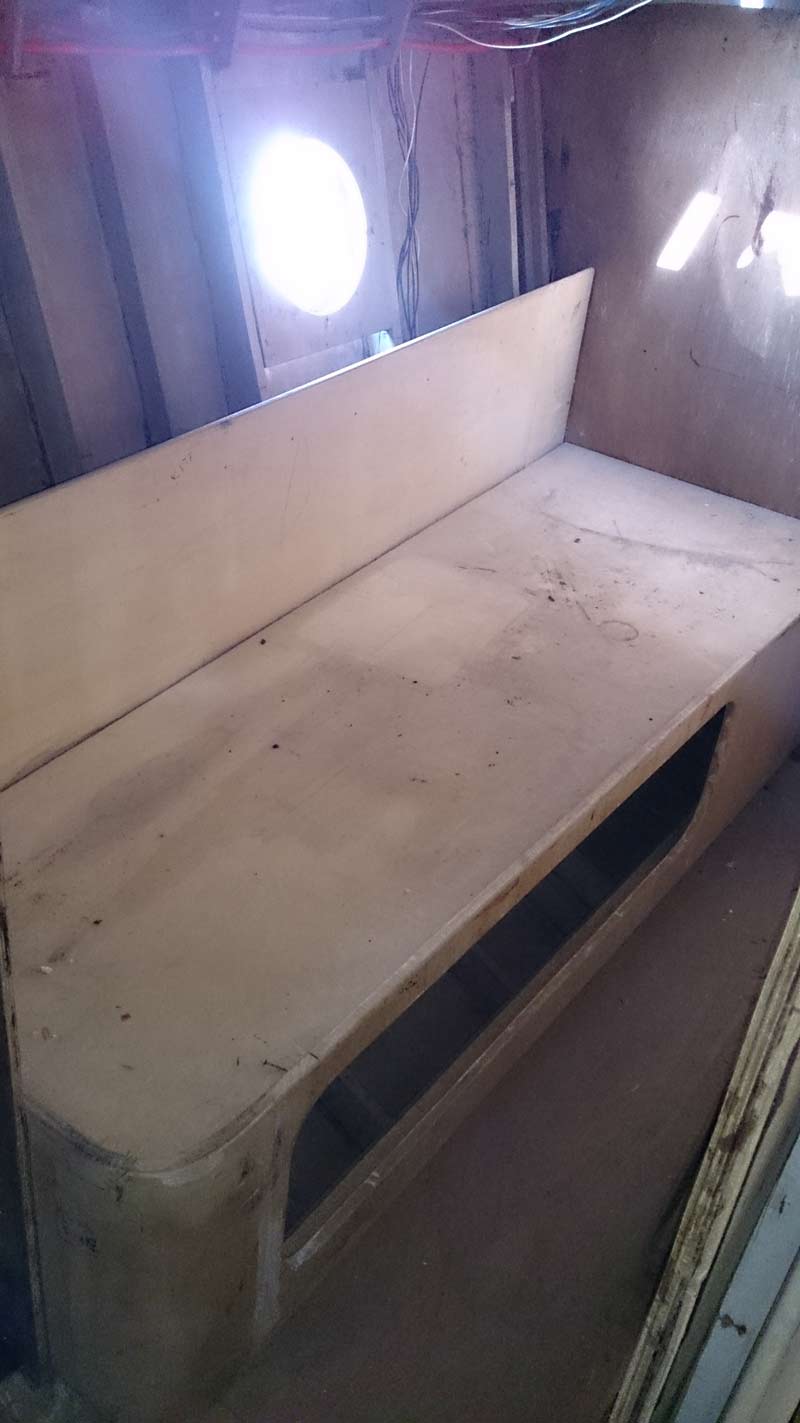

"Bed ply base is also in place. Wonder if I should drill any holes for vent/reducing condensation etc, but will leave it for later."
I would recommend drilling holes, it's something I need to do. I've tried the 'special' matting but still amazed at how much condensation I get under the mattress. What probably doesn't help on my boat is the fresh water tank being located under the bed.

Thanks Kev, since the two panels are simply slotting in place, I'll do the drilling at some point, not too fussed right now as the bow cabin bed is currently doubling as workbench for upholstering jobs so offcuts and tools will end up in the bilges if I drill them now :D
Regarding some other comments by JFM and MM on the bed, all beds in MiToS originally had a 40mm lip over the 15mm ply that the mattress rests. I'm keeping that in both cabins, bow cabin will recreate this with a plain upholstered piece that's probably going to be slightly more than 40mm above the ply base. I cannot/wont use plank strips as suggested as I'm slightly short of height and don't want to loose any more. I had to get the bed higher than I really wanted in order to gain width (currently only 125cm wide reaching 130 at chest level) and I'm not willing to sacrifice any more headroom as I can now comfortably sit in the bed without feeling claustrophobic...

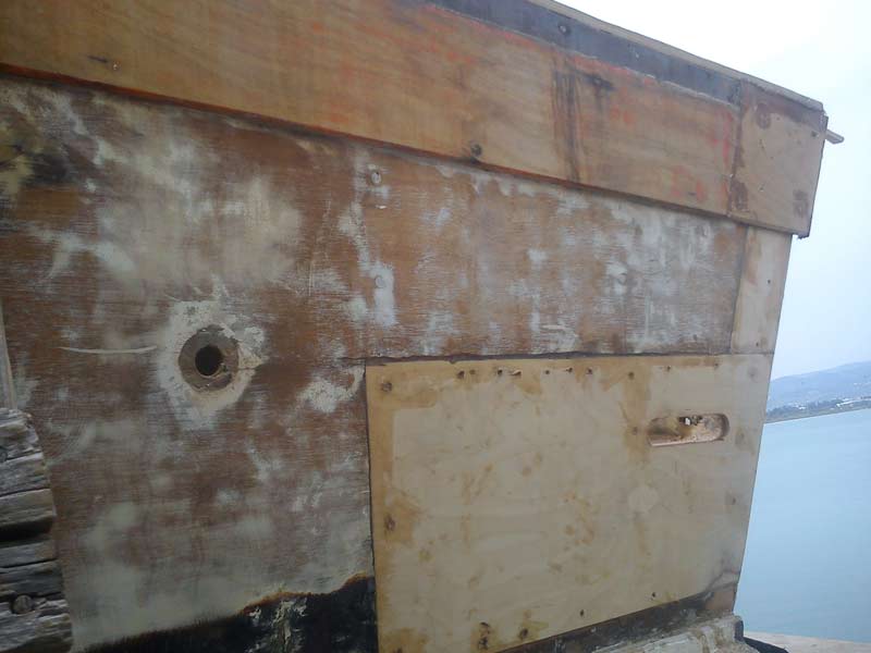

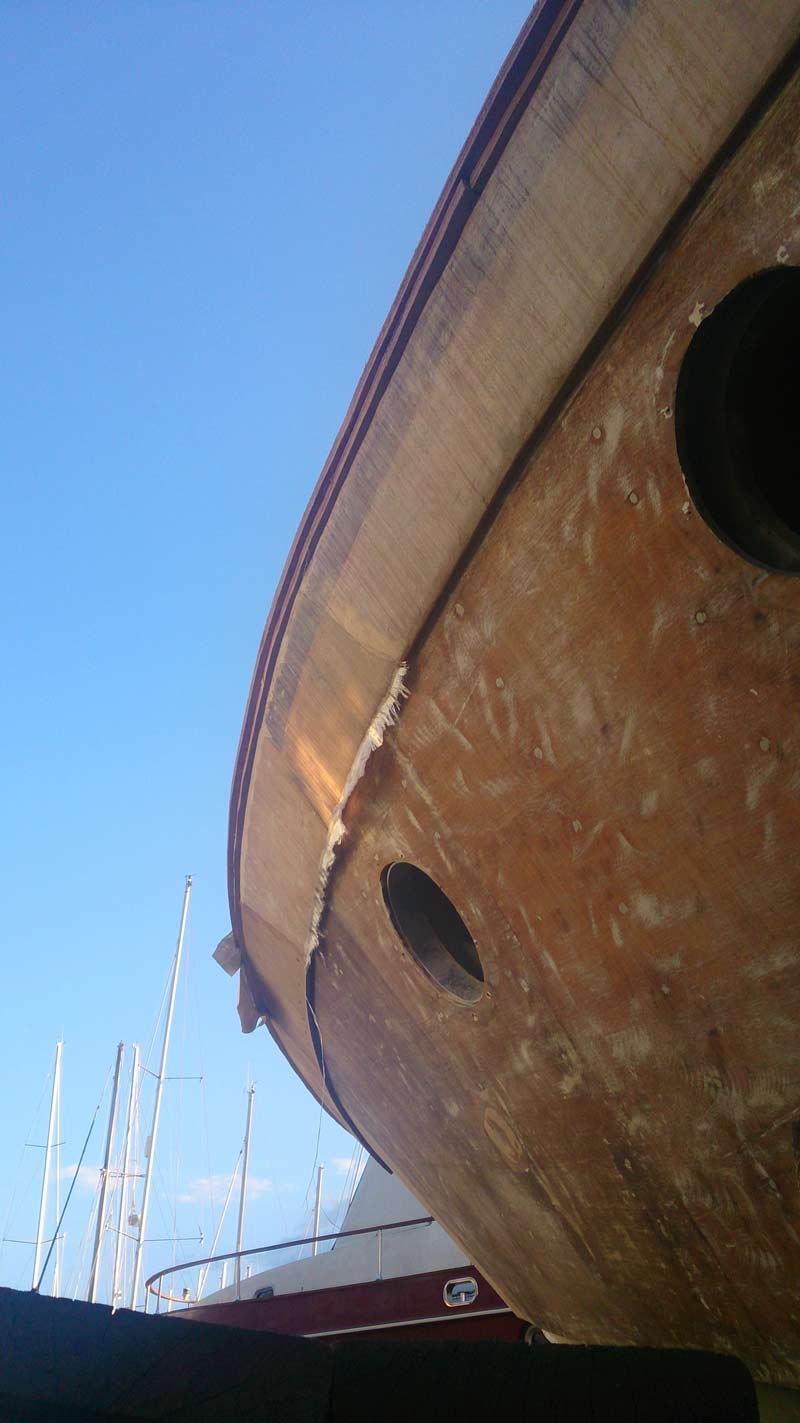

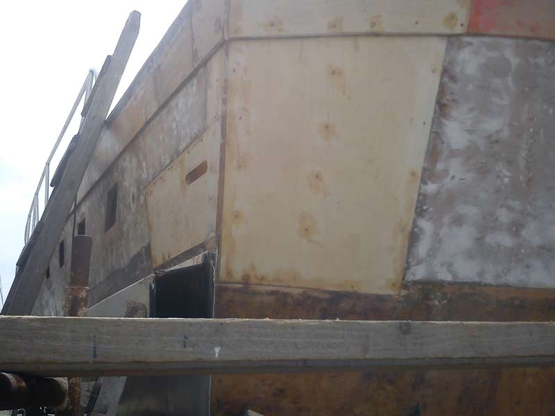

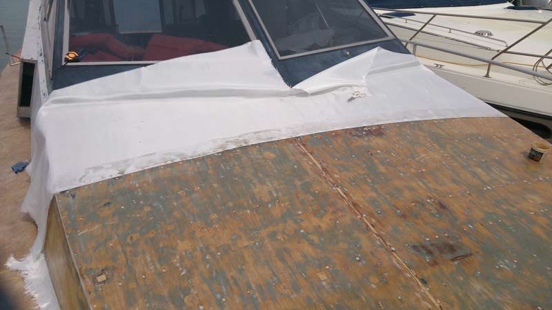

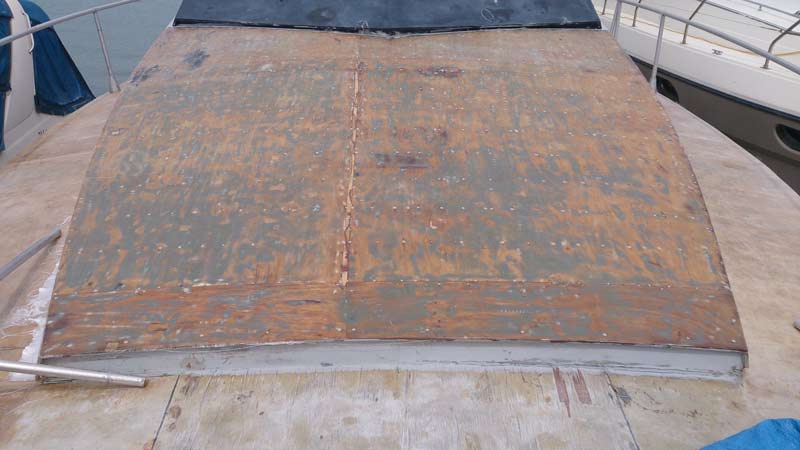

first of all, final hull patches around the transom area on both sides are done and over with:

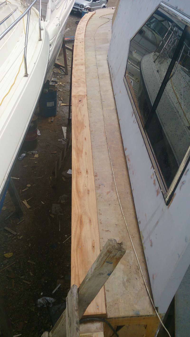

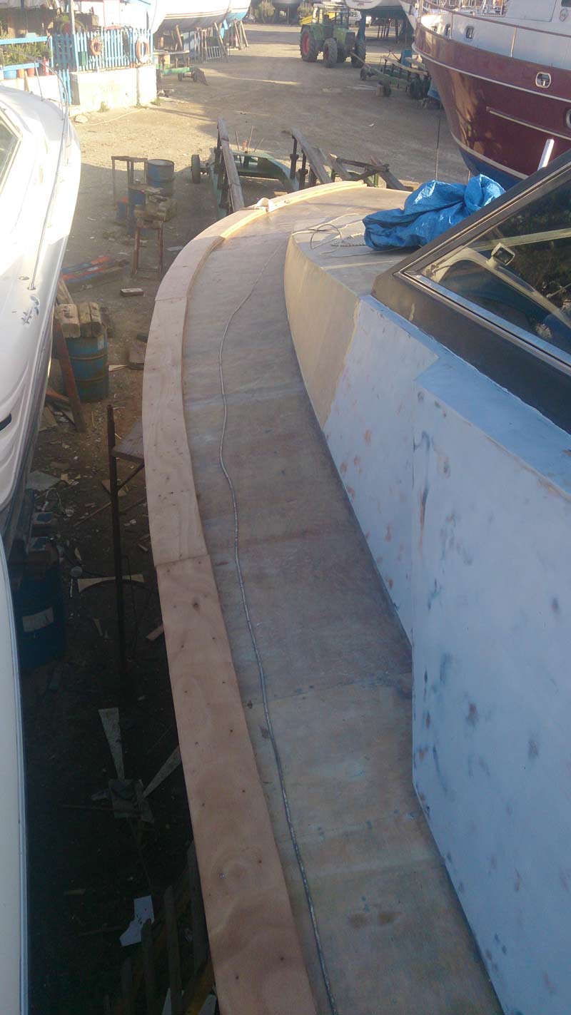

On the exterior, George sanded and removed all primer off the sundeck as I wasn't particularly happy with the finish and the fact that 2-3 minor hairline cracks re appeared after the winter. So yesterday I coated the whole sunpad (3mX3m something) with a 280gr/m2 mat and a couple of coats of epoxy. When I'm back will get a light sanding and a couple of coats before priming.
George is starting the sanding the hull on 120grit to get a first coat of primer and will work from there on over the next couple of weeks.

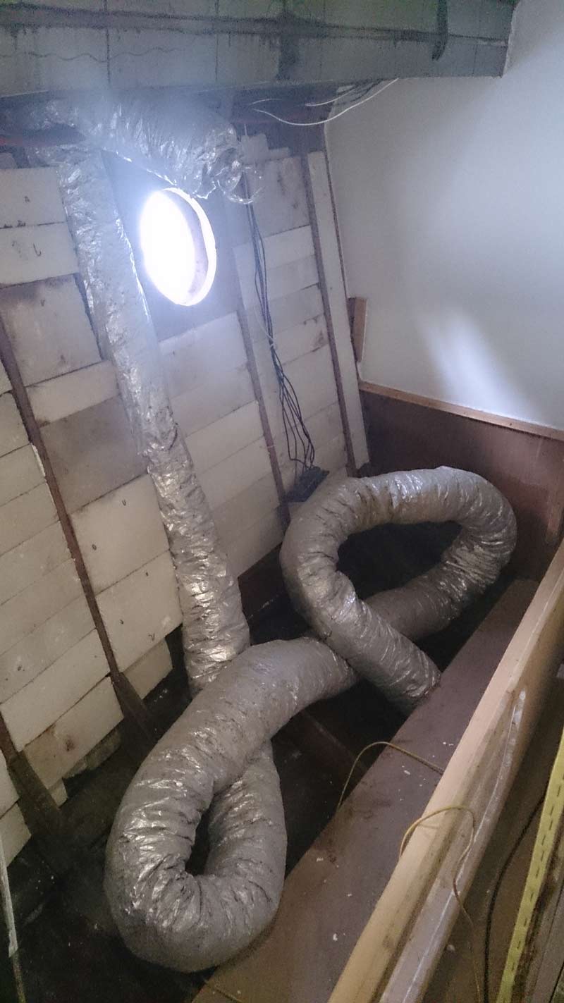

Inside, I got the bow cabin complete (that is MY idea of completion which means that the side decks are NOT lined so that I can check that everything is fine with all the work above, railings, cleats, etc).

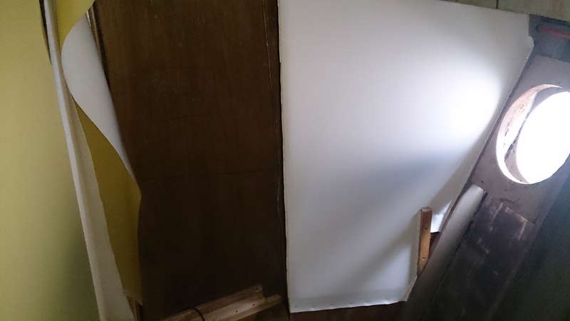

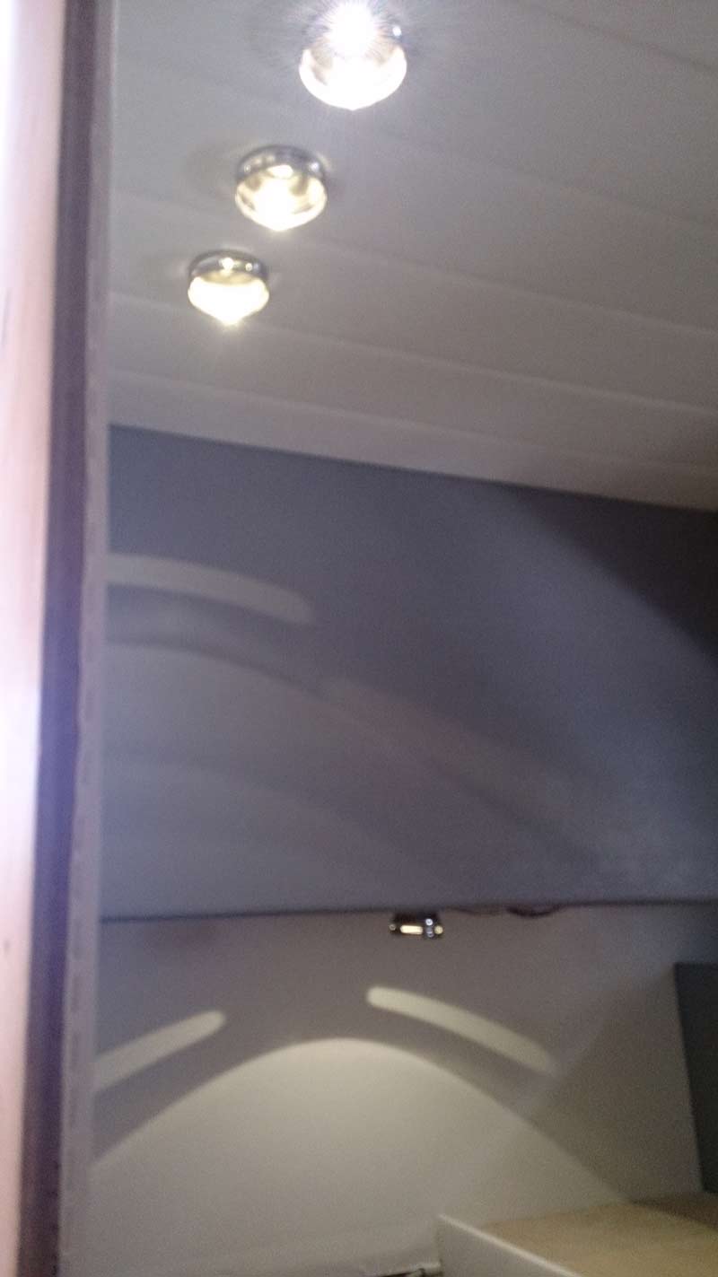

a lousy pic of the ceiling strips test fitted, got to remove them once more to fit the rockwool insulation before final placement and fitting lights and sensors.

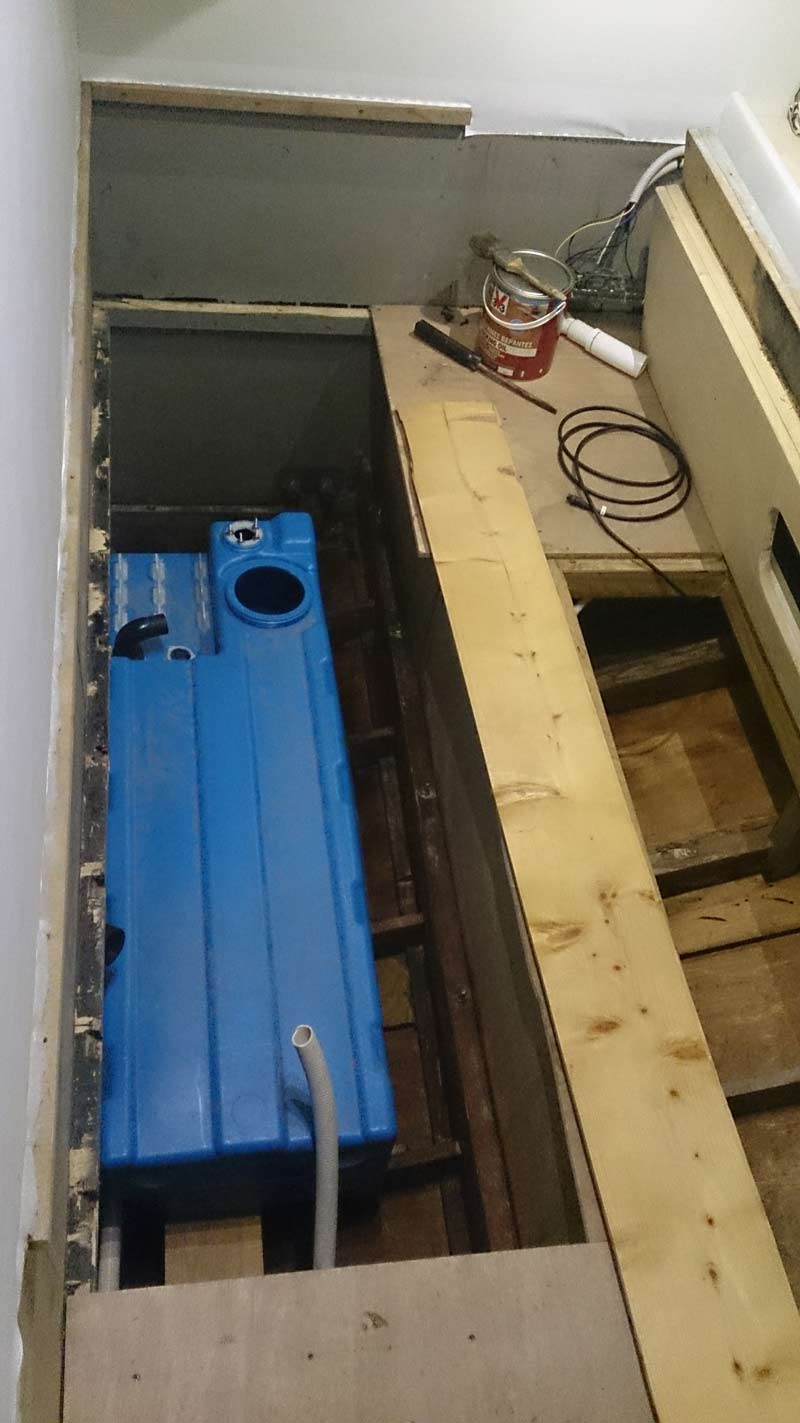

Port cabin was not as simple and quick as I imagined (no wonder...) and took me considerable more than expected. Final result is v.good and I'm v.pleased with it.
Thumbs and wrists are definitely NOT pleased (as in knackered), so next few days is typing on the keyboard and driving to restore them ready for the stbrd cabin.

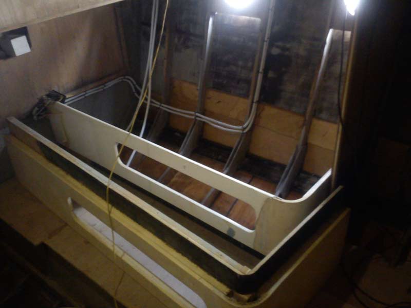

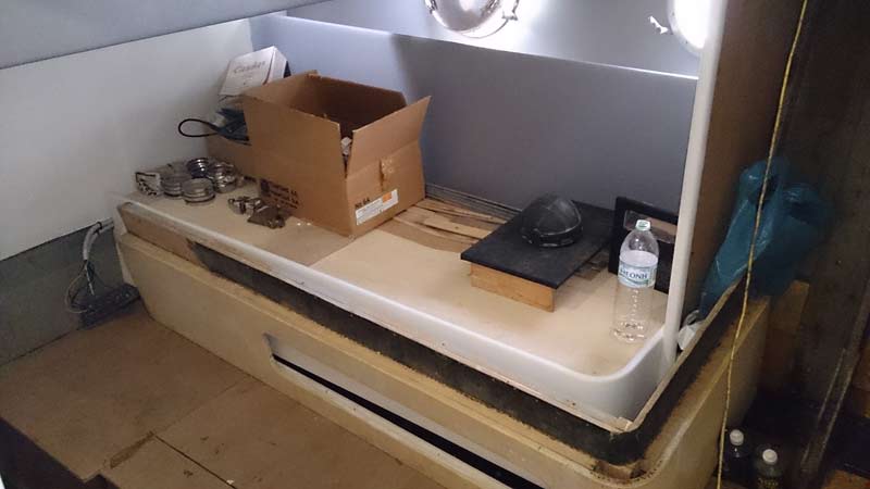

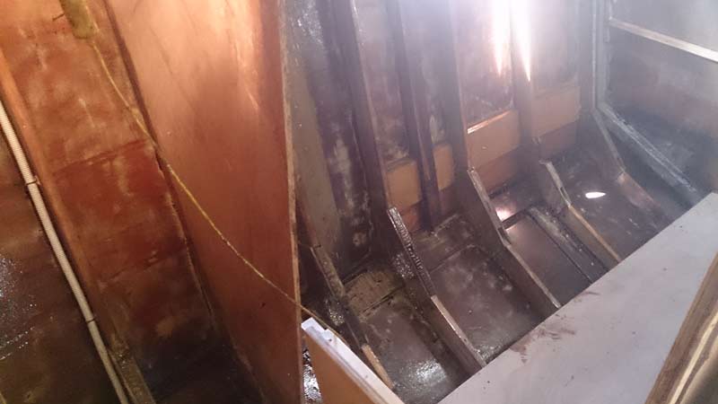

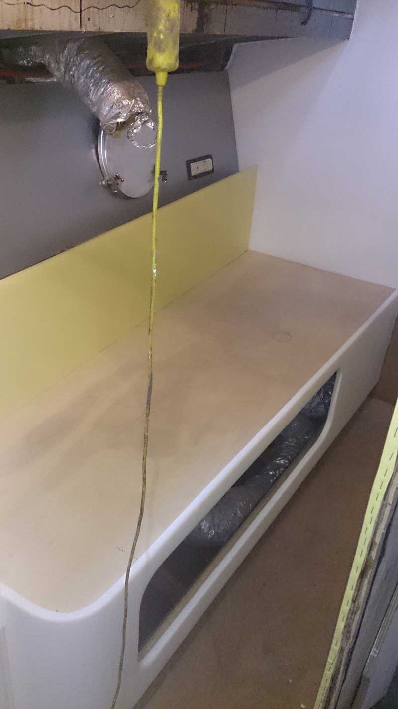

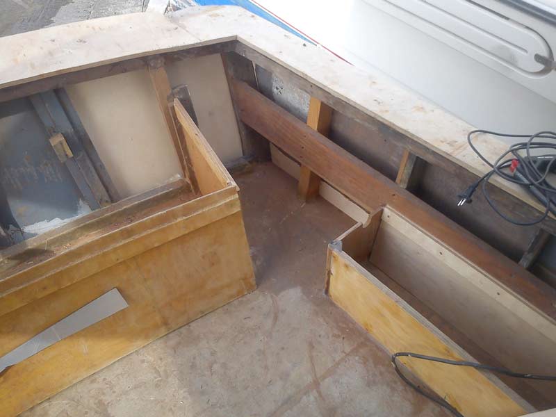

Biggest issues were the lining of the bed frames and the fitting of the ceiling slats.
Bed frames had as normal the original vinyl lining with one zillion staples (some areas rusted, other ok(ish) Took me more than 3h per bed to remove the old lining and clean up the staples (as in remove them one by one :eek: )
Then it took me another 4h to reline the one bed you see in the pics.
Hands didn't agree to do the second bed though but I persuaded them to do some mat and epoxy under the blazing sun on the deck instead so everyone was happy :p

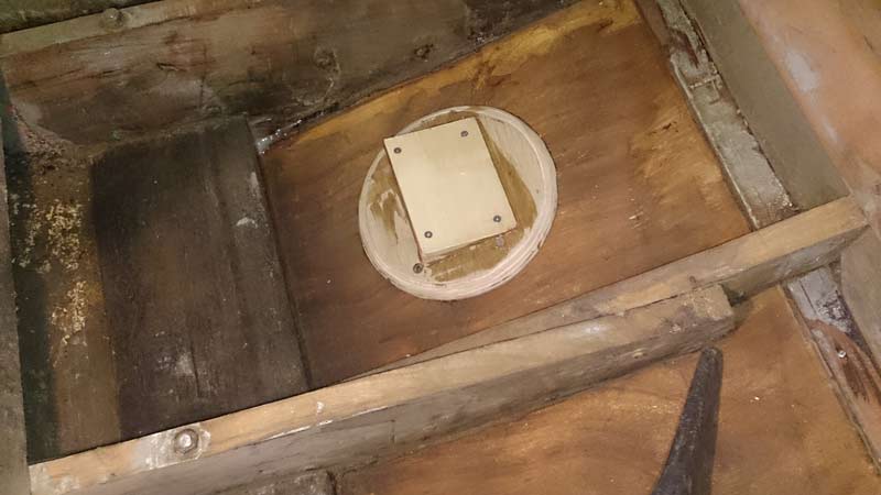

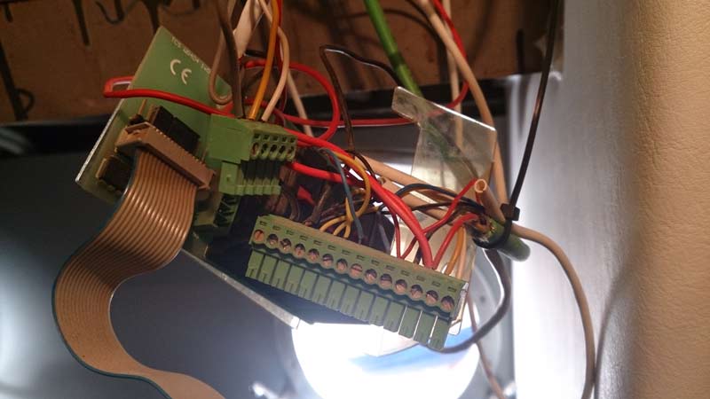

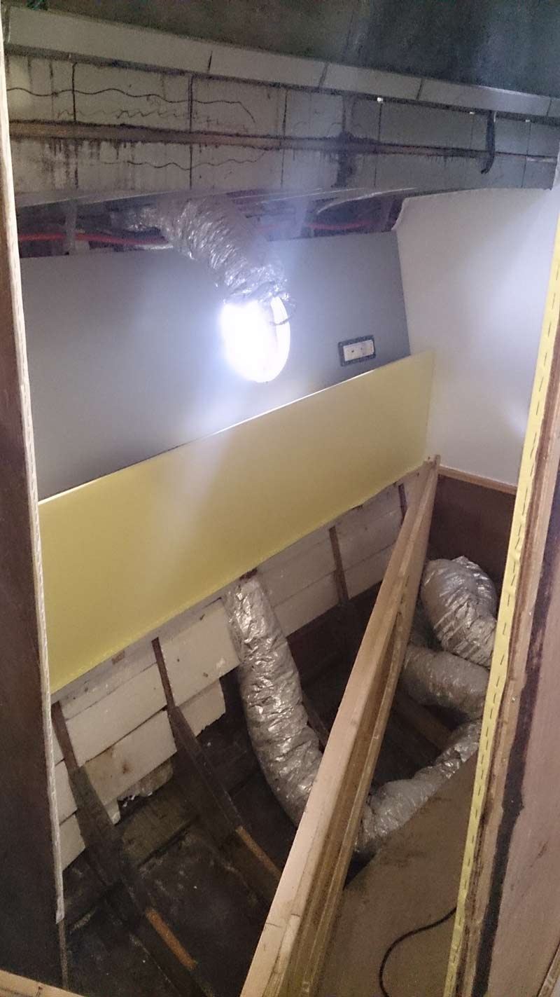

Not too worried as I got to get the black water tank in place, strap it up, connect all pipework and then fit the bed on top.

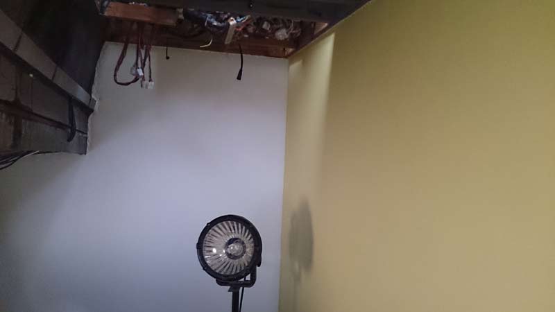

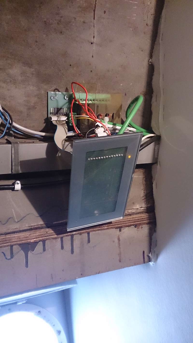

In between had to clean up the wiring to the BMS and reroute some cabling for a neat finish. So went from this:
to this:

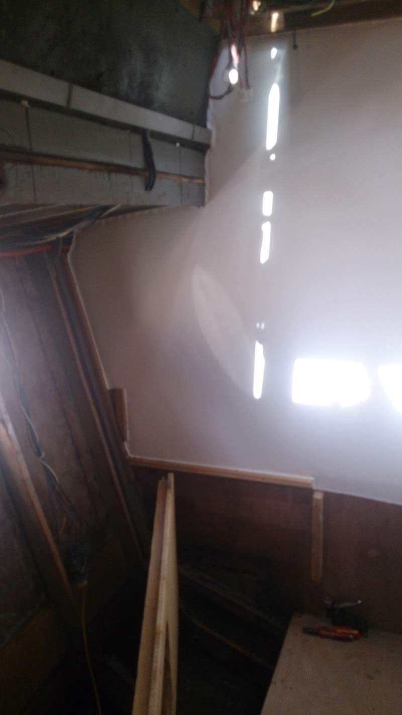

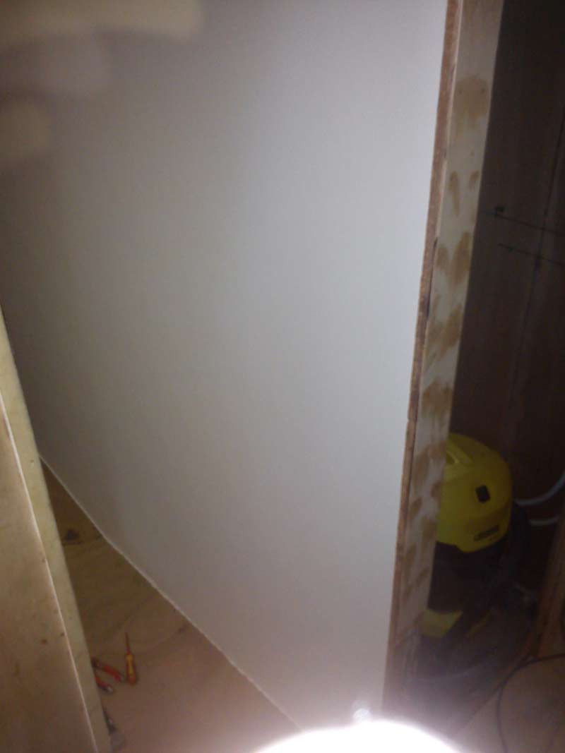

Ceiling was a bitch to fit as the new foam for the lining was slightly thicker than the old one, so turned out I was missing 2-3mm per slat. Meaning I was missing 15mm by the time I reached the cabinet/wardrobe. After a lot of swearing, headscratching and hammering with a mallet I remove them all again, removed the upholstery on strip #1, chopped 15mm of it, reupholstered it and refit everything == all this mess took the best part of a working day :(
Anyway, result is now close to perfect, lights and sensors are on, so v.happy.

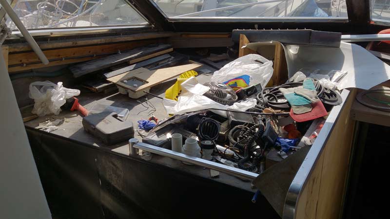

Today it took me half the morning to sort out the stuff accumulated in the stbrd cabin over the winter. Neatly cleaned them and organized them in boxes in the port cabin so that I can have a go teakoiling the bilges in the stbrd cabin and then lining it all up. That's what they look like now:
Next issue to tackle hopefully before the Easter vacations are over will be the chart table and galley area which unfortunately looks like this right now (after a bit of tidying up today...)

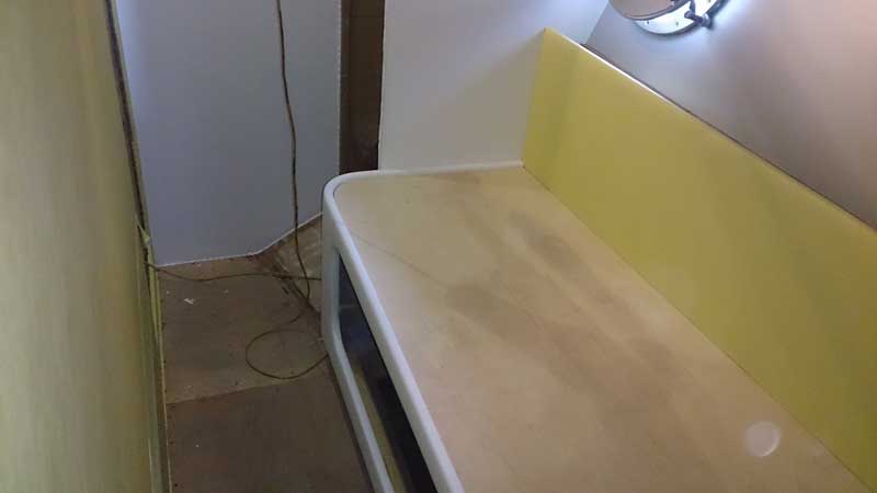

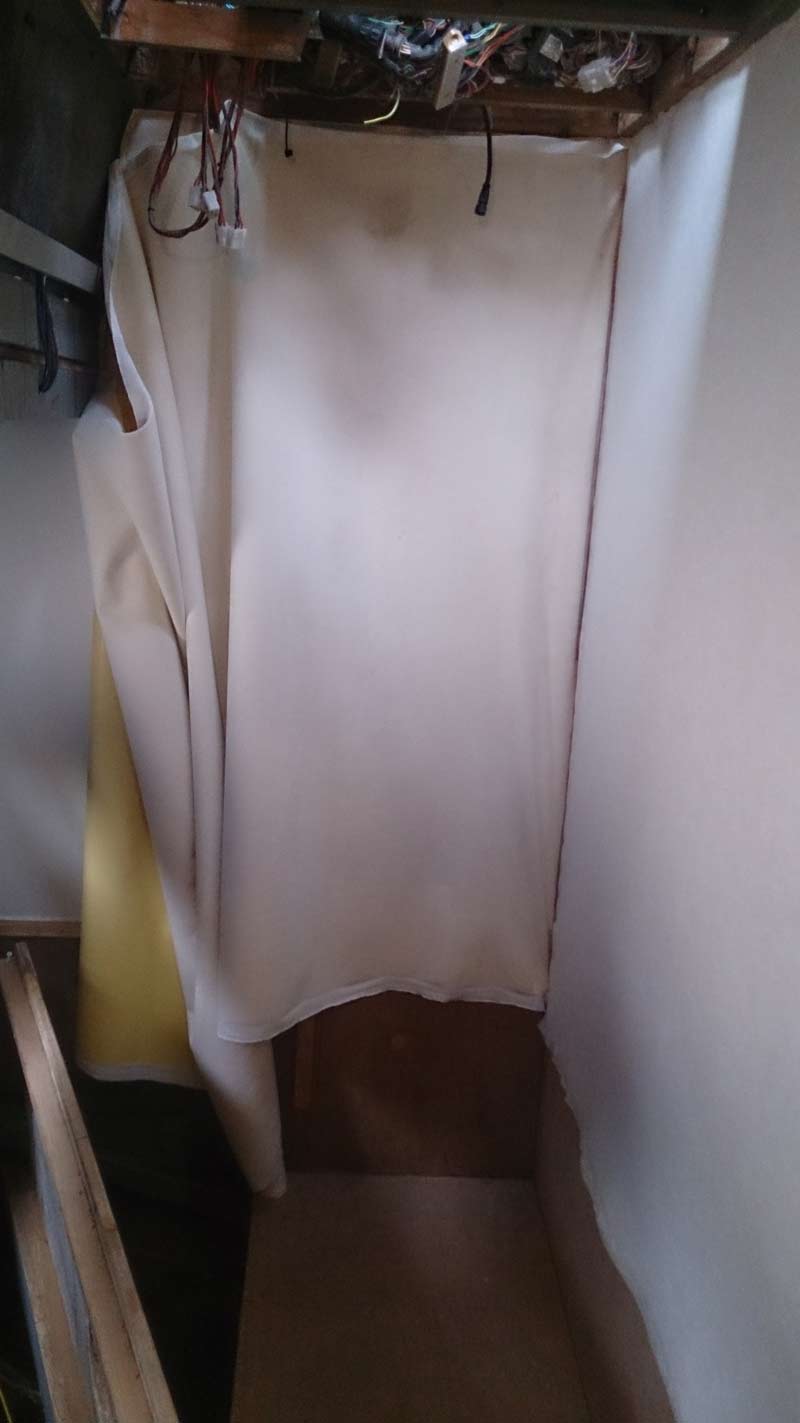

quick update before I go and pickup my daughter from a party in a village 15km away and 650m altitude :(

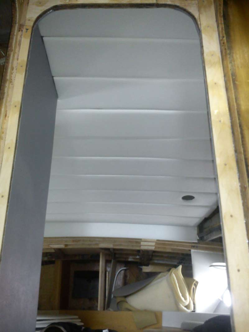

Stbrd cabin is almost done
remember you got to get the walls either clockwise or counterclockwise and plan it well. I started with the short white one and moved to the v.long (er for a 43footer) 2.5m yellow. It was the worst bit of upholstery I've done todate as I had to stretch it using almost 80-90% of my strength to get it right. Did the top first all along the ceiling line and then did the bottom. The right hand side was last but that was easy...
again reused old polyurethane (I think!) insulation from the ceilings in two crossed layers to fill up the gaps in between the frames. So sides have 60mm insulation. should be sufficient for the Greek winter and summer :D
and the almost finished article. Just need the bed itself and the v.short white bulkhead on the left of the cabinet. Should finish it tomorrow morning.

stbrd cabin complete, need the box under the bed (that after all this chopping and fitting, wont fit at all, so needs dismantling, chopping, reupholstering and fitting) and the set of drawers that are in the process of being modified to fit from 600wide to 425wide...
As explained in the toerail thread, I've been working outside sorting out the decks so that George can start painting (deck to hull detailing not done yet)
Following the disapproval of the first idea by the forum, I've changed completely the methodology and ended up with a 50mm high by 170+mm wide toerail. Started with port side as it "feels" safer having a P45 on that side which is same height as MiToS and with the railing off, doesn't feel you'll fall over.
This is matched with my work at preparing the bow for epoxy and matt and marking the round port for the bow cabin. Just got the last meter to go and the 40mm ply toerail will be epoxied in place on Thursday.
Bows now looks like that:
Inside, blackwater tank is resting in it's prepared support planks nicely oiled, and only needs the securing beams around it.
