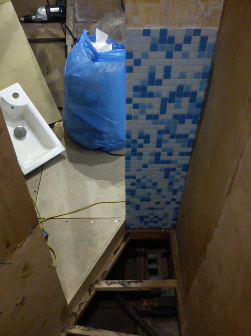

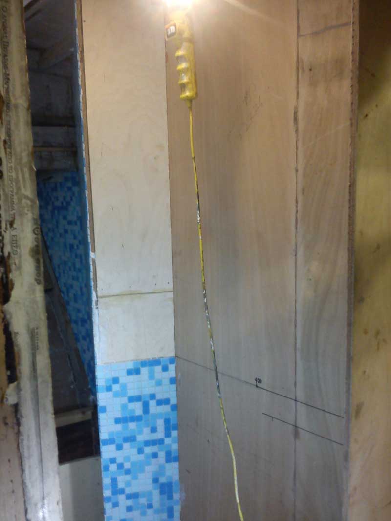

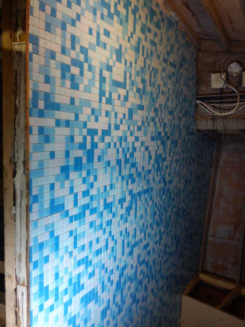

Tiling has progressed well, more or less finished the main heads, did a bit (had glue left over basically :rolleyes: ) on the other one as well.
Amazed with this superflex glue as I wanted to remove 4 pieces (they are 20x20mm ea) in order to drill a hole for the hansgrohe shower controller and it was a fcking nightmare! glue flexing and/but too strong! Eventually they all broke into small pieces. So pretty sure I'm never going to have problems with pieces dropping out of there :D
Started routing the main water line from the galley to the heads. Galley backwards means I go in the engine room and too much stuff on board currently with all the helm window frames to be able to do it... Sorted out size/routing etc for the main collectors, even managed to secure the cold water one in place. The issue is ergonomical as well as aesthetical (yes I know I'm sad as you have to undo 4 screws to get to the collectors and see the water lines!)

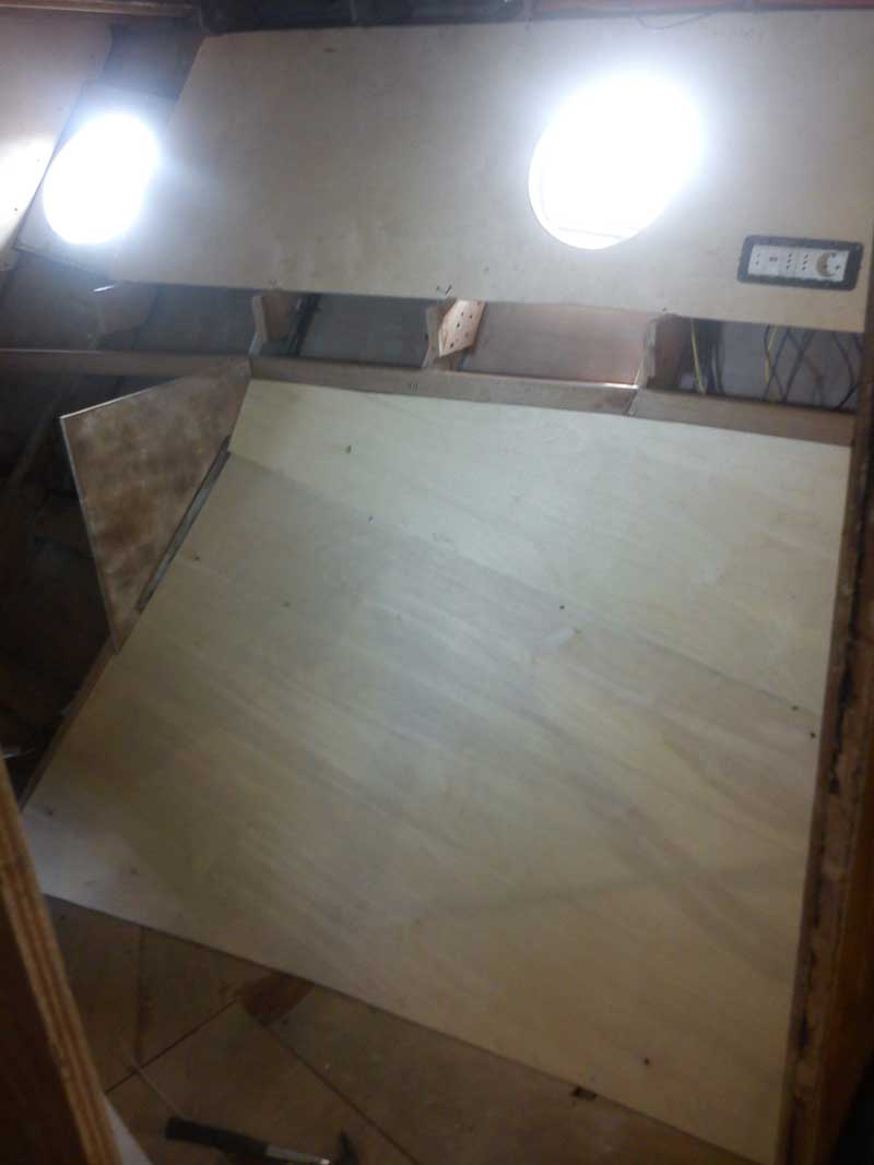

Also did the last bit of 6mm ply fitting for the area under the worksurface in the bow cabin. Two straight pieces done without much trouble (for a change...)

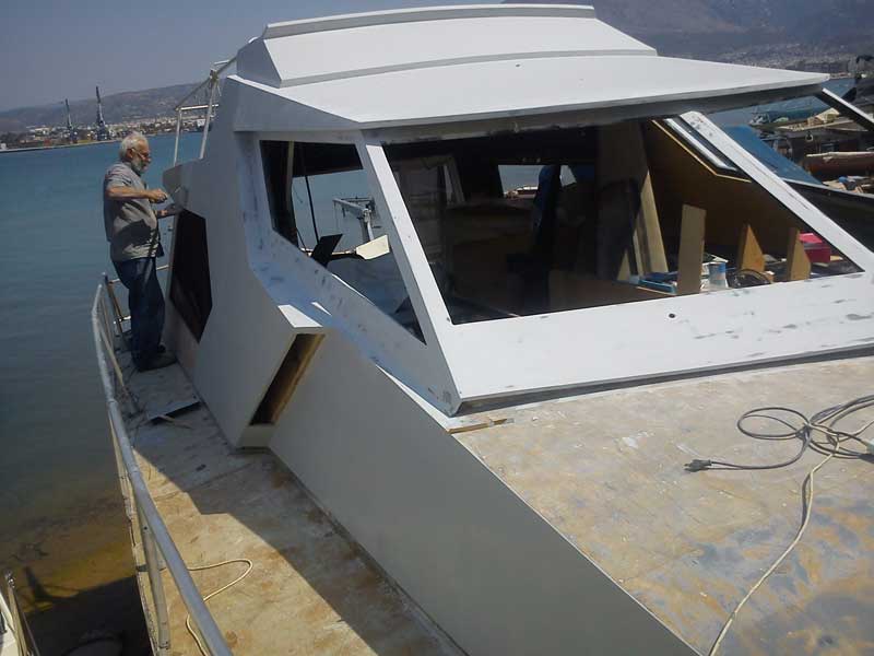

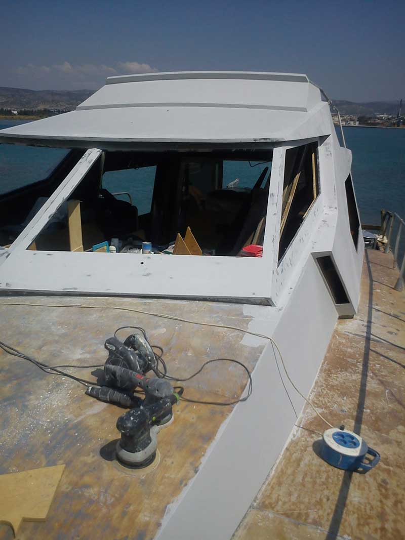

Outside, sanding/priming/sanding/filling/sanding/priming is going strong.
Today had the (hopefully) final coat of primer on all of the superstructure bar the sundeck. If the weather plays ball (no wind or N winds) we'll get the black window frames done tomorrow.

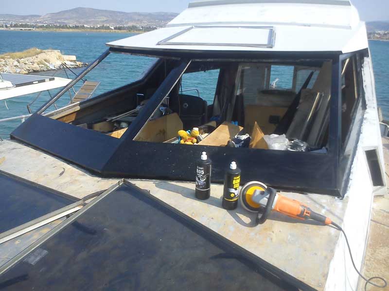

long overdue update,
following a week off due to a 4day conf in Athens and unfortunately a funeral the day before that :( I'm back in track (sort of...)

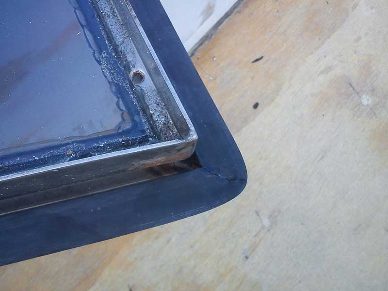

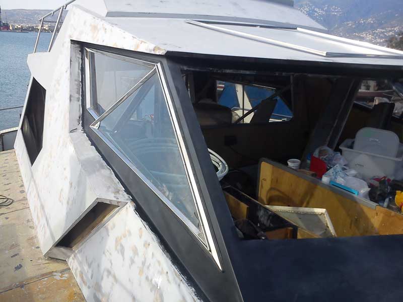

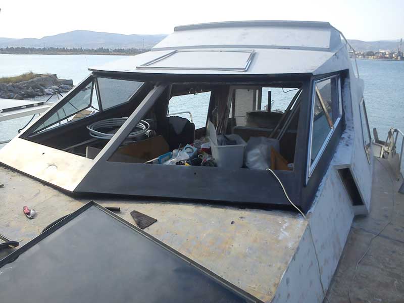

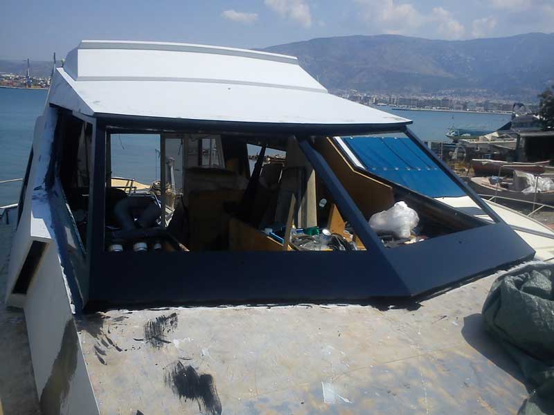

before leaving I managed to finish off with the lower helm windows, all polished, new seals, 3 coats of two pack black paint and all fitted:
seals in place, corners cut 45deg. and secured in shape with a drop of cyanoacrylic glue
sorry noticed I've not got a pic of the lot, so just trust me :p
Today was the first seal test with a serious downpour (with 28C...) where I noticed a few drops in a couple of frames, tightened the screws in the area and all's fine. Actually, seals and windows were fitted in a hot day, so guess seals had slightly expanded, today with cooler temps I managed even a couple of turns on a few screws. Many needed half to 3/4 turns, so went through all of them just to be safe.

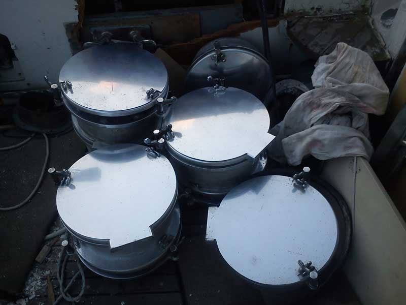

While I was away, George did a few patches on the borders of the cuts for the engine room vents (were covered with grp louvres which are now for painting) a sorted out a few bits and bobs around the hull.

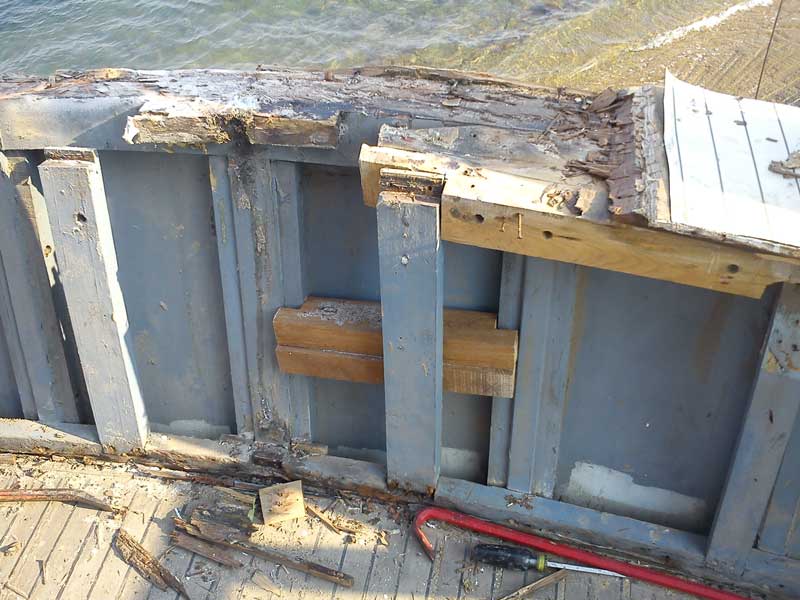

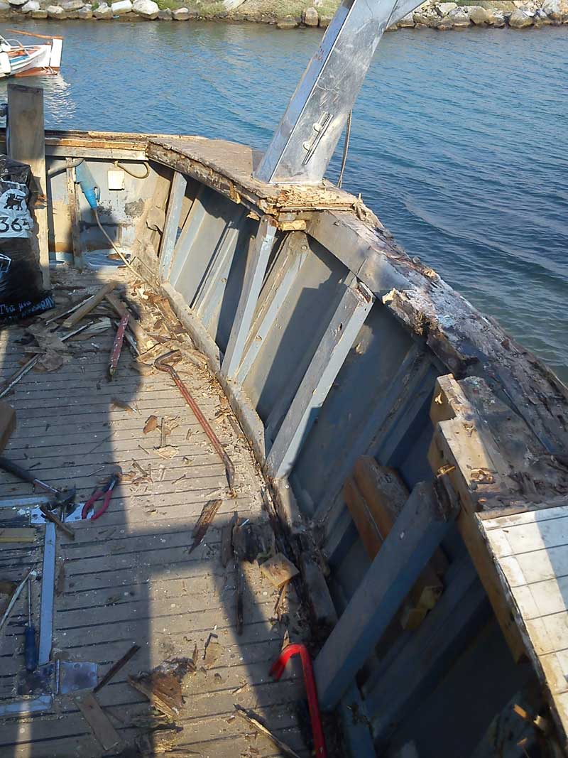

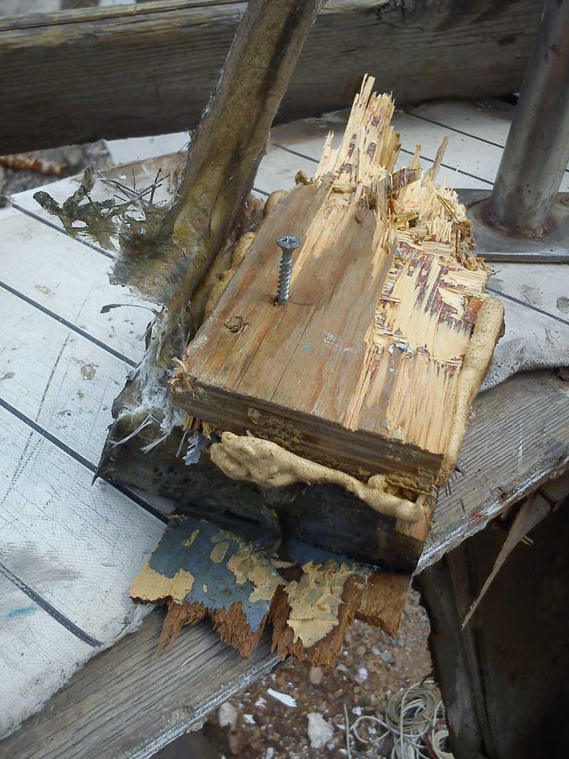

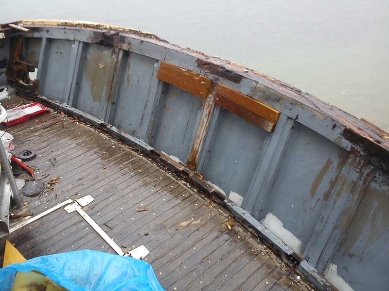

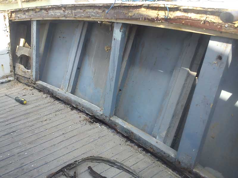

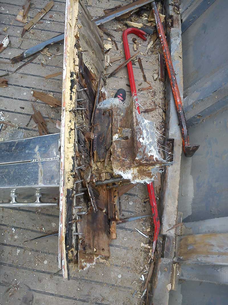

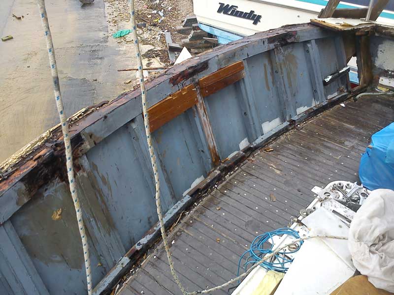

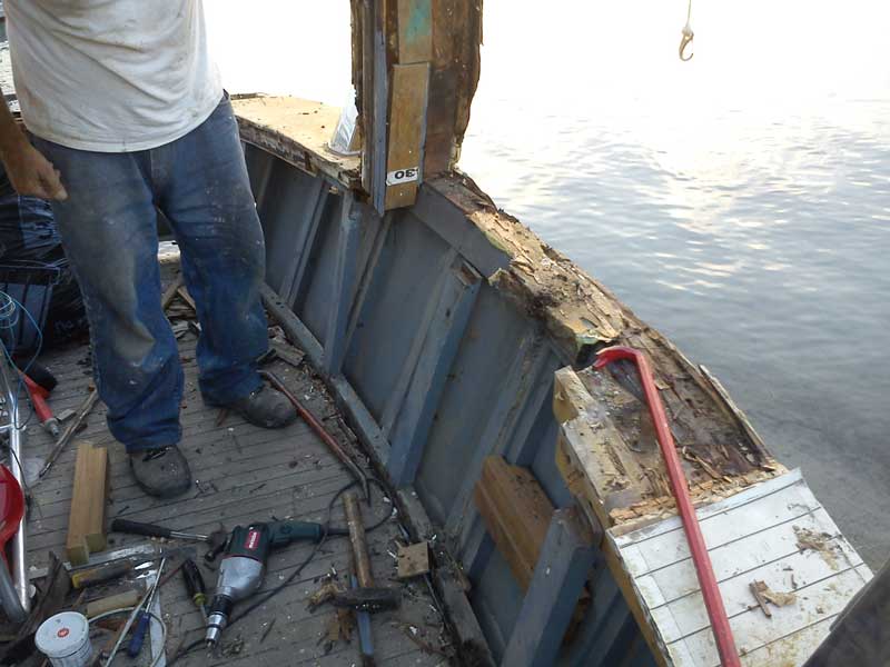

Last two days spent a good 10h working on the aft deck starting with figuring out how and where I'm fitting the passerelle. Decided on a fairly high placement basically the top of the passerelle will be around 150mm from the sill which you don't call sill... I mean the ledge around the aft deck, which at the point is around 650mm from the deck.
So needed access to the ply and frames in order to strengthen and place beams that will distribute the forces to a few of the frames. One thing led to another, ended up removing all the inner lining the top deck of this ledge (around 200mm wide in the typical fashion of iroco frame, old delam ply, grp, teak, another ply and linoleum lining...) AND the davits. Davits were secured in an unbelievable fashion with everything that you would or wouldn't imagine. Amazing thing was that they were indeed rather robust and solid.
Reinforced with various pieces of solid timber:
davit out, look at the layup :eek:
Anyway, now got a fully gutted aft deck and it's obvious that I have to also replace the deck that I was hoping to postpone for the winter. In other words another few days setback, but heyho, I wont have to mess with pry bars and saws during winter :D
Secured 4 40X80 iroco pieces that will distribute the passerelle loads to 3 frames, prepared the area, drilled and test fitted the mount.
The 50X100 iroco beam holding the transom will be strengthened with another couple of beams creating a serious bowed beam. George got a couple of pieces of iroco to work the shape and will be fitting them this week.

As regards the passerelle. This is what I've done. The key issue was spreading the load/forces across the transom and the swim platform. It looks like you have a single fold Besenzoni, which is the same as me. The hydraulic ram gives up down and is quite a simple job. There is then the option of how you flip the fold. Over or under. After a lot of messing about we chose flipping over, which meant reversing the central hinge. A job involving sweat and club hammers.
