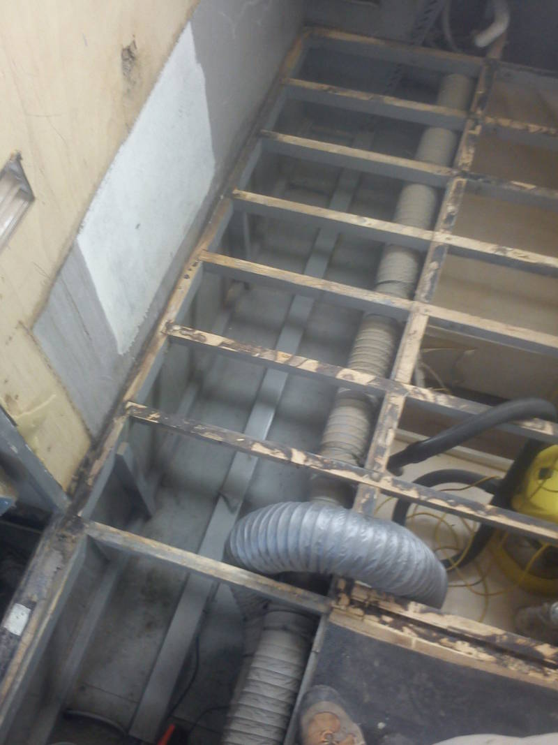

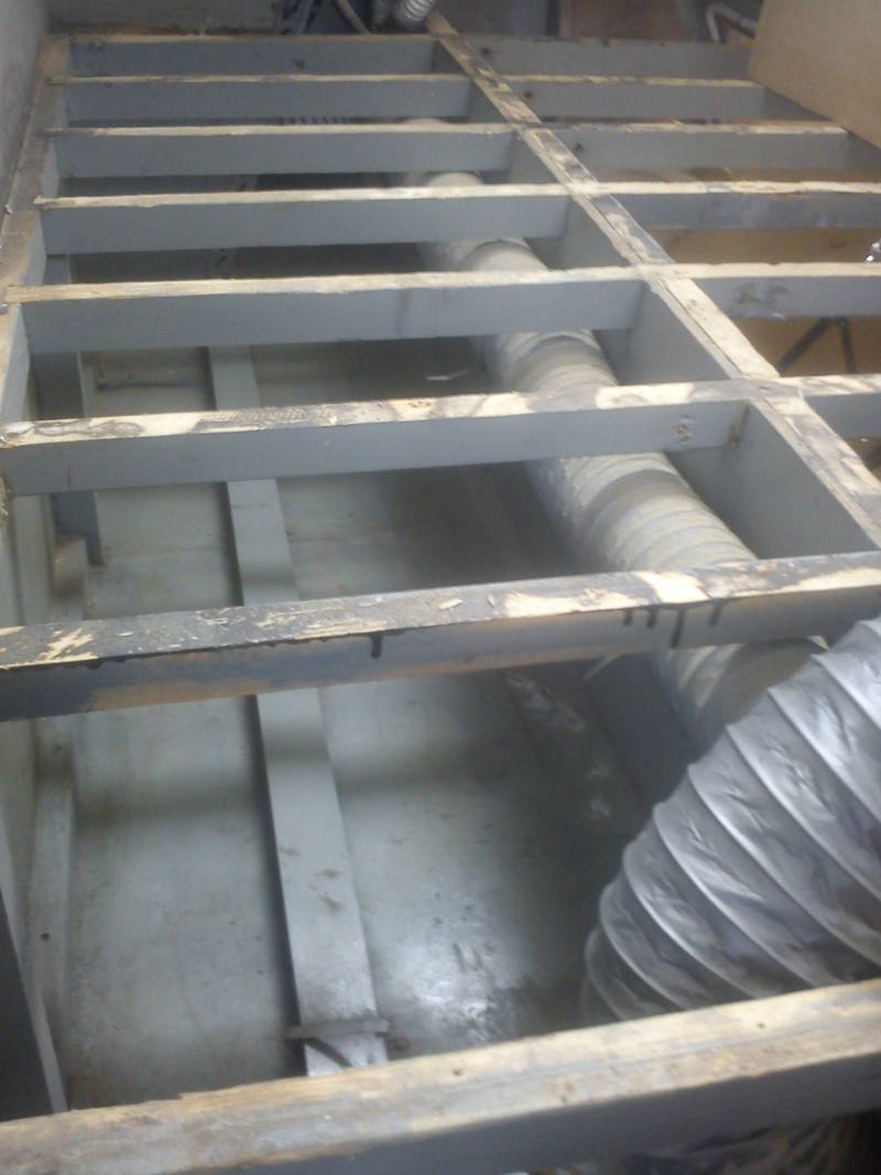

Update following a 13h session on MiToS yesterday (followed by a 10h nap, so not to be done often methinks!)

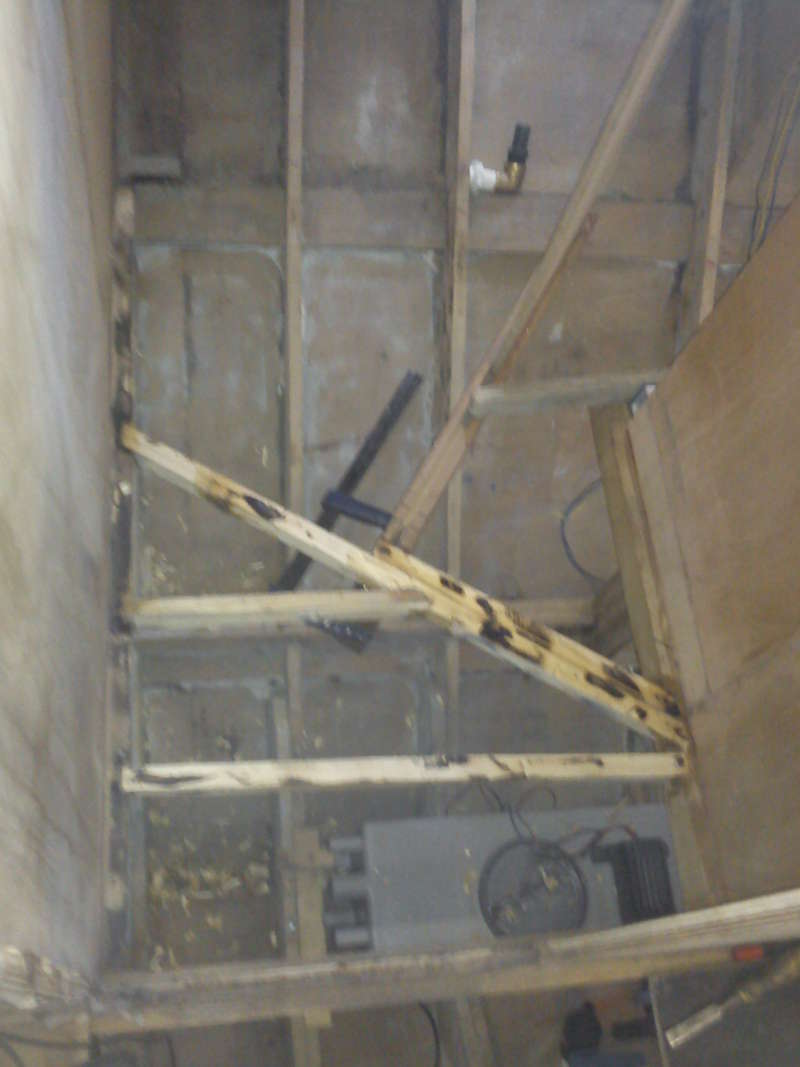

I worked on, rather under, the galley floor. There's a largish area (enough to keep a couple of reasonably sized dead bodies if one has to :p ) where a cabling duct goes through smack in the middle for some odd reason and where previous owner kept all the regulation safety equipment (life jackets, lamps, flares, disk, etc) at some point they managed (with great difficulty I guess!) to install the flex canals for the aircondition. IMHO they made a mess out of the whole thing, designwise with pipes visible and exceptionally badly routed. So after a couple of hours of testing routing and headscratching, came up with a system of bringing the pipe behind the (now under preparation for painting) galley cabinet and then have an outlet on the salon at the corner of the sofa and another one at the galley above the sink. should cover half the area around there, there's going to be another outlet above the heavily modified corner cabinet on the stbrd side of the salon, only it's an absolute bitch to cut the right hole on the flooring to get the pipe through. There's also the option of getting the second outlet at the thread of the step going from the salon to the galley, but it's too low for comfort and if you go by the hvac rules, totally wrong.

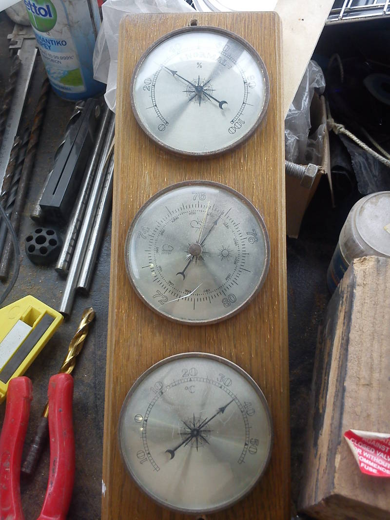

BTW, yesterday was overcast (seriously!) so the following pics show the humidity, hg and temp at the chart table. There was also an v.welcomed breeze from the NW (the exact orientation of the aft deck). So conditions were ideal to work in the area.
11:15
13:00
15:00
and no after the last photo the breeze died out and temp went further up :( so I moved down below for cooler work environment...

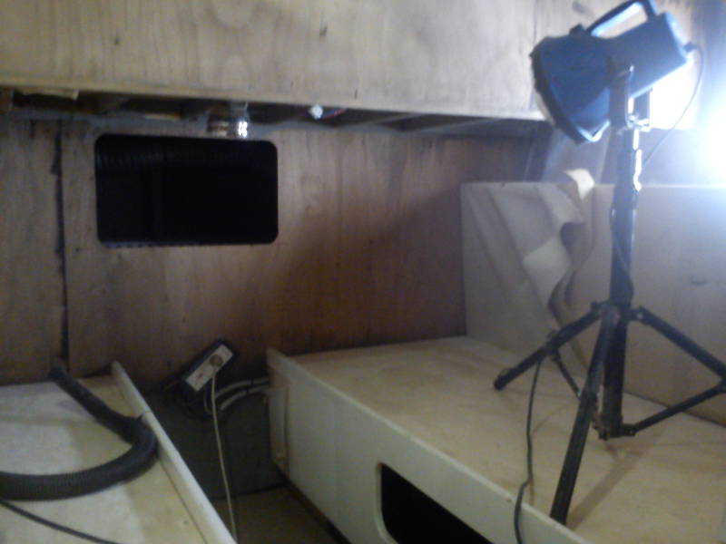

Also drilled a hole for a special alcove in the port cabin, utilising the space that I cleared by moving the aircon ducting towards the rear of the space. A similar one to be done on the stbrd cabin. Forgot to take pics though, doh!
Using thin (maybe too thin) carton, I modeled the above bed hull lining. Talking about strips of around 500mm high and where the port windows are. Did the bow cabin ones in 6mm ply so that I'll send them to my ali window constructor to cut this alucobond 5mm thick sandwich aluminum foil, rubber, aluminum foil in shape. Then I'll bolt/glue them in place so that it "takes" the slight curvature and once removed can be refitted without issues.
Plan is to do the upholstering and this hull lining for now and do the ceiling after she's afloat. Need to also make sure there's no leaks from rain/splash from the replaced decks and it's much easier to do that without the lining :D

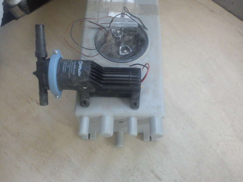

JFM, if you remember the discussion on the black water pump, I came across two Rheinstrom large diaphragm pumps type MRG 24 s/h of course on ebay and got them for 30quid each plus another 50 carriage to reach Greece. Hope you approve, mind list price around 700euro so I guess should be reasonably good :rolleyes:
I'll install the one on the black water tank and keep the second on the manual manifold bilge system at the lazarette.
Similarly I now have two whale gulper 220 pumps, one for the grey water tank the other will live nearby as part of the cabin area automatic bilge system.

Pumps sound good. Kitchen cabinets look good. Your climate instruments look very retro-sexy. Good going Vas!
tbh, I didn't remember they existed, they were stuck on the bulkhead between salon and galley at the spot I had to drill a 100mm hole for the aircon vent, that's how I got them and since I'm v.well organised, I just dumped them on the chart table :p

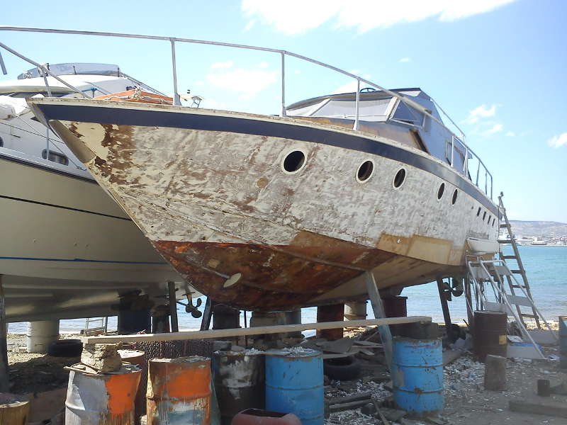

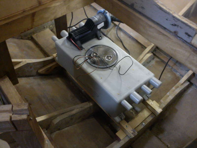

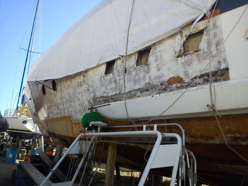

and another update following a return trip from Athens with the car loaded with sanitation/bilge pipework, blackwater tank and other stuff.

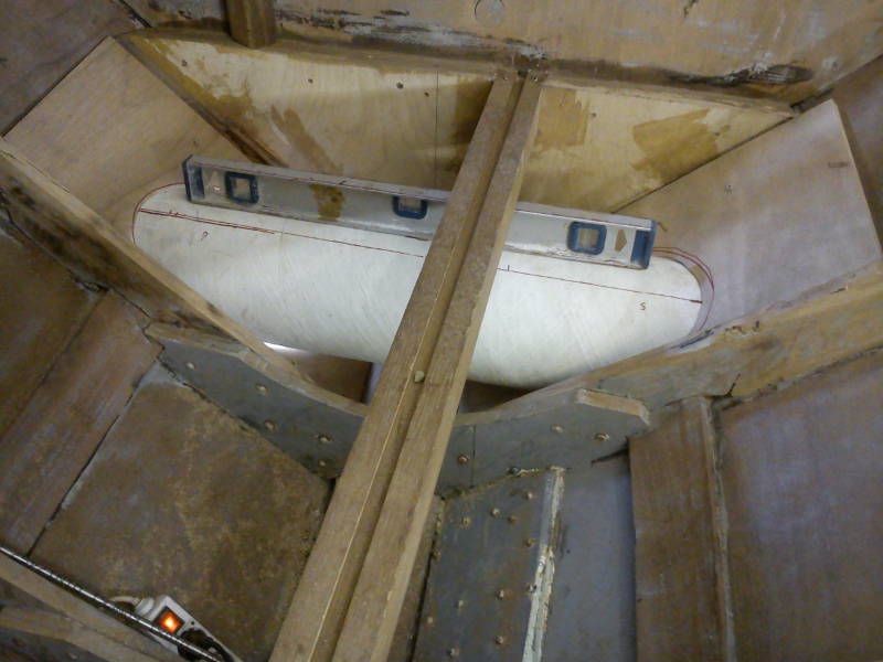

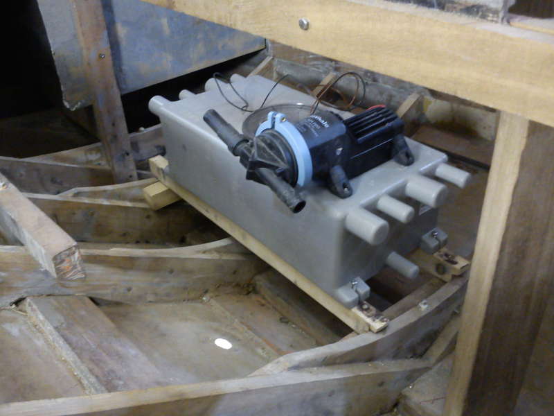

First, greywater tank (Whale 16lt) is finally in place. Position chosen (after a good couple of hours of moving it about, lots of headscratching and checking routes from sinks and showers) at the centre of the hul under the bow cabin heads but easily accessible through the bow cabin hatch. Had to construct a frame bolted on the hull frames, making sure there's a slight slope towards the end where the outlet lives. The way I mounted the pump on top of it means that even if it fails I wont make a great mess out of it as I can simply remove the pump and fit the backup (or replace diaphragm on the spot)

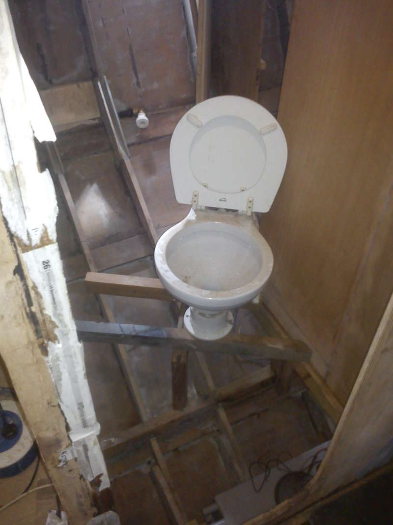

Placement of the blackwater tank (100lt) was a much easier affair as it only fits under the port cabin bed. Mind even with the massive (yet to arrive) diaphragm pump the whole thing will be lower than the cabin floor. Routes from the two heads will be reasonably short and definitely downhill. Hopefully I wont have smell issues from sewage water remaining in the pipework.
PIPEWORK Qs
A. both tanks are under the w/l. Exits will be 100-200mm OVER the w/l. DO I NEED LOOPS fitted on both??? If the answer is yes, HOW high above the w/l should that go?No seacock at outlets obviously.
B. vent for the blackwater tank (got the filter btw) should be not in close proximity with cabin ports or salon windows. Yeah rite, so wtf do I drill for the vent fitting??? I thought of moving it back to the e/r and exit it just towards the bow from the lazarette, but not sure!

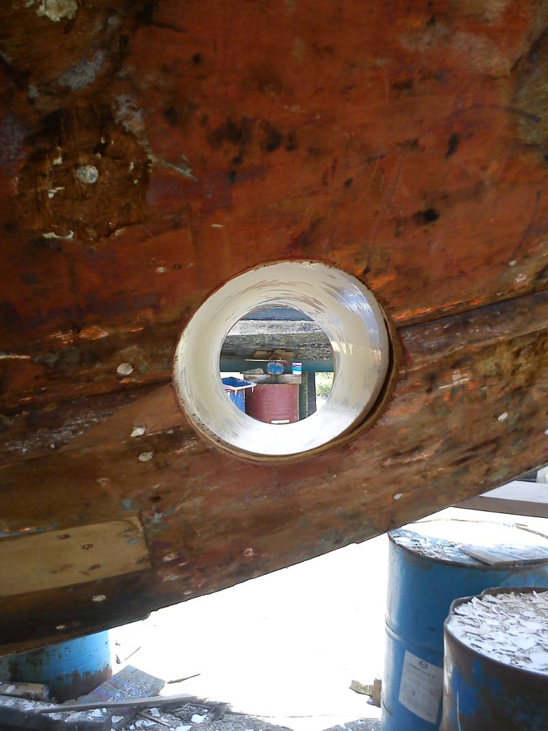

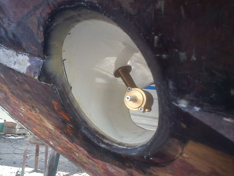

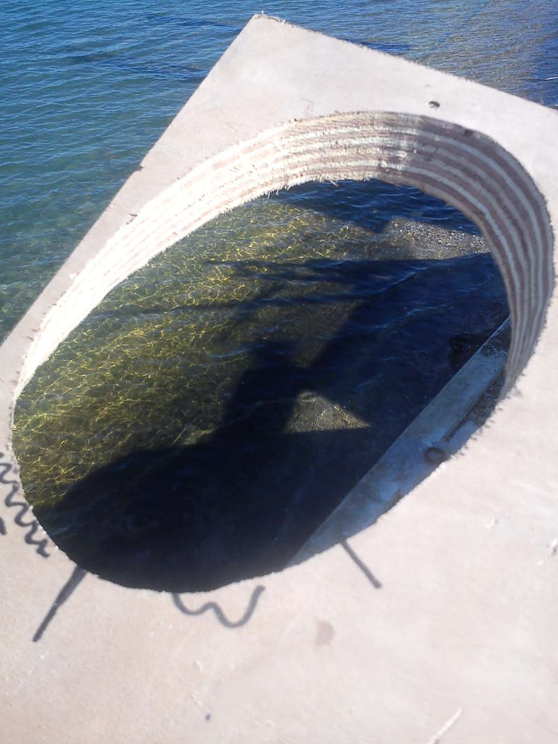

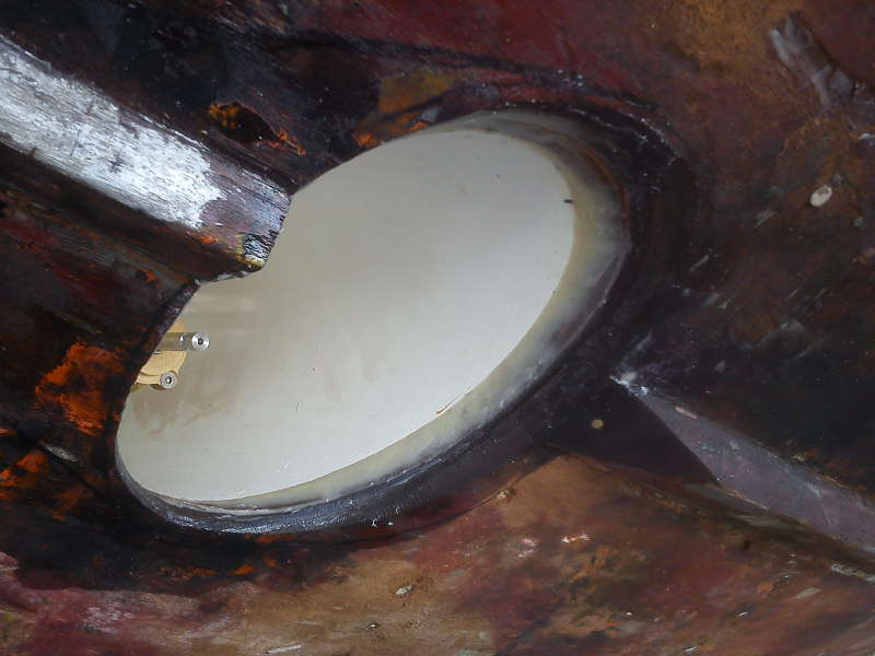

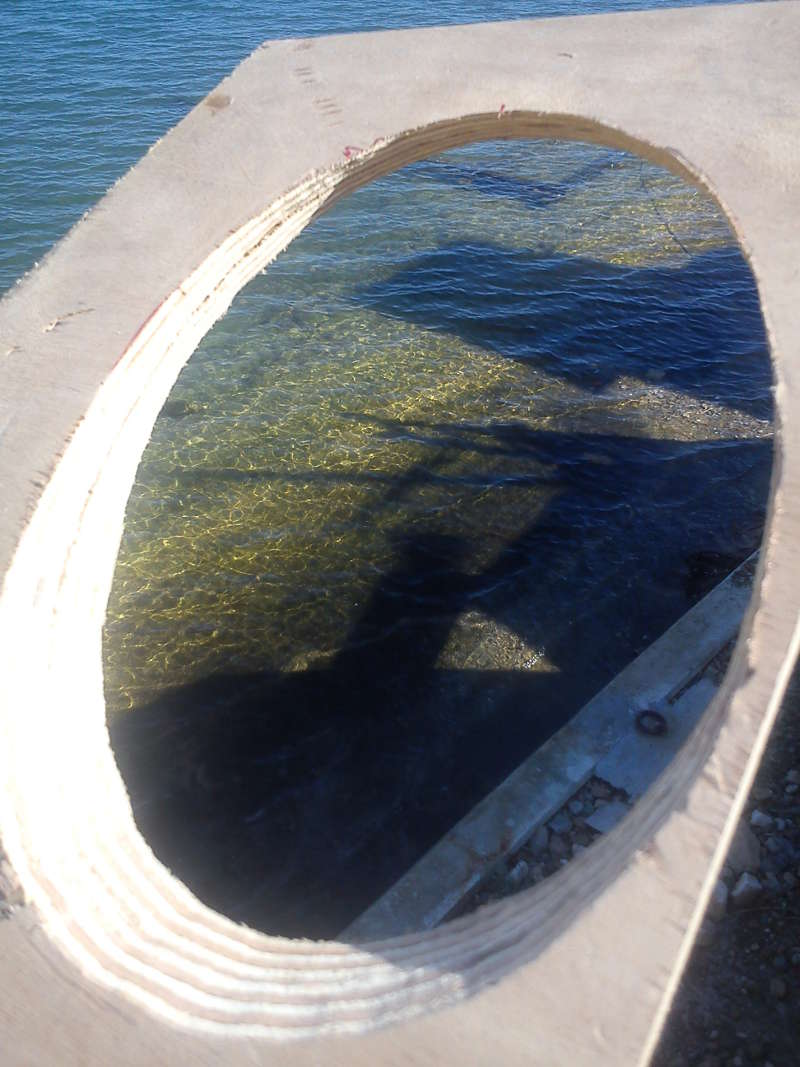

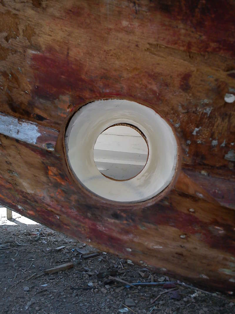

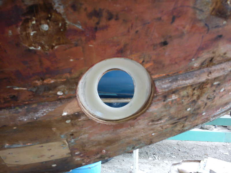

Further work carried out on the bow thruster tunnel. (ah, found a shop selling anodes in Pireaus port that had the QL fancy shaped anode for 8euro-got a spare one)
Matched and smoothened the hole on the hull ply plus one of the stackups on port and two on the stbrd. Remember first stackup is shaped to be the inner dia of the tunnel, the other two are the outside (effectively bowthruster tunnel goes through the piece #2 and #3)
Corrected some discrepancies on hull/tunnel endings and if my back plays ball, I'll have it ready for epoxying the lot tomorrow.

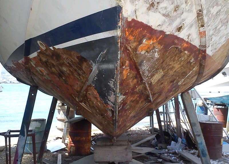

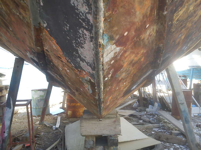

A friend came to help in hull stripping as my left arm is not happy at all atm and with a bit of help from me (he works 6h I work 2 :rolleyes: ...) I hope we'll finish the port side by the w/e. Need to also remove the port decorative frames, paintstrip and repaint them.
and as you can see from the pics above, I removed the cover over MiToS to start a few bits on the f/b plus finilise repairs around the helm windows and get in the painting phase.

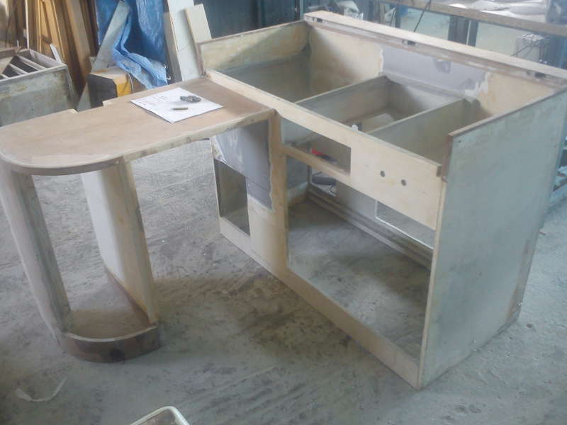

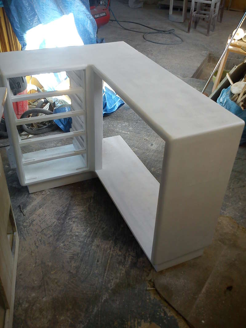

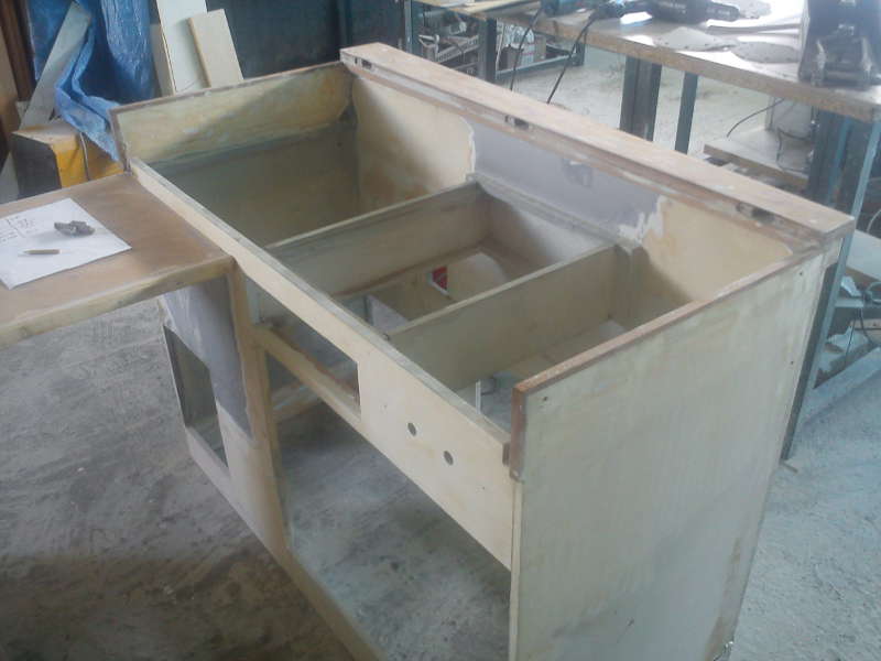

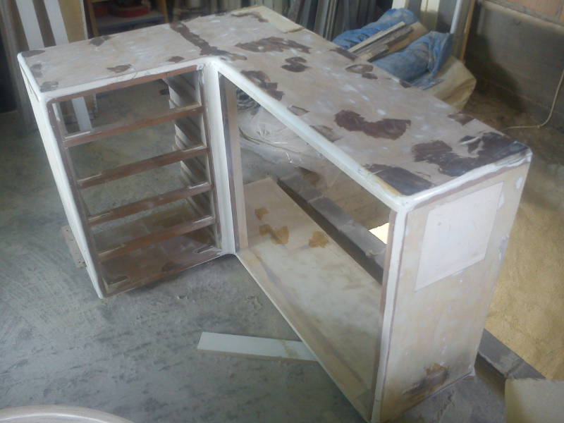

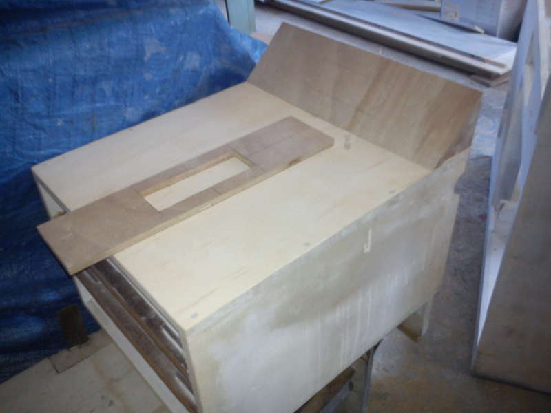

On the cabinet front, George's finished surface preparation for the galley and salon cabinets and today sprayed the first coat of primer. Will check it tomorrow and report.

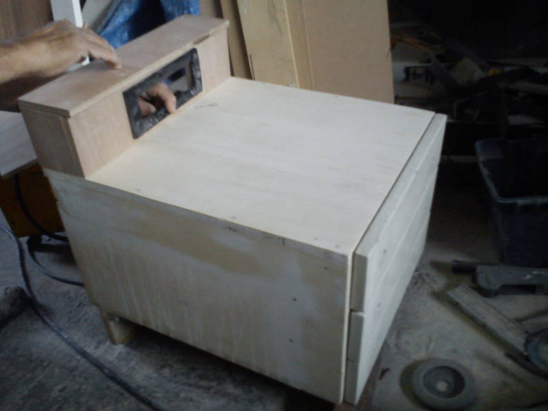

The galley cabinet with a drawer where the oven will fit. Now bear with me on this one... Since the opening wasn't large enough there's only a 190mm door to the left of the oven to give access to a massive (ok, relatively speaking...) corner cabinet. And that's not going to work, arm's not long enough. So after a lot of thinking we came with the idea of using an inverted blum drawer mechanism so that with a latch I can have the oven in the right spot and lifting the latch I can push the oven inside effectively under the side decks and then have decent access to the cabinet. You'll see it in action soon I hope ;)

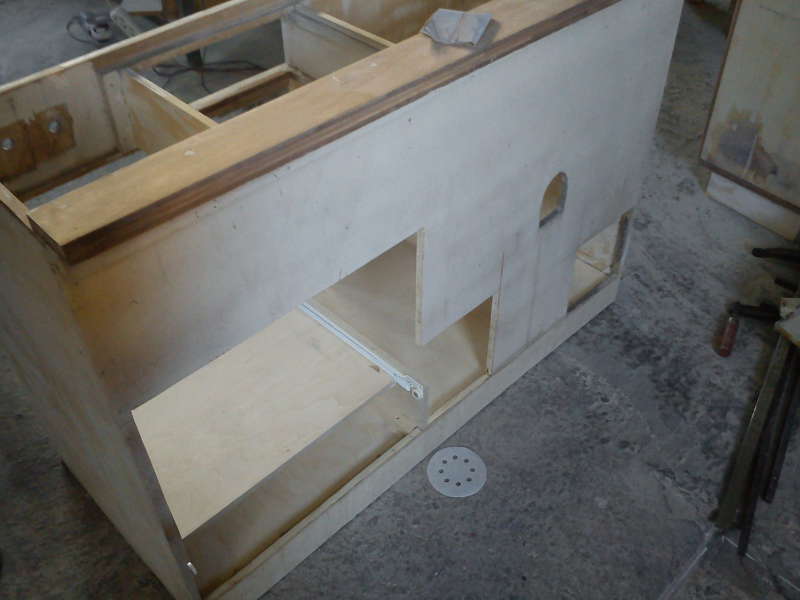

The following pic is of the port cabin drawers where I had to replace the flush switches and sockets with the Vimar stuff. No way I'd have that horizontal in there, so I designed an v.orthogonal approach to it which I didn't like and eventually went for a wedge shape. To be photographed tomorrow.
Final pic is again from the port cabin showing this low hatch, good enough for the son to store lots of "necessary" carp and still keep the place tidy (although it's rather unlikely...)

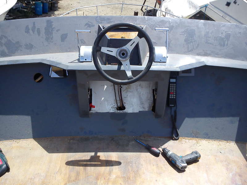

two days of full 10h work and two more to go this week.
Managed to sunburn by back after working on the f/b yesterday (in and out, but a fair amount of time with no t-shirt up there) And it was bloody overcast (but hot!!!)
anyway, managed to fit the el. plugs for the f/b, the vhf and a nice ss vent for the lower helm that reaches crazy temps at noontime. Forget the second 75mm hole on port, just an unfortunate event (drilled on wrong marker, doh!) will fill tomorrow when I glue the bow thruster tunnel. Also routed all cabling to the f/b with 2 8core cables for A/P and various NMEA0183 signals available since I want to sort out upholstery panels on the lower helm and slowly remove all carp off the salon in order to replace flooring panels there and start the refit.

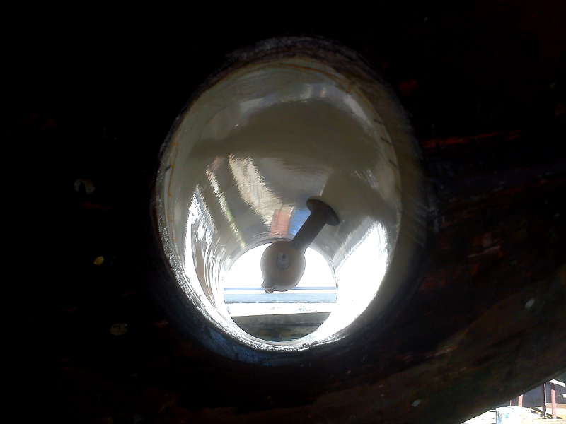

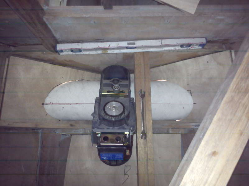

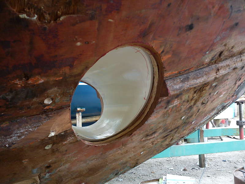

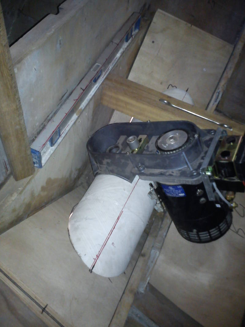

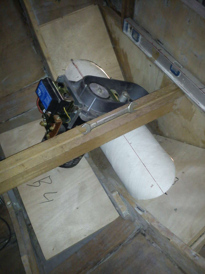

On the bowthruster tunnel front, I've matched and got a nice fit on three layers of 15mm ply on both sides. The idea is that the first layer is where the tunnel rests, the other two are around the tunnel, effectively keeping it in place. Worked fine except for the approximate 30times of me going down the ladder to the hard, checking placement of the tunnel vs the hull on both sides, marking, climbing up again, removing panels and tunnel, trimming, modifying accordingly and doing the same loop again. Rather tiring I can tell you :(
Test fitting the gearbox and motor (motor is exceptionally heavy shifting it about in there is a major thing...
fits nicely with the whole transmission sitting 8mm offcentre but I wont bother tbh.
Port side:
stbrd side:
Plan is tomorrow with the help of George to glue all these layers of ply and the tunnel in place (AFTER remembering to drill the 20mm hole I've marked for the axle to the propelers :rolleyes: )
Then over the w/e sort out the chamfering of the hull ply around the thruster tunnel, and shape the wedges I want to fit towards the bow of the tunnel holes to deflect smoothly the water bypassing the wider aft part of the tunnel. Can be seen a bit in the bow pic below:
Left this pic for last as I really really like it for some reason (although hull is a nasty patchwork but it's coming along nicely)
PORT SIDE FINISHED :D :D

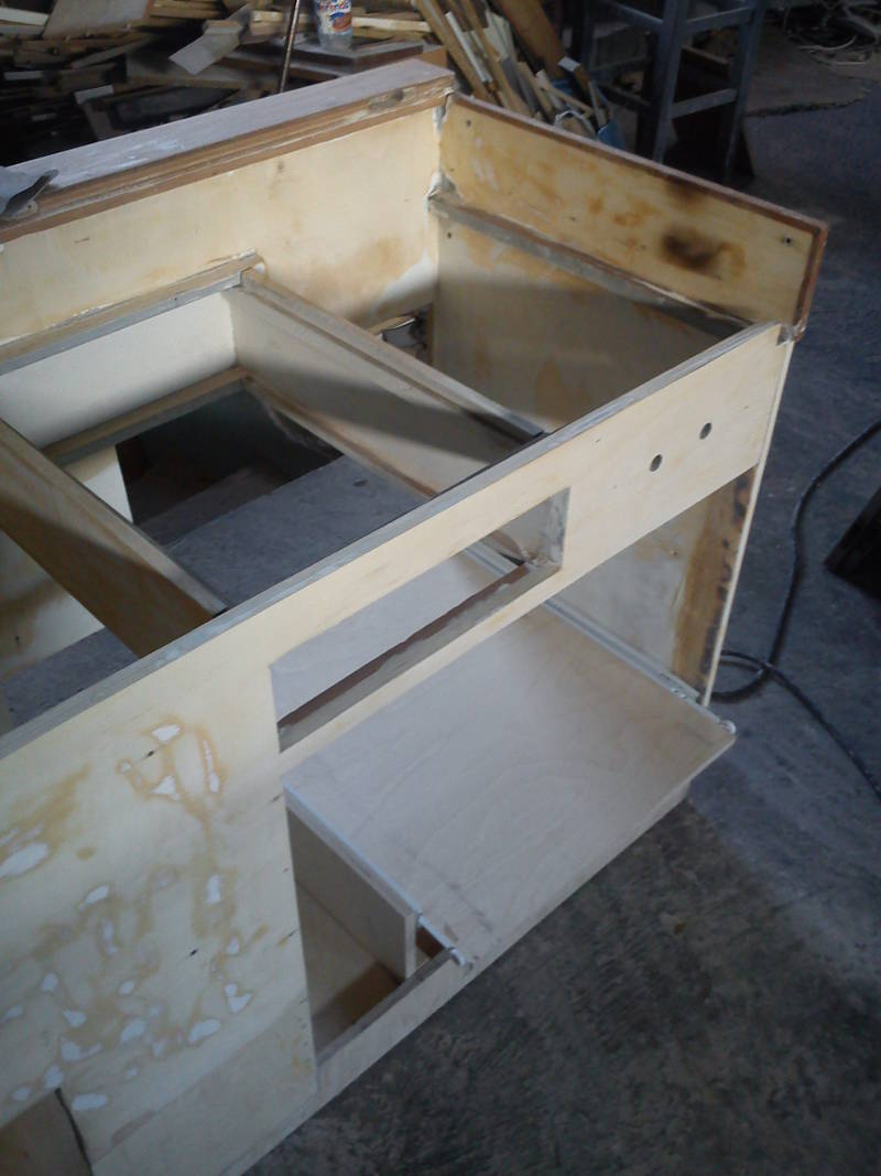

Drawers in the port cabin got the slanted ending for the sockets-I still cannot believe they had sockets placed horizontal, any liquid spill and you were in for some trouble or even fire!
cabinets got the first few coats of primer and are looking v.good:

Finally, happy to report the bow thruster tunnel work is almost over (as in fixed, epoxied, smoothed)
Here is the two 15mm layers of ply worked together to get the curvatures right. Haven't had so much fun with wood for decades! OK, I know I'm sad...
Port side epoxied and smoothed:
stbrd side see through the tunnel
bow view looks dead centre and symmetrical (ok, not only looks it is ;) )
Time is running out, planning and hoping to be back in the water before the end of July, so now prioretising jobs that need to be done outside, leaving a lot of upholstering and fitting to be done in the water.
cheers
V.

Now I understand the logic of why you did the tunnel that way...some things you just need to see complete to understand.

Annoying thing is it has no video in or out as I'd like to be able to wire a camera in the e/r or route the out
Rob all that sensor cabling is annoyingly complicated!
Do you mean you got the sensor and you could simply use different cables (selected at ordering time I guess) to connect it where you wish?
So any 20deg tilt sensor should fit?
V.
