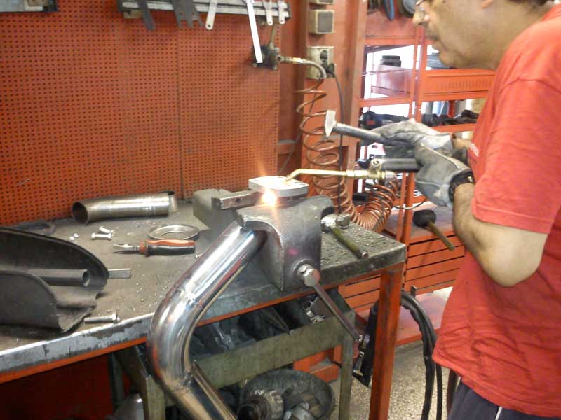

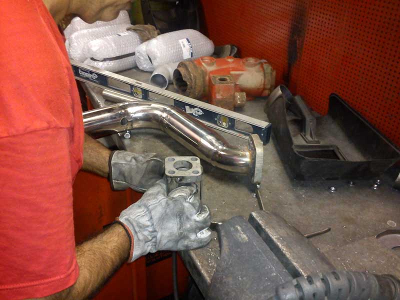

Panagiotis working on it on his workshop

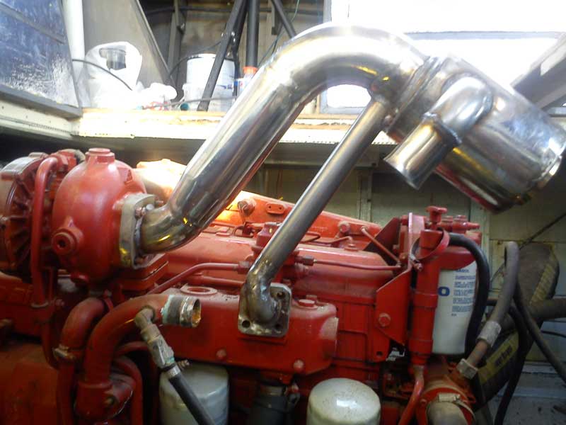

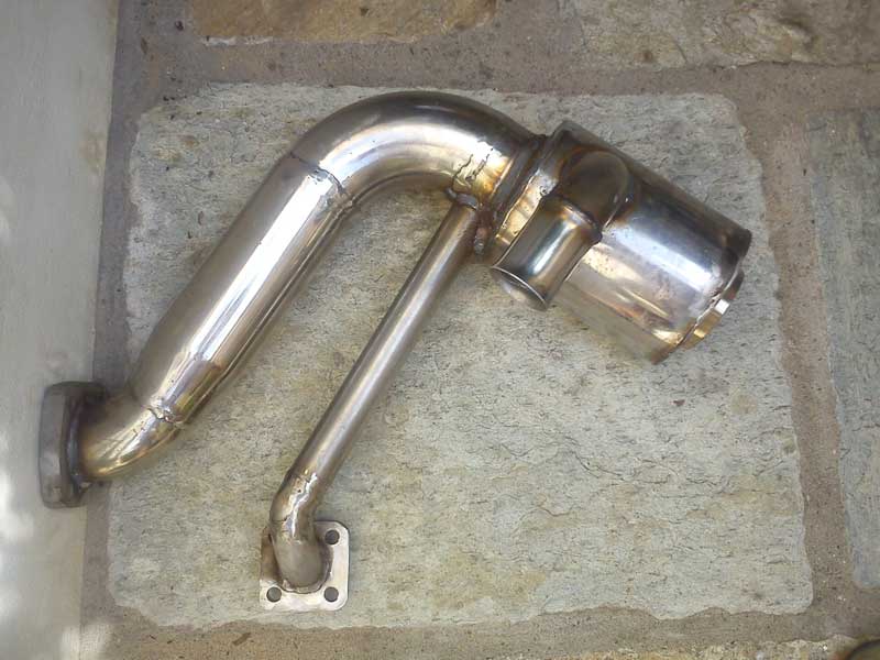

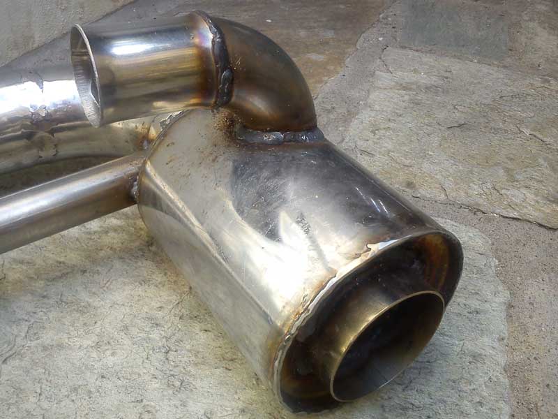

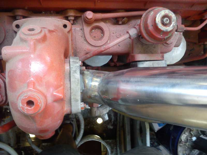

So this is the riser (roughly put together at places as it's going to go back to his workshop for final alterations and as a model for the second one)
Test fitting it with Piers, we discovered two problems:
It's too bloody high, I was afraid that would be the case, but really needs lowering 40mm as atm it's level with the bottom side of the 12mm salon flooring ply and that's NOT good.
the flange for the small pipe water intake (or outlet if you wish) is 5mm off in height and slightly at an angle to the block outlet. Clamped the two pipes together to get them at the right distance and marked the tilt, so the week after next when I'm back in Athens it can be corrected the the second one built. Will try and setup the jig more accurately next time round so we don't get such problems in fitting.
Got some new 45mm (ID) exhaust pipe for the genny that also fits to the big in/out for the seawater so I should be fine with it.

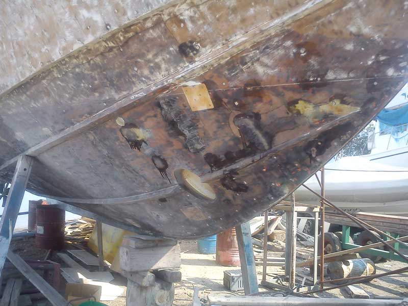

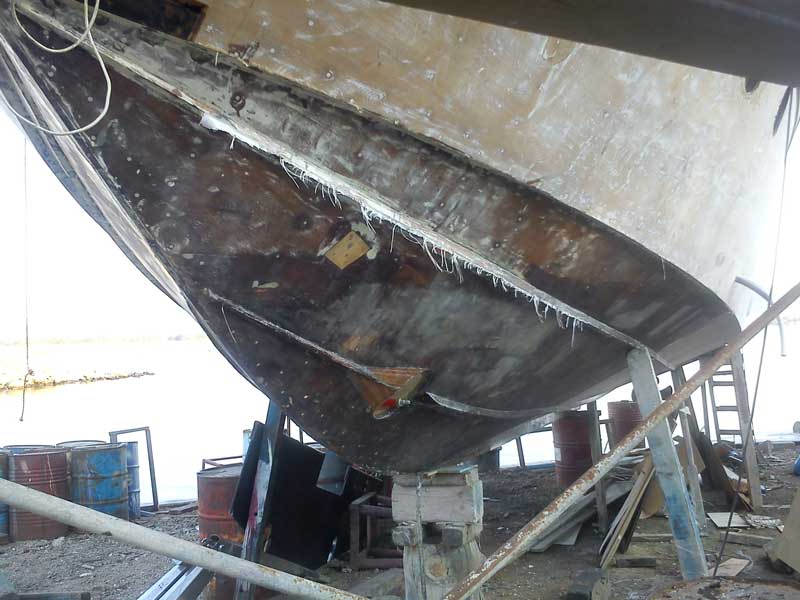

For the next couple of days the program has epoxying (with microfibres) of the damaged spots around the bow and below the w/l which are then going to be sanded (with a belt sander that Piers can use and I'm not happy to...) and prepared for the glass mat and epoxy that's going to follow next week.

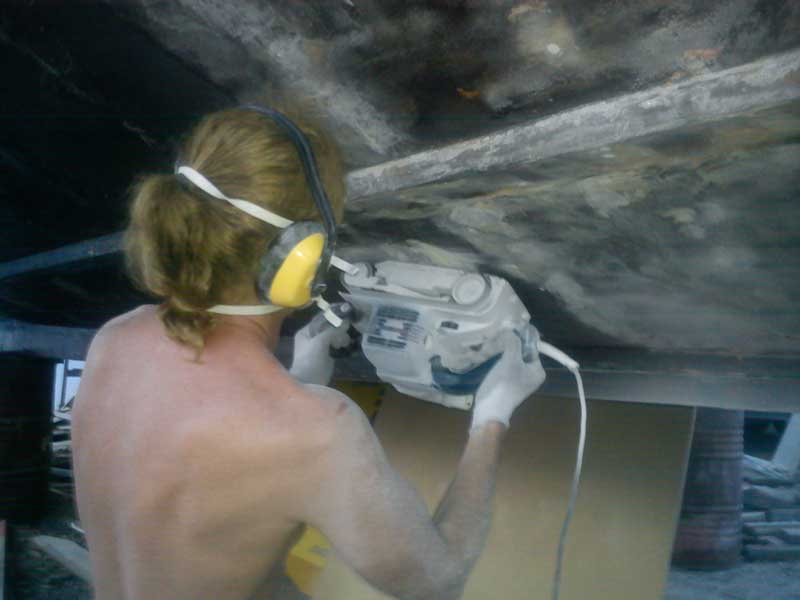

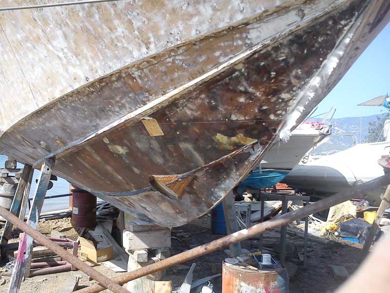

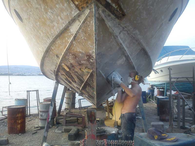

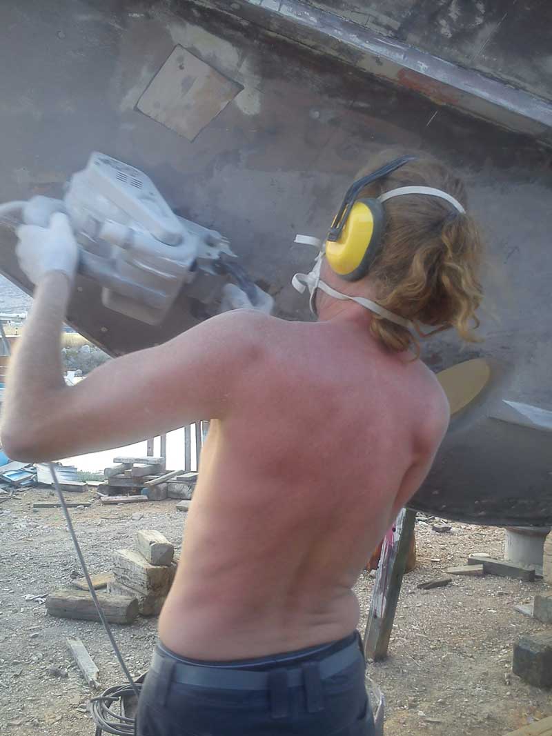

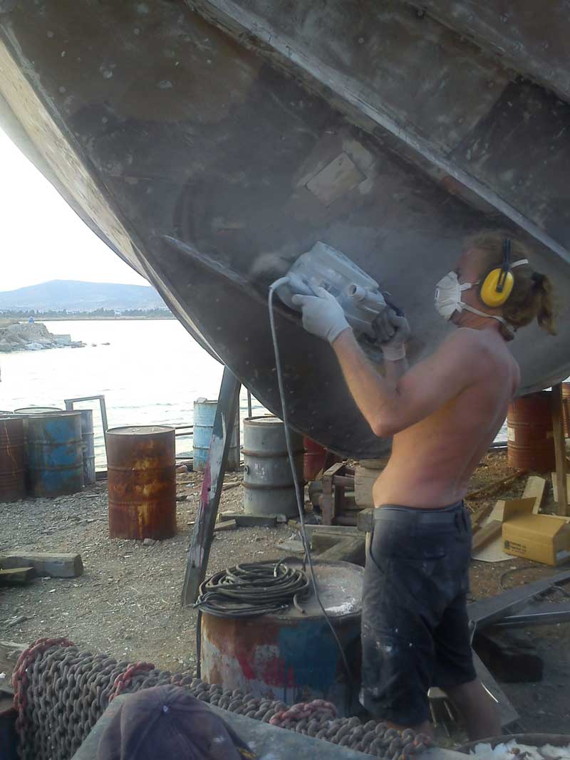

anyway Piers set off for the UK today, some pics of the progress done during the two days we worked together. Mind wouldn't have used the belt sander myself and would probably spent 4X the time...
Decided to sheath the bow up to the patch on port side and a tad further back on stbrd side with a 280g/m2 mat and epoxy. Will come back wth the techniques I'll use in a later post. So plan was that with Piers we'd sort out (as in filling with microfibre thickened epoxy and sanding) the bow section. We're very close to that, need a few hours of finishing touches with the orbital sander before proceeding with the mat:
working on the port side. Upside down and left to right, not the best combo to run a 4inch belt sander
The tan (?) in Piers' back is not my fault, it's Crete's sun talking :p

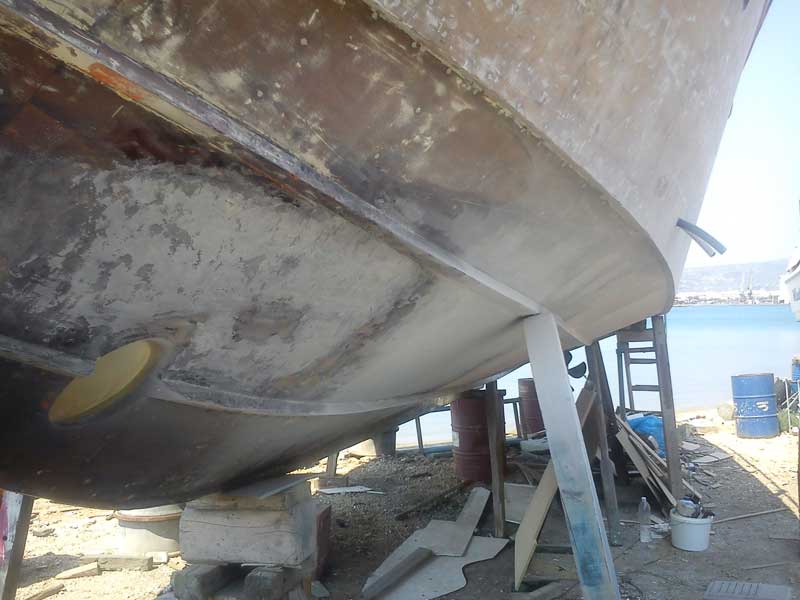

and on another difficult spot by the keel on the stbrd side:

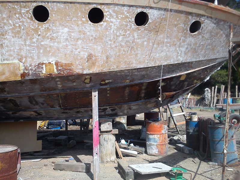

another installment after a 3day short break with lots of swimming and eating...

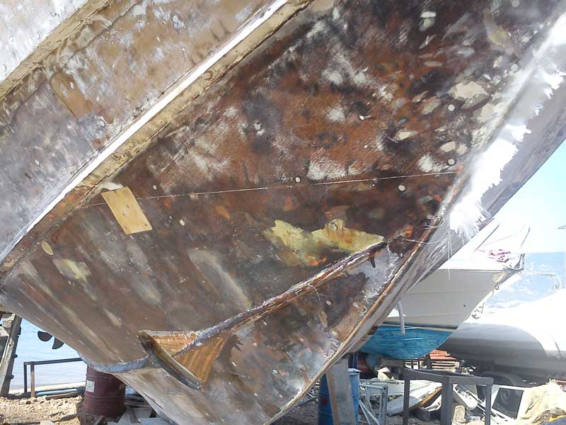

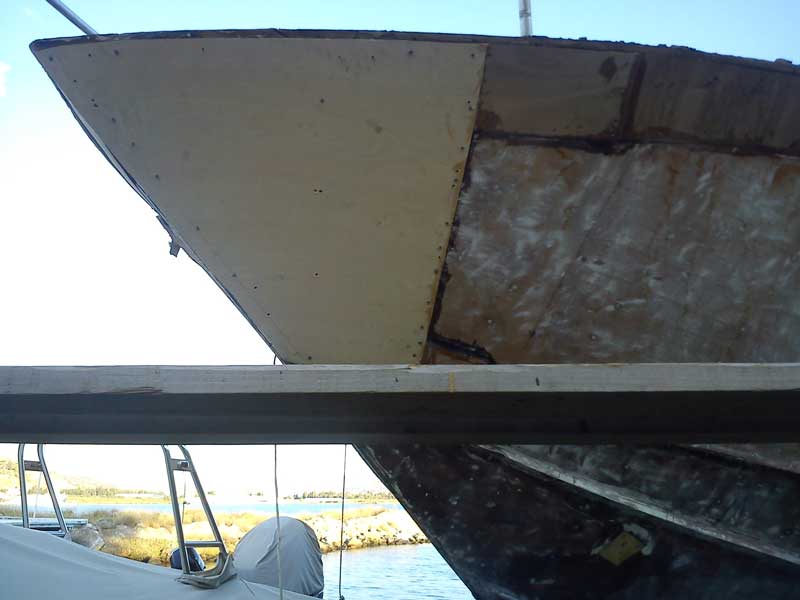

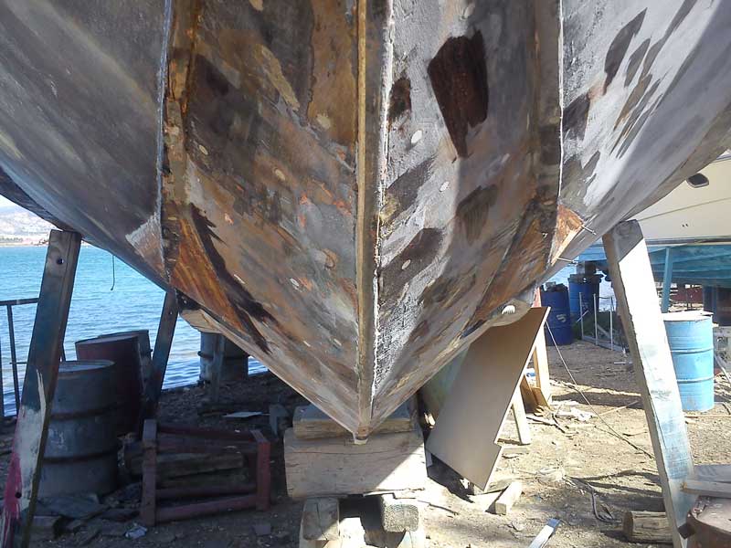

As I've said, I'll sheath the bow side of the hull with a 280g/m2 cloth and epoxy. Before doing that I had to finish all the smoothing/sanding/filling jobs on the bow, AND sort out the bulge on the bow side of the bowthruster tunnel. 19mm ply was enough, cut in shape:

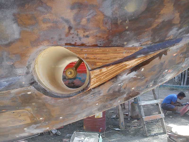

sanded in shape:
marked spot on the stbrd side:
epoxied in place:
port side in place:
bow views of finished article:

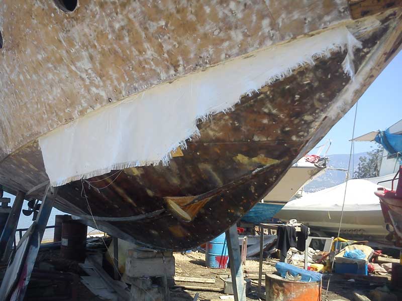

Once the mat is in place on both sides I'll do a bit more smoothing with thickened epoxy around the lips, but does look like it's going to decently deflect waters from the rear side of the tube.

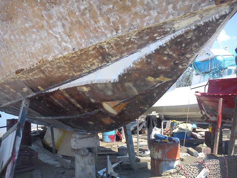

With the help of the son, I managed to get in place the first strip of mat and epoxied in place (as did epoxy some of my hair in torso, arm and head :rolleyes: It was too hot and took us more than expected so sun turned round and got us :(
All impressively well done, I have to admit I was afraid of this bit of work, but temp, humidity etc were all good. OK, it was hot, I was boiled by the sun but the usd slopping hull was in the shadow hence cool ;)
No air or dodgy spots, but I'll change my application method by stitching the mat in place loosely and not v.accurately flat and not with a fold on top (as I did) and to smaller areas in one go (did .6X4+m in my first attempt) Hopefully get this out of the way this week.
Will need another two coats of epoxy on top to get a reasonably smooth finish, plus some feathering in advance for the rear ending of the mat.

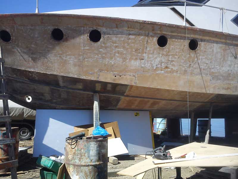

short update as I'm done with sheathing (sp?) on both sides and even did a bit of tidying up and sanding smoothing edges and removing staples etc this morning.
Since it was quite hot, I made the mistake to work with no t-shirt on and body itches badly as sanding mat+epoxy /= sanding epoxy! Bleeding tiny bits of glassfibre all over my body :(
Never again, should have the white overalls/hood on... and do a proper sauna :(

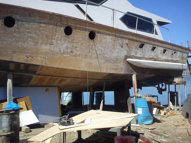

Anyway, plan for this coming week is to finish smoothing the glassed bit, and sand the bits I've filled in the rest of the hull. Should keep me busy for a few days :D

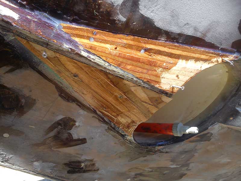

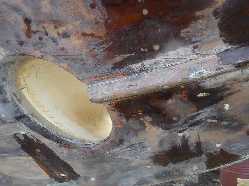

Two more coats of epoxy and then get the new grp skin fittings back in. Er, engine intakes are now 1 1/4 compared to bronze 1.5inch which means the hole must be reduced in size. Means scarf/patch/drill job.

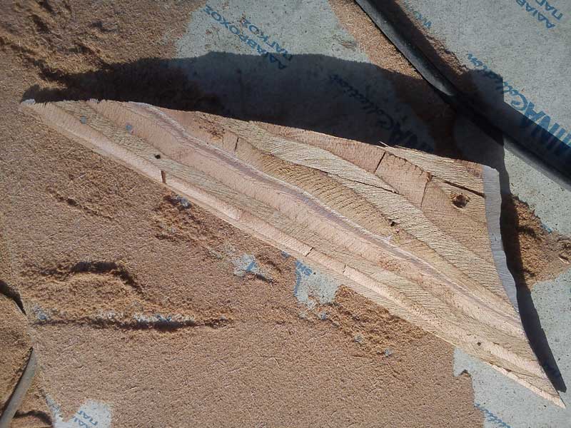

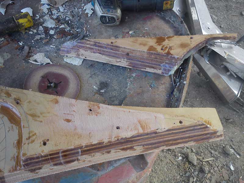

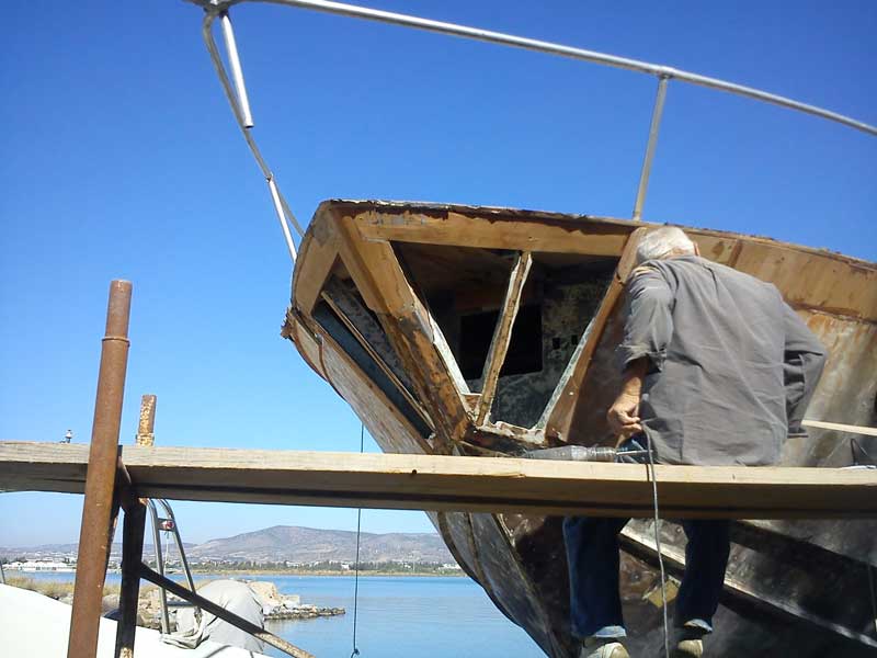

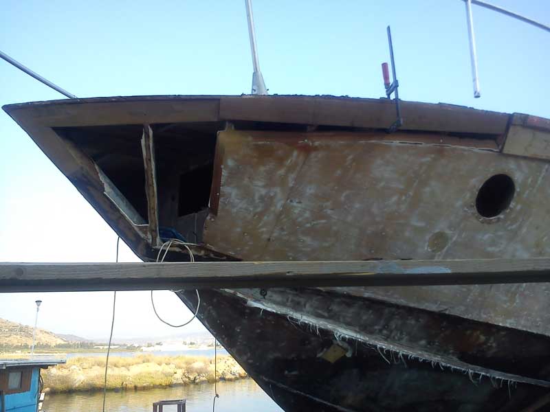

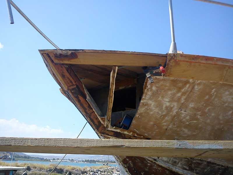

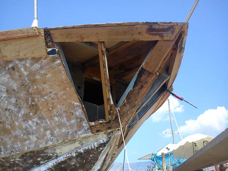

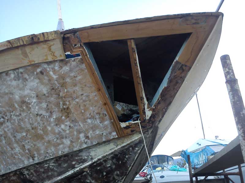

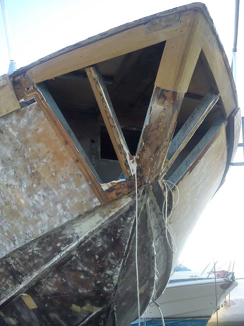

George in the meantime is busy repairing the bow tip from water ingress damage on the anchor locker area. ATM I have a very airy anchor locker as per the following pics.
Had to remove and replace the main iroco beams meeting the keel. Mind the keel was sound, just replaced the top bit and only down to 20mm depth.
Stbrd side replaced less than 1m:
On port again more extensive damage had to replace 2+m:
stbrd side ready and sanded down to the right lines waiting for plywood skin:
