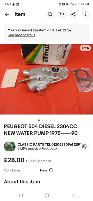

Screenshot_20240218_084026_eBay.jpgthis is the pump I ordered, I have found impellers separately but they are approx €65 + postage from a French supplier, bearings seem to be a issue aswell and I'm also struggling to get someone to put the spline for the impeller onto a new shaft, regarding bearings I may have my shaft turned down slightly to allow for a wider range of bearing , also I intend to modify the housing to allow for a removable greese fitting into the weep hole to help prolong the life of the bearings , be interesting to hear how you get on , there's a company in Devon who offer a rebuild £300 ish but won't supply the parts separately so there must be a way to get these parts in a coat effective manner

View attachment 172538this is the pump I ordered, I have found impellers separately but they are approx €65 + postage from a French supplier, bearings seem to be a issue aswell and I'm also struggling to get someone to put the spline for the impeller onto a new shaft, regarding bearings I may have my shaft turned down slightly to allow for a wider range of bearing , also I intend to modify the housing to allow for a removable greese fitting into the weep hole to help prolong the life of the bearings , be interesting to hear how you get on , there's a company in Devon who offer a rebuild £300 ish but won't supply the parts separately so there must be a way to get these parts in a coat effective manner
https://www.serie04.com/fr/504-refr...au.html?search_query=Pompe+deleau&results=211
These are the guys who have many internals for the engine from.
It looks like this is the pump you have, I think the circlips at 35mm are too small so there must be another pump with maybe 42mm clips..
I saw one for a 403 which has a 15mm shaft and I think 42mm circlips. But this pump was e299 from these guys. I wonder if this the correct doner pump...(at 299 I am not going experimenting)
I hope to get to the bearing suppliers during the week and will see if they can get the replacement bearings. The numbering on mine is clear and they look like a make I recognize. (I need to get the magnifier to read them)

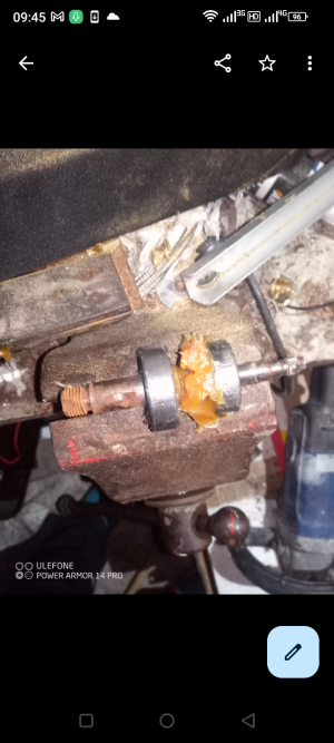

Ok I wasted my money on the bearings...today I bought two of these pumps for 35euros...
POMPA ACQUA PEUGEOT 404 1600 GT DISPONIBILE QH 170666 CASSA 149/A - Fabio Izzo Autoricambi
They are Quinton hazel 170666.
That are listed for 404 engines. Although I bought it from a guy who had it advertised for a 504.
The shaft and bearings and the impeller appear functionally identical to the original Volvo. The impeller is a little different in design but I suspect will be fine.
I had to destroy one impeller to get the shaft out intact.
My Volvo pump is pretty much together now, except I am thinking whether to press on my old impeller or use the one from the second pump.
The front of the shaft may be a little shorter but there is ample for smaller nylok nut. the face on the pulley could be reduced to expose a few more mms of thread.
BTW The shaft between the bearings was covered in a huge lump of grease on it.
My photos are too big to upload.
Thanks to Mr Cox for the tip, here's a screenshot of the QH shaft with bearings and grease...
