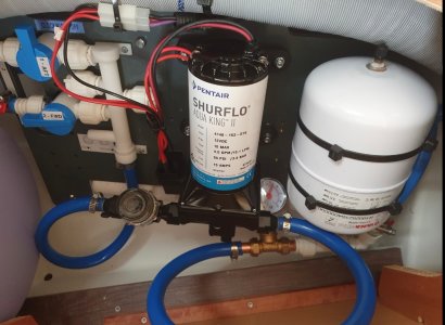

To round this off, Lee San sent out the replacement pump next day delivery.
It's now fitted with diodes across the relay and motor coils and works perfectly. I put a pressure gauge inline and was seeing 53psi/3.7 bar pressure in the water pipes.
Note the flexi loops I fitted when I first replaced the Par Max pump. This is recommended by the pump maker but not followed by Jabsco when they make that loaded backboard for the AWB factories.
That, and the quiet running pump made a huge difference to noise levels, now it's just a quiet hum.
Very nice looking installation. I especially like the jumbo expansion tank.
