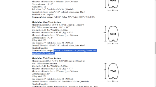

I have just looked at an American site and an approximation gives about 4.6 kg per metre for the bare extrusion c55kg for the bare mast without fittings.

I think a lot on this thread are wildly wrong.
I'd guess the extrusion around 5kg per metre.
For sure, the odds and ends add up!
