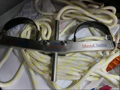

And, on a slightly different tack, I'll just pop this pic on here. Just to initiate some comment, informed or not:
Those aren't jumars, that's a via ferret lanyard which is not for climbing rope.
