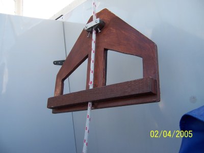

I made my own mast climber yeas ago. Makes going up easy, though I do prefer someone to tail the rope for the seat and to then let me down. It's had plenty of use over the years. The cam cleats are bolted through and the back of the climber has some rubber and bits of soft wood to stop the nuts from damaging the mast.
