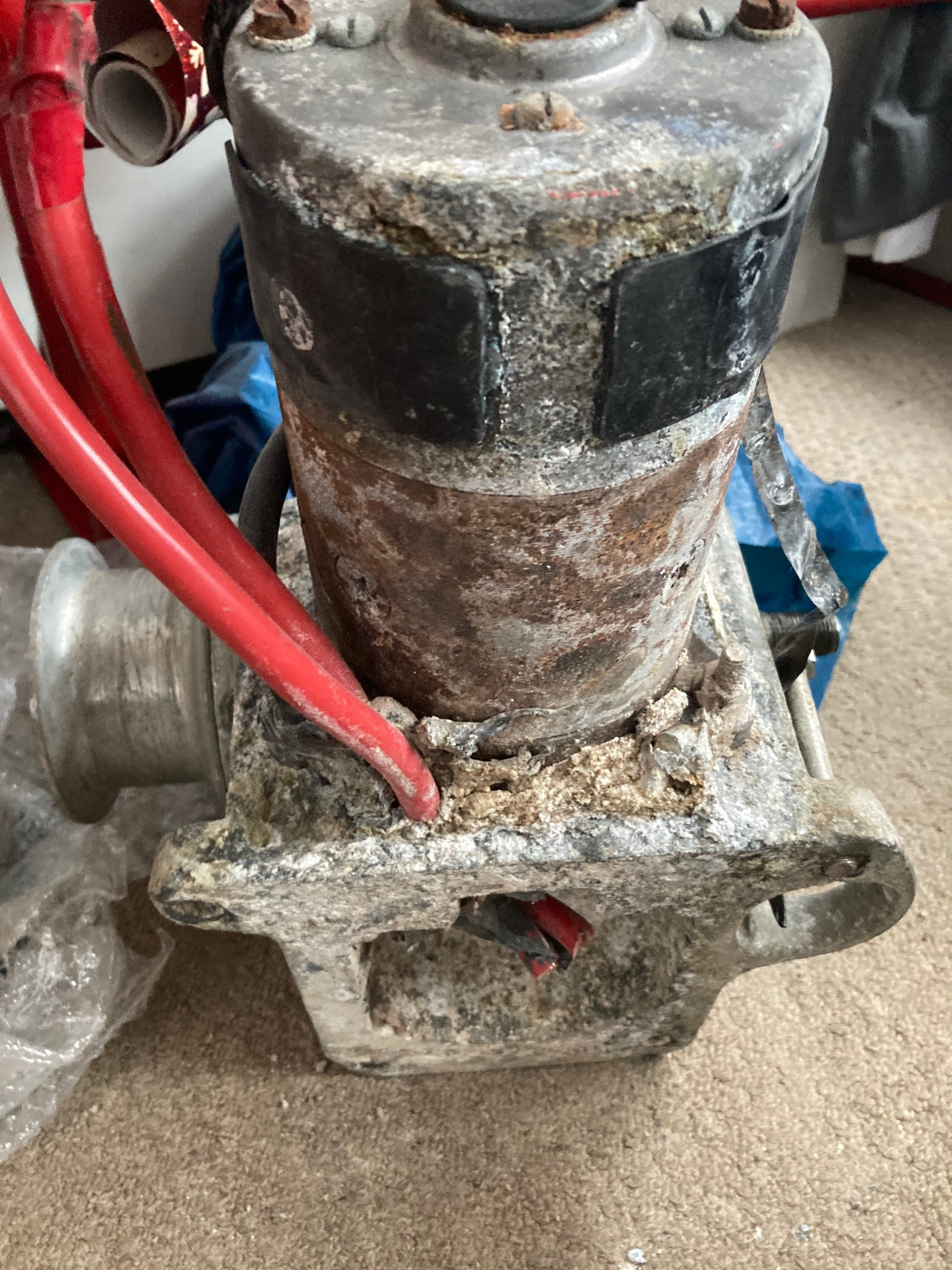

With the 10% offs currently across some of the big chandleries' websites, I've just realised that I can save a fair bit on a replacement for our very knackered Tigres:
Badly corroded casing (not just the back, which is beyond repair, but also the 'body')
This isn't just 'crusty'(!), there's a lit one hole in the casting (although it doesn't appear to go through into/inside the 'gearbox' (yet!):
Motor shows no signs of life when hooked up to a battery and given a few good 'taps' with a hammer - suspect it needs a re-wind or at least some replacement innards (or a new replacement @ £393)
And while the windlass isn't seized, the manual drum is very stiff. The whole thing needs a strip down and rebuild. There's no oil in it! And ponder at the state of the parts I'd need to remove! I have a MAPP torch, impact drivers, and some patience to use them(!), but reckon it'll fight me all the way. The corrosion (or freezing?) seems to have warped this access plate (it bulges out between each fastener!).
So the question is - having never been suckered 'Black Friday' before! - but should I just stump for a new one? We know that these sort of things rarely get reduced that much below their RRP. Yet the cheapest I can find now is £944 (with other retailing still for >£1200).
I had been planning to strip it down and attempt to rebuild it of course, but for this I was budgeting for some specialist alloy welding, loads of spares from Lofrans, and potentially the motor rewinding (I know good local places so wasn't expecting to plump £400 for the new one - but it remains a worst case possibility). Suspect I wouldn't get change from £300 just for the parts and labour I cannot do myself (welding). I could probably get at least a hundred quid for this one as spares.
There are a million other jobs/projects on the boat which will stop us launching in the spring if I don't get around to them, so not having to rebuild a very used/abused windlass wasn't something I was relishing! But then again, this is PBO and money remains tight in our refit project. So do I just buy a new one, face the wrath of SWMBO, and cherish it forever so it doesn't end up like this??!
No brainer. Get a new one.
If the gear box on your old one isn’t seized then someone will buy it for spares for theirs, so you can allay your conscience by remembering that you’re recycling it.

I picked up a boxed brand new one for 400 quid from ebay five years ago.
My old one which needed the motor only replacing made nearly 200 quid on ebay after a clean up.
IIRC, a motor for repair was more than the one I was fortunate to find.
Your one really is Donald Ducked!

Wow now that is a bargain that I could probably even earn extra brownie points for at home! But I have watched eBay pretty closely for a few months and nothing suitable has come up.
I have repaired some pretty knackered junk in my time, but I knew I was pushing my luck contemplating bringing this back from the dead! Problem with things like this - where parts are all available - is once you commit to a rebuild, before you know it the parts spend is approaching the margins that would justify a brand new one.
I'm looking forward to the challenge of keeping its replacement in a far, far better state of repair than this sorry old lump! That said, as a testament to Lofrans, the mechanism inside operates surprisingly smoothly (I guess boosting my chances of selling it on for spares ?)

And another for replace, although I replaced and then fixed up the old one, selling for barely more than I had just spent on parts. For example, new brushes are extortionate. A local company made some for me for £109 delivered which was about half the price of the Lofrans ones IIRC. Motor casing was stripped out, chipped back to bare metal, presented to the dishwasher and then painted and re-built. The top rack of the dishwasher still has black oil staining!
All helping to reinforce the replace decision.

Yup I've had similar experiences with things like outboard parts - they're hardly cheap individually, but once you've got a 'rebuild' list it quickly mounts into the many-hundreds!
I've got no plans to refurb the current unit to sell on. It's destined for eBay 'sold as seen'. Most broken junk on our boat attests to a life of relatively light use, but lighter-still care and maintenance! So I suspect the innards will be usable for someone, rather than all bent out or too worn.
The new one is ordered. And as a bonus we'll have a spare control box! Thanks for the input. The urge to tear things apart and recommission them always runs strong, but right now if it doesn't affect our ability to float it really shouldn't be on the jobs list!
