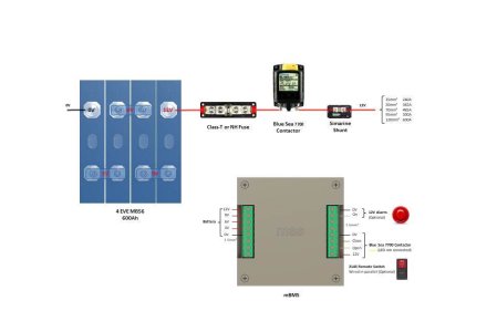

I agree with keeping things simple. Here’s the complete wiring diagram for our house battery system. And since the battery easily powers a bowthruster, windlasses etc., boat wiring is also kept simple. A separate lead acid battery starts the engine, but the house battery could do this if it was ever needed.
