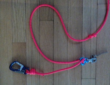

Easy answer, adjustable length tether.
I have made this type, I found the lazy part of the tether gets in the way while crawling on deck so I eventually fitted it fixed to the mast: it is quite useful as my mainsail headboard is very high, I lengthen it when in need to work with the sail/halyard (in which case I have to unclip from the "regular" tether) , shorten it when it's winching at the mast base.
Kong "Slyde" plate, + Tango hook, 9mm climbing rope (I found that regular sailing rope diameters 8mm and 10mm do not work well)
